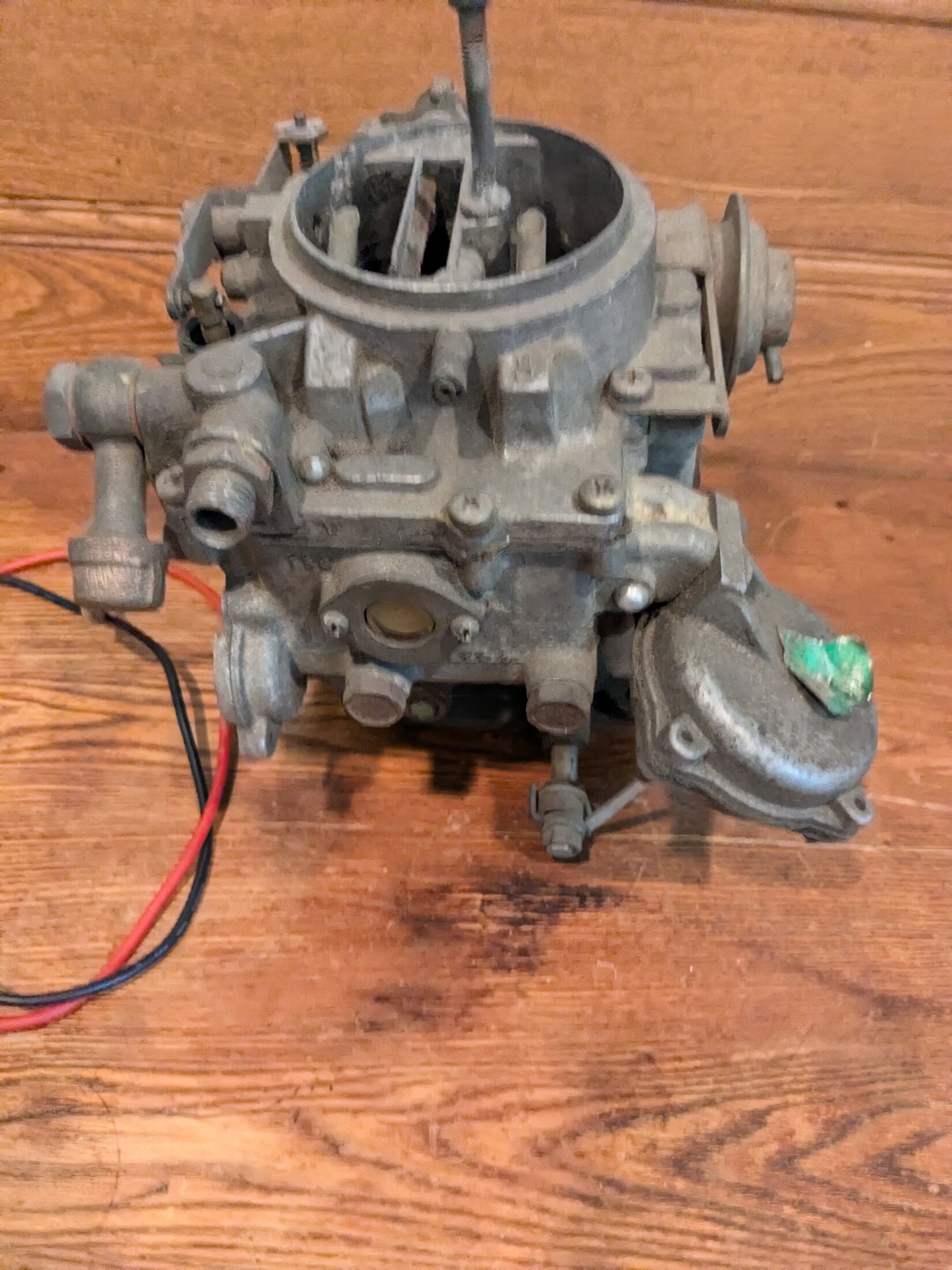

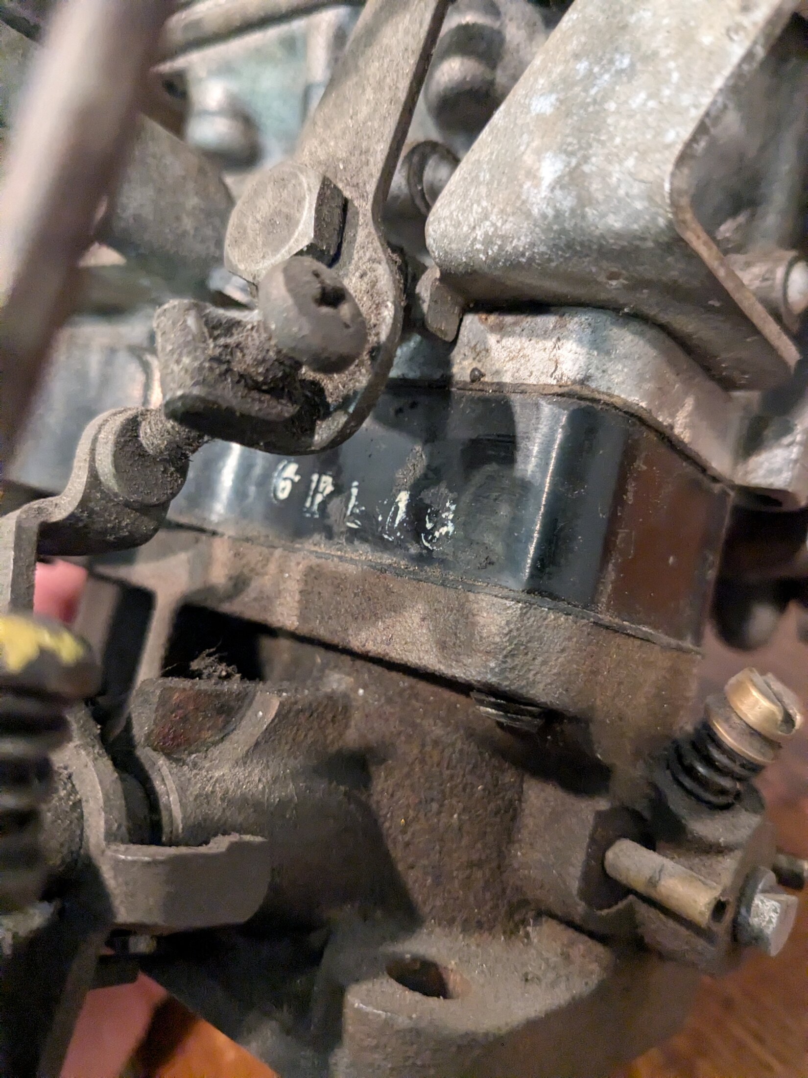

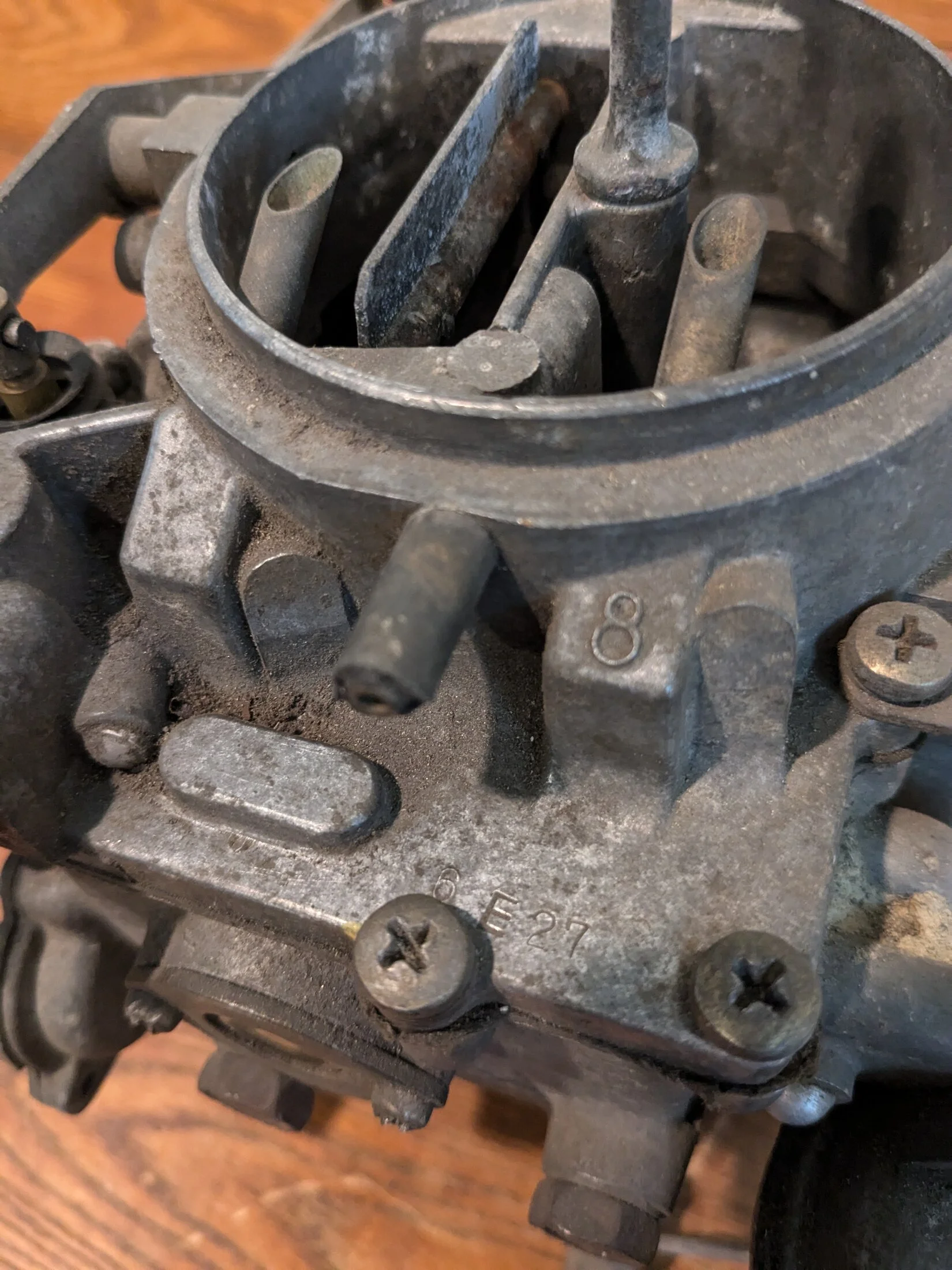

What year original Aisan? there's a date code stamped on it. If it's the '74 I would make every effort to make it work.
Based on this:
Looks to be May 27, 1976 (6 E 27). Still worth it?
A mechanical fuel pump rebuild is pretty easy to do. I think citiracer has a kit or SOR and not very expensive. A mechanical pump runs at the speed of the engine as it’s driven from the cam. Once rebuilt will last a long time.
Based on this:
Oooh, that does look rough. Seems to have been last serviced by a knuckle-dragger with the wrong screwdriver and fittings from Ace hardware. And it's a vacuum-operated secondary.
Personally, I prefer the mechanically operated secondary.
That one may be of use to someone here on 'Mud, someone is always looking for a spare or spares. Perhaps it could be made serviceable but would probably require a Guru.
