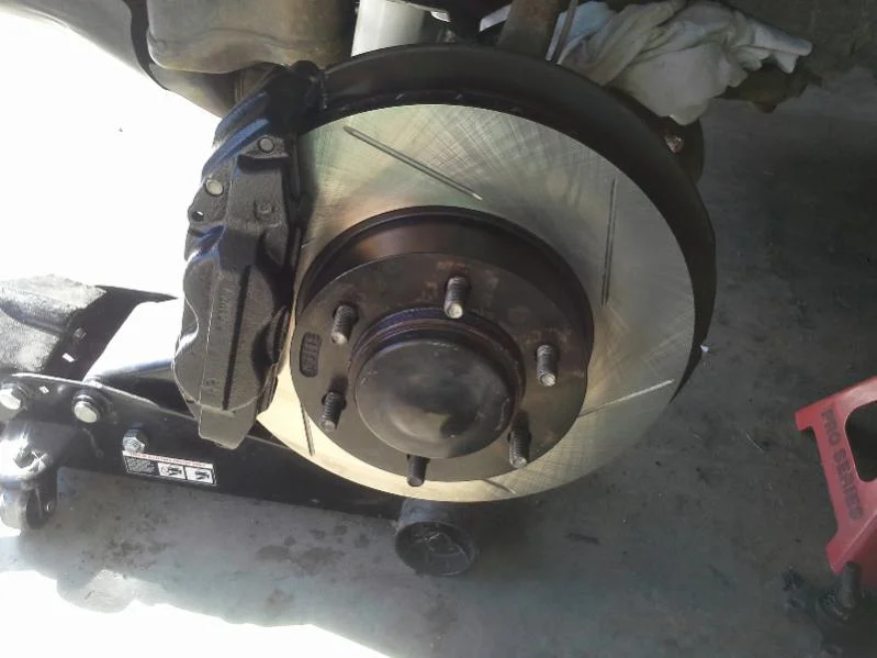

Saturday I will be doing the Tundra brake upgrade. 2005 parts, NAPA reman'd 13WL calipers, ceramic pads and stoptech slotted sport rotors.
Weather is warming up so I guess it's time to get some of these parts I've been collecting put where they belong. May go ahead and reboot the passenger side CV and replace the LBJ while I am at it.
Stay tuned....
Drivers side done.
New tundra rotors, ceramic pads, 231mm calipers. I also put in my highlander coils and replaced the soft line, also installed new LBJ while I was in there. Got the PS torn down, but gonna reboot the CV and got skunked by the hub nut. The one odd ball size I don't have. Headed to the parts store after supper.

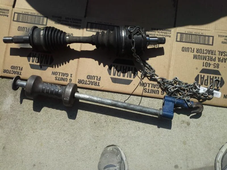

Not sure who decided the CV "should" come out using a pry bar on the flats, but it took me a double loop of heavy wire, a length of chain and a 15# slide hammer to get that biatch out.
More pics on the real camera, but to summarize the weekends activities:
Replaced DS and PS LBJ
Replaced DS and PS soft brake lines
New tundra 231mm calipers, slotted stoptech rotors, ceramic pads.
Installed used highlander coils (got about 1" from them, 21" wheel to fender both sides)
Rebooted PS CV and replaced the oil seal in the axle.
As per my usual, if it could go wrong it did and I am going to have to replace the PS bleeder screw because it was rounding and it got the visegrip treatment... also think I will be replacing the caliper hard lines as soon as I can get them.

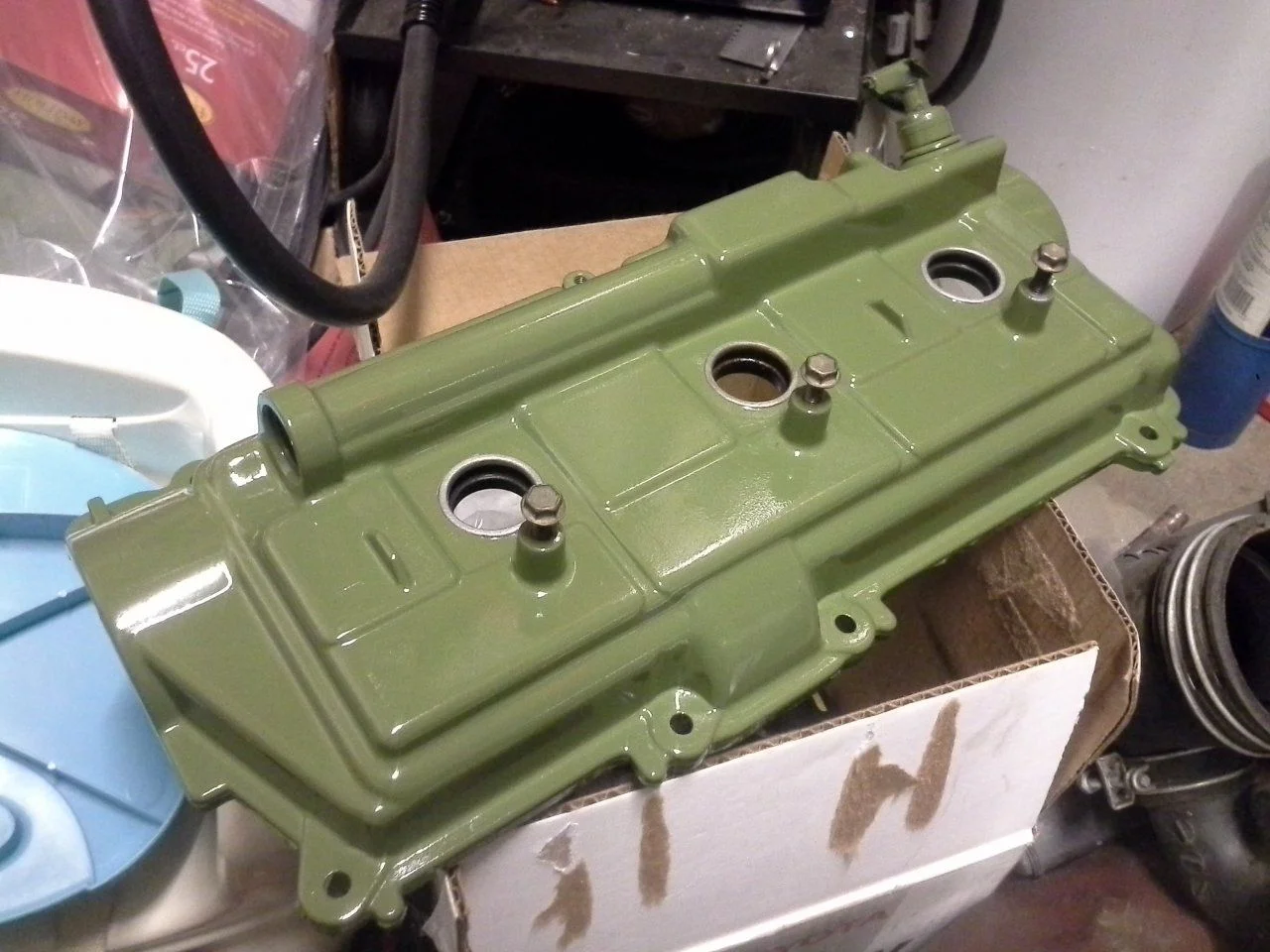

Well, I started my timing belt last sunday with no intention of doing my valve cover gaskets right now. Well my new crank seal was buggered up so decided to dive in. After some cleaning I scrounged around and found some paint from the spray bomb job on the sami and thought, Army Green, sure why not.
So now I am waiting on my new crank seal and a few other little things to finish everything up. I also have taken this time to clean out the parts pile. New radiator, BnM trans cooler, Airaid intake tube, plugs, wires and wiring up my light bar. I hope to get everything back together this weekend. More pics later. Honestly I just hope I can get it all back together and make it go vroom again.

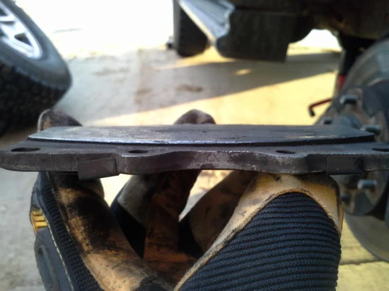

Hey folks, little free advice: Make checking your caliper bolts part of your regular maintenance. I went to back out of the drive way last night and the front passenger caliper seemed to be dragging. pulled in and parked for the night. Got out this morning and tried again, same thing. Took it down the road for some hard forward braking tests, no issues. I was gonna dig into the rears tonight since after I pulled both tires I couldn't see anything visually wrong. Had a buddy tell me about loosing a caliper bolt once while telling him about my woes, so I go out and check and low and behold the lower caliper bolt on the passenger side was gone. The caliper was fine while moving forward because it was pulling inward, but in reverse it was pulling out until it contacted the wheel then it would just slide inside the wheel. After I pulled the wheel the second time I noticed the drag lines inside the wheel :doh:
Long story short, I robbed one off the 80 sitting next to it and called Mr. Stewart for some new ones... Blue loctite will be going on all 4 of those beauties.

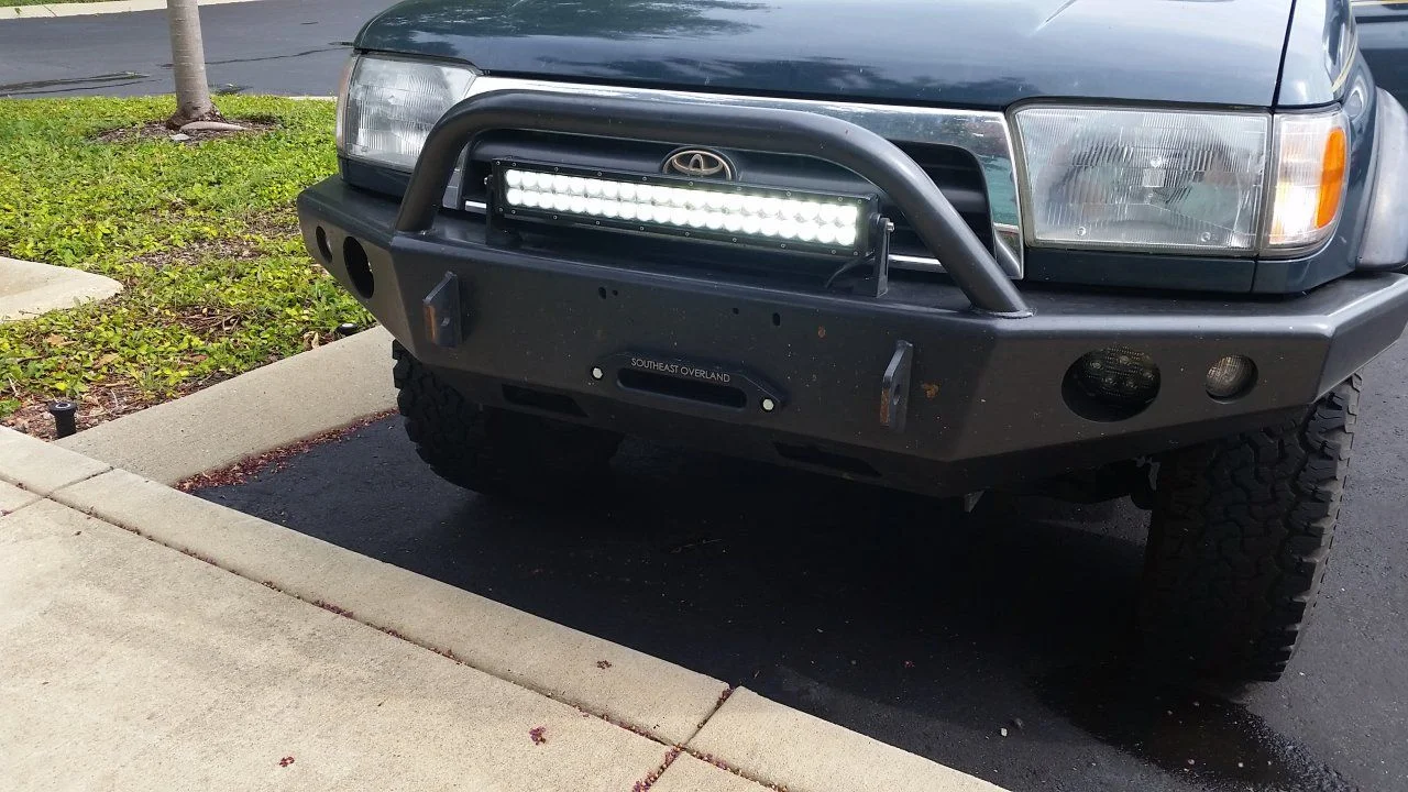

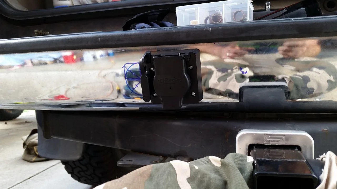

Finally got around to remounting my LED bar after I finished my timing belt a few months ago. So after I got it bolted on I decided to go ahead and wire it up. After a bit of an education in switches and wiring, and a call to a buddy, we have light.
Will have to wait a couple days to get a few good shots of all my lights on. I also have some wiring to clean up since I also have to get a brake controller wired up to this 7 pin plug.
Gonna have to finally break down and figure out how to mount my blue sea fuse block I reckon. That would let me mount several other electrical goodies.
