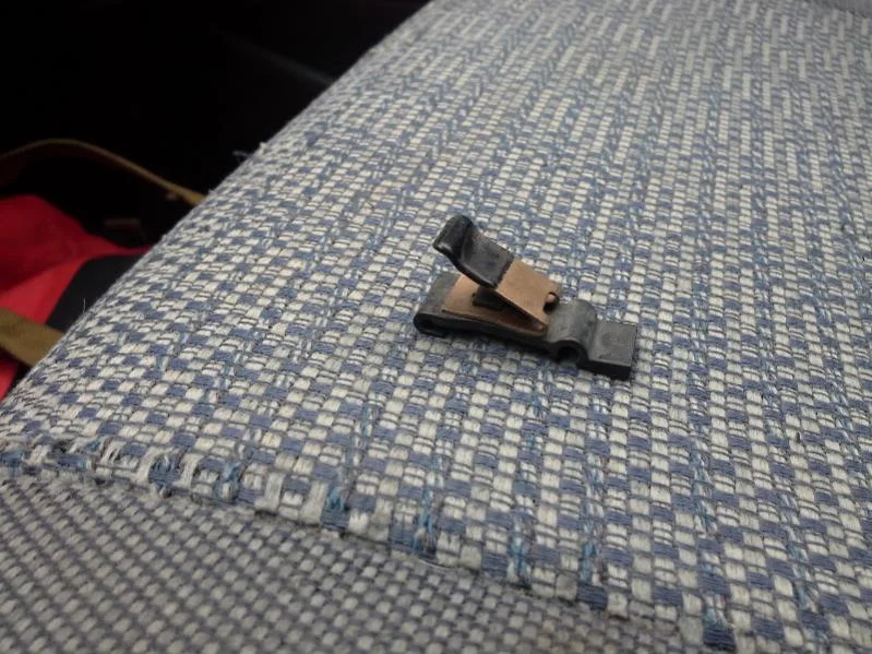

I also picked this up to fix my gas door.

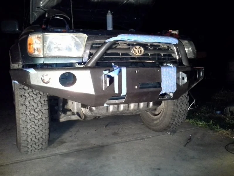

Lol, thanks. And I know I have been slacking, but I am trying to get back on track. I ordered a couple of 4" (actually 4.5") round LED's to go in the bumper. I am going to have to do a little modifying to get them to fit in the Shrockworks bumper, but I don't think it will take much. I bolted my LED Bar onto it last night and I found all my plugs from Nick to wire everything up.
So the plan for tomorrow is to get the frame end's boxed with the supplied pieces and then I will need to modify the original light mount to work with the round LED. The bumper is made to fit the PIAA 510 and the round LED's mount a little taller so I need to put a slight angle on the mount in order to get them to line up with the holes properly.
Hopefully tomorrow will end with some pictures of a nice bumper bolted up to the front of the 4Runner :cool:
Stay Tuned:popcorn:
Well I am not at all happy with the fitment issues and I am going to have ALOT of paint to touch-up, but it is on.... mostly.
I still have to get most of the hardware on and wire everything and adjust the final height and.... well lets just say I think I have gotten the hardest part out of the way.
Got the height adjusted and lights mounted. Still have some wiring and bolt tightening to do, but I am please overall with the days work.

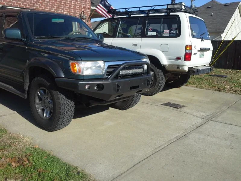

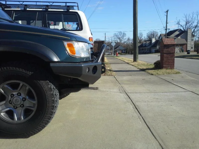

Finally got some sun today a grabbed a couple pics with my phone.
Still need to wire up the big bar but overall pretty pleased. Front didn't settle as much as I had figured, but I have heard a little rub on the front passenger so next on the list is my Highlander coils and toytec spacers.
Bumper looks good man, now start on that grill I'm waiting to see what you come up with.
