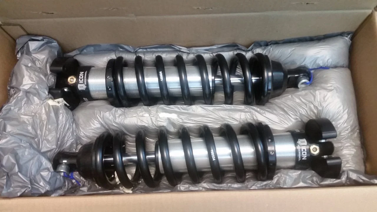

Introducing my 98 4Runner DD.
Well it's been awhile since I actually posted any pictures, so I will just leave this here.
Rear shocks should be here tomorrow.
@BMThiker I thank/blame you for this... :p
I would love to put those on our 3rd Gen too. I think Dugan put stock FJC struts on ours. Not sure what we have on the rear. Ride height is good, but it's stiffer than I like for a DD.
Well they look really cool anyway, can't wait to see you get it all together

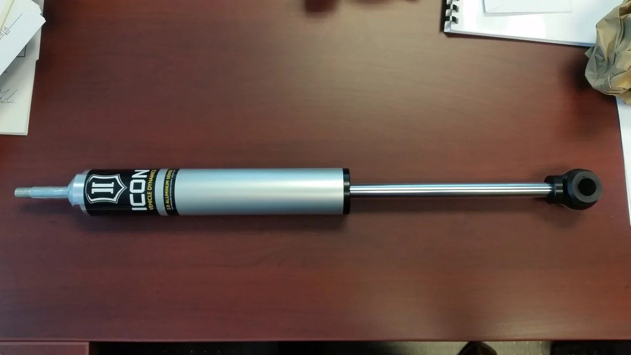

Rears came yesterday while I was out of the office, they were waiting for me when I got here this morning.

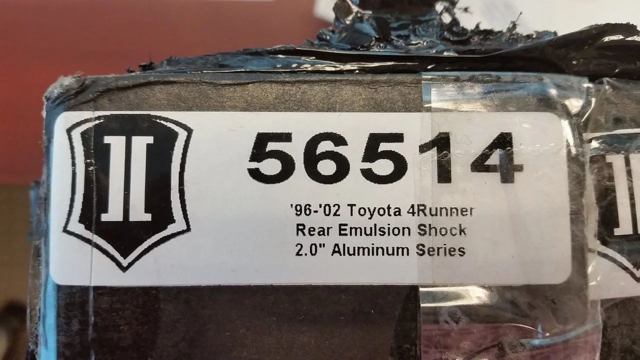

And for those interested, here is the part number for these newly released 3rd gen specific 2.0 rears.

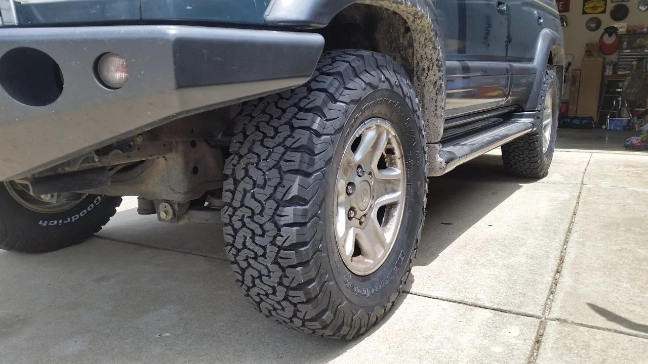

I like the stance of the 4Runner, do you have any idea about how much lift it actually has? And what size tires are you guys running on it?

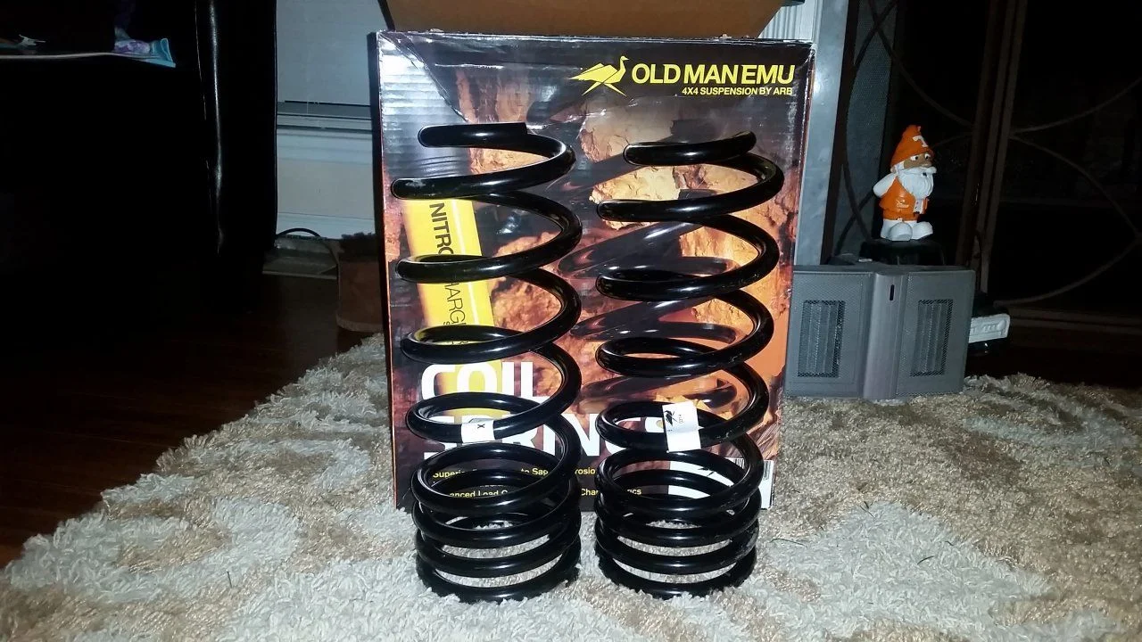

Thanks to @Southeast Overland I got my set of OME 906 rear springs today.
Last piece of the suspension puzzle. Now to start putting the spray on the rear shock bolts, sway bar end links, etc on the rearend and get a free weekend to put it all together.

@BMThiker do you run the shin guards on your rear shocks? Just wondering if I should pick up some to protect the shafts.
Anyone else running them? Thoughts on their need.
And by shin guards I mean those rock guards that bolt to the axle mount to protect the shafts from rocks.
I made some skids to protect the bottom of my shocks, but nothing else
Is the body up or down? On the ones I gots the shafts are down, so more exposed to things thrown by the front tires. You got me thinking, couldn't be too hard to make something to serve the purpose.... :hmm:
My billies are shaft down as well, I'd post pics of what I did but I don't have anyway to do it at the moment lol.
No worries. You noticed any issues with damage to the shafts from rocks or other things?
I have the plastic boots over the shafts and they have took a beating, but the shafts are fine.
I've never run armor on the rear shocks (Icons, shaft down). The bolt heads take a beating, but shin guards wouldn't help that.
That's more what I built to protect, just a skid for the lower shock eye and bolt :-)
Thanks Jeff. @Southeast Overland do you know if Steve runs the shin guards out back on the shop truck?
I (Steve) do run the Icon Shin Guards on the shop FJ.
Wow, long time no update, but nothing of note has happened in the last 6 months other than lots of miles on the road. With all the barn work, packing, moving, cleaning.... you get the idea, I haven't been able to do much other than change the oil, put gas in and drive it. Well in a couple weeks that should all be done and hopefully I can get that ICON setup installed and some of the other goodies sorted. On Saturday I am having a set of KO2's installed. Sticking with the 265/75R16s and I stayed with the BFG cause I do a lot of road miles and the current set has done me well. If I get 70k out of the next set I will be pleased as punch, I could probably have gotten 80k if I had kept them rotated better, but I should get a couple of decent spares out of the ones on the rear.

I am also contemplating a shallow drawer build for the rear to carry my tools and stuff, but keep most of the height. The OME springs need a little weight on them from what I read. When I finally get those in then I can sort that out.
