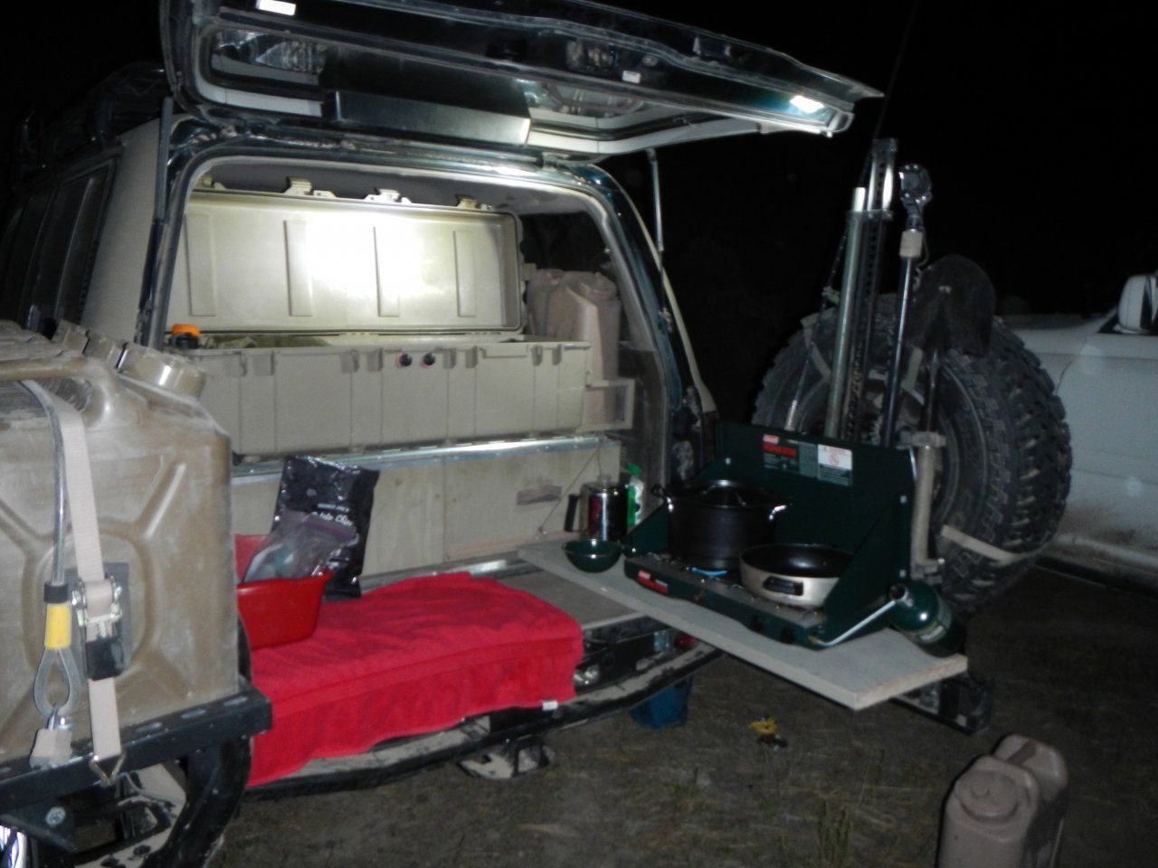

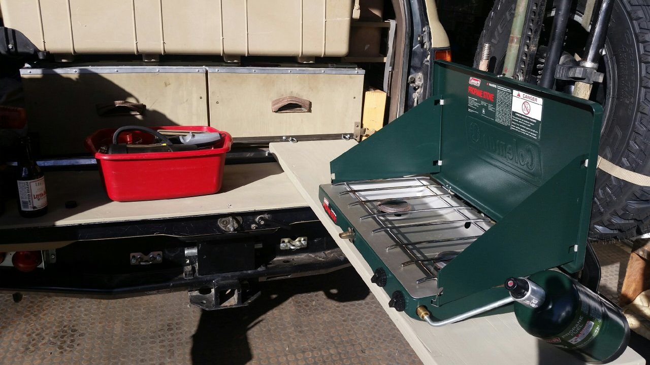

Replaced my Hella worklights with some LEDs, and added a small table to the drawer set up which helped our kitchen space nicely.
The Cooper S/T Maxx in 255/85 replaced the BFG KM2s and they are fantastic. Quiet on the highway, great traction offroad (I aired down to 20 psi this trip).
Sorry. Attached are some pix of the table. Cut it the length of the tailgate. Mounted a piece of 1" angle aluminum on the box drawer with two holes for pins to secure the table when mounted.

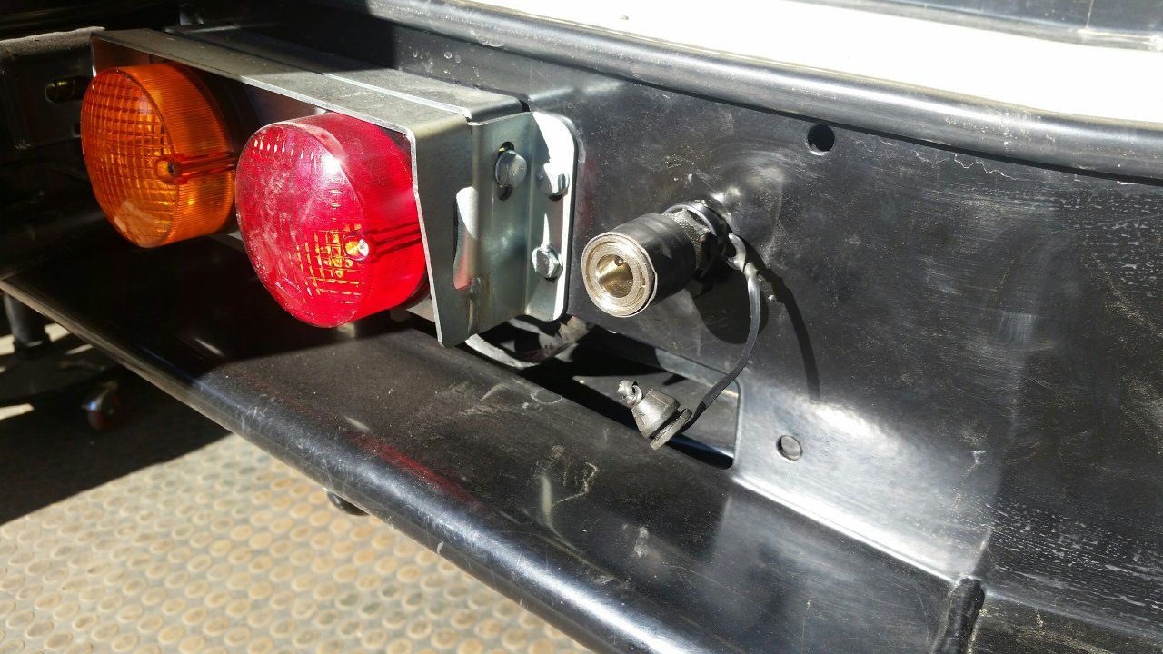

The one issue I was still facing was trying to re-inflate tires in a more rapid fashion in between trails. I could have purchased the VIAIR kit, but instead pieced together my own, which fits great in the space where my spare used to live.
I used the Viair 400C compressor and initially a Firestone 1 gal tank someone gave me. Realized quickly that I needed more compressed air storage and found the Firestone 3 gallon tank on Amazon. So now I have 4 gallons of air and tested the system. Went from 20 lbs to 44 lbs in under a minute per tire. Also picked up a Viair kit that has a flexible air line and I can reach all the way around Dingo and trailer from one air chuck in the rear bumper. Cheers

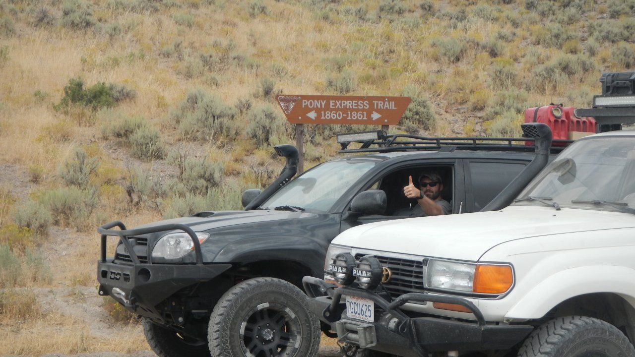

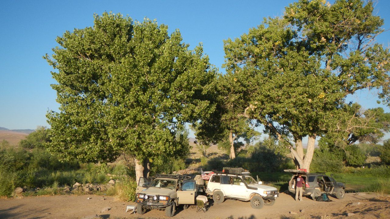

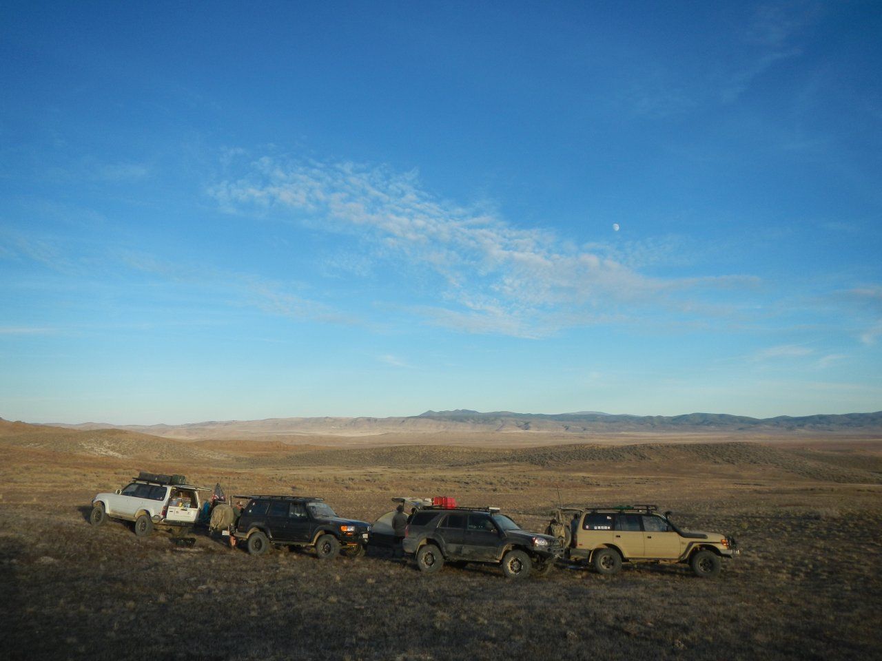

The end of August we traveled approximately 450 miles in 4 1/2 days across the original Pony Express Trail (PEX) in Nevada. With two other vehicles, a Land Cruiser, Casper, and a 4Runner, Darby, we jumped on the PEX in Ibapah, UT and came off the trail in Carson City, NV. Attached are some pix from the trip.

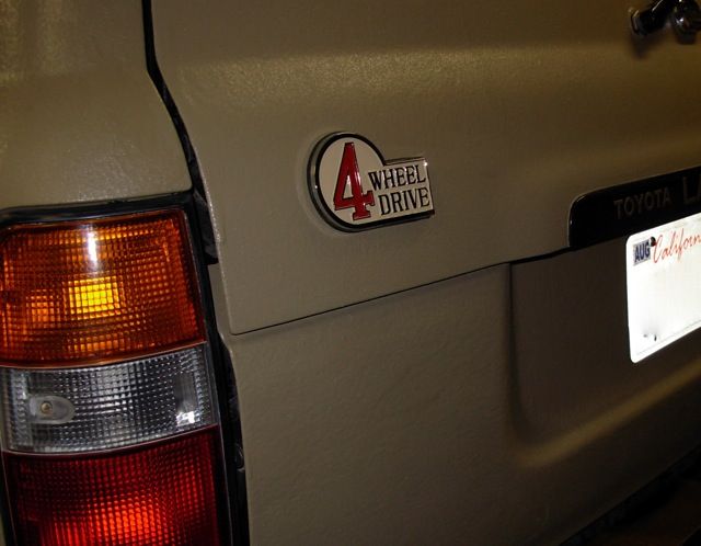

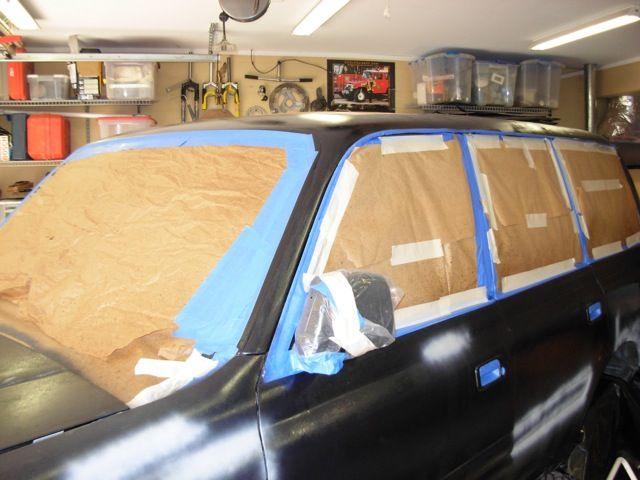

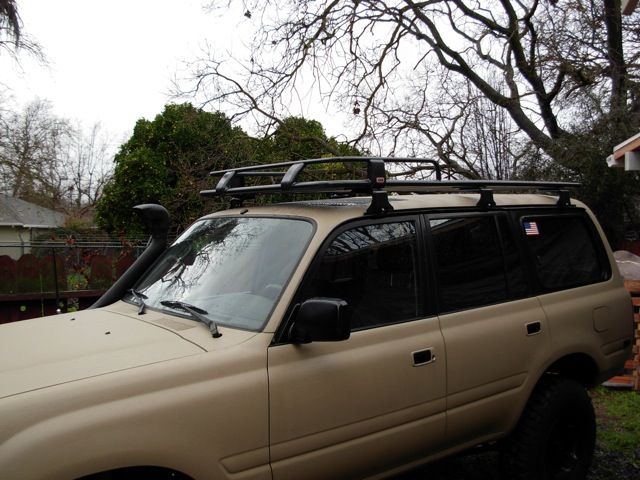

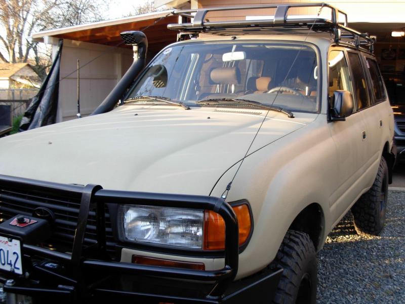

I knew it had to be white or tan as a tribute to the guys I worked with overseas. I decided on tan. I researched on Mud and found several good threads. I liked ashooter's : Not a "$50 paint job" but... And after seeing Ardentyota and his LC: Lined my 80 Tan and Plutonius' : Lining the whole rig with Al's I decided to use the Al's Bed Liner.
View attachment 491167View attachment 491168View attachment 491169

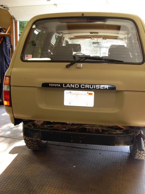

Also why have the front & rear bumper been removed, was that temporay for painting the body?

Hi Maria

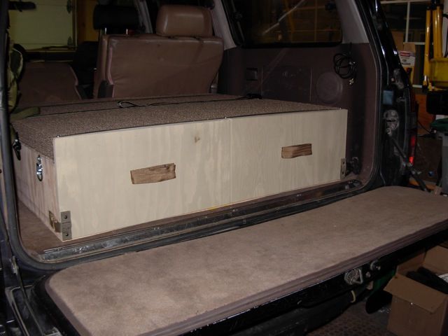

Happy to help with your rig.maybe we can build you some drawers. Wheels are just spray painted with rustoleum, about 20 bucks. Roof rack is designed for land cruiser, there may be a model for your vehicle too.
Bumpers were new after I painted.
