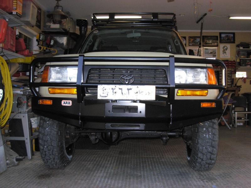

Bumpers were new after I painted.

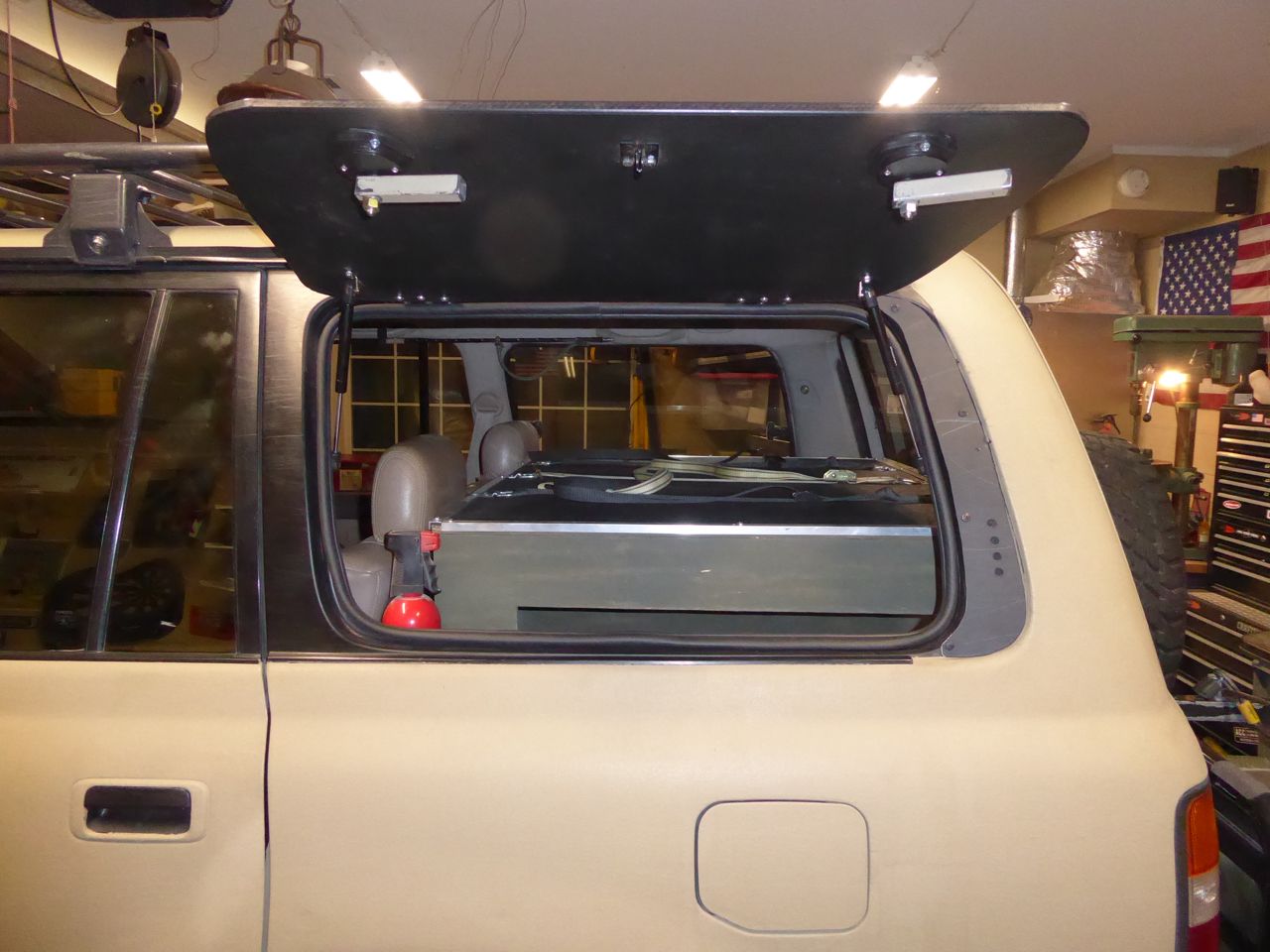

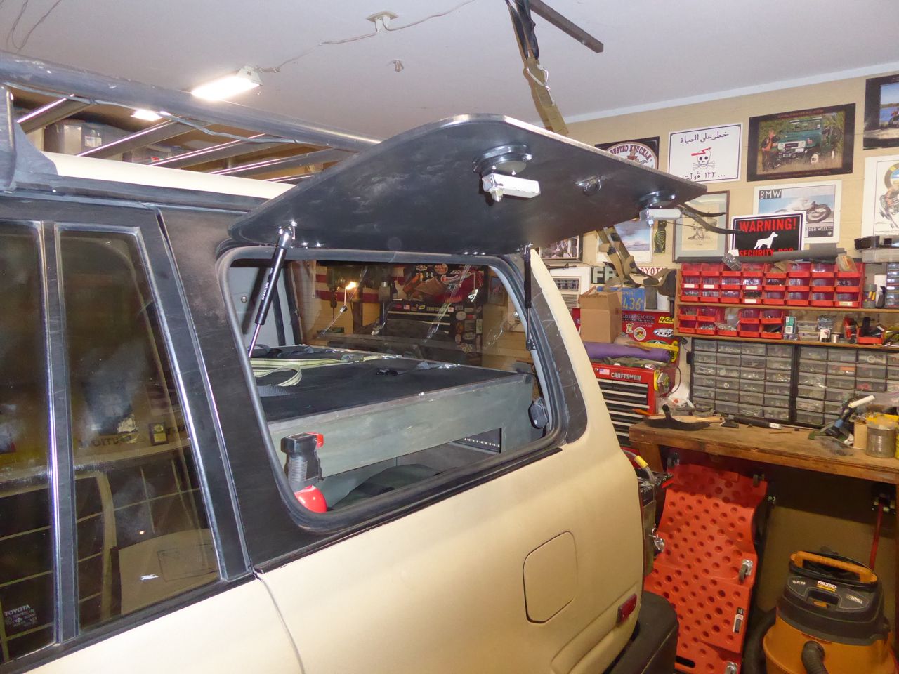

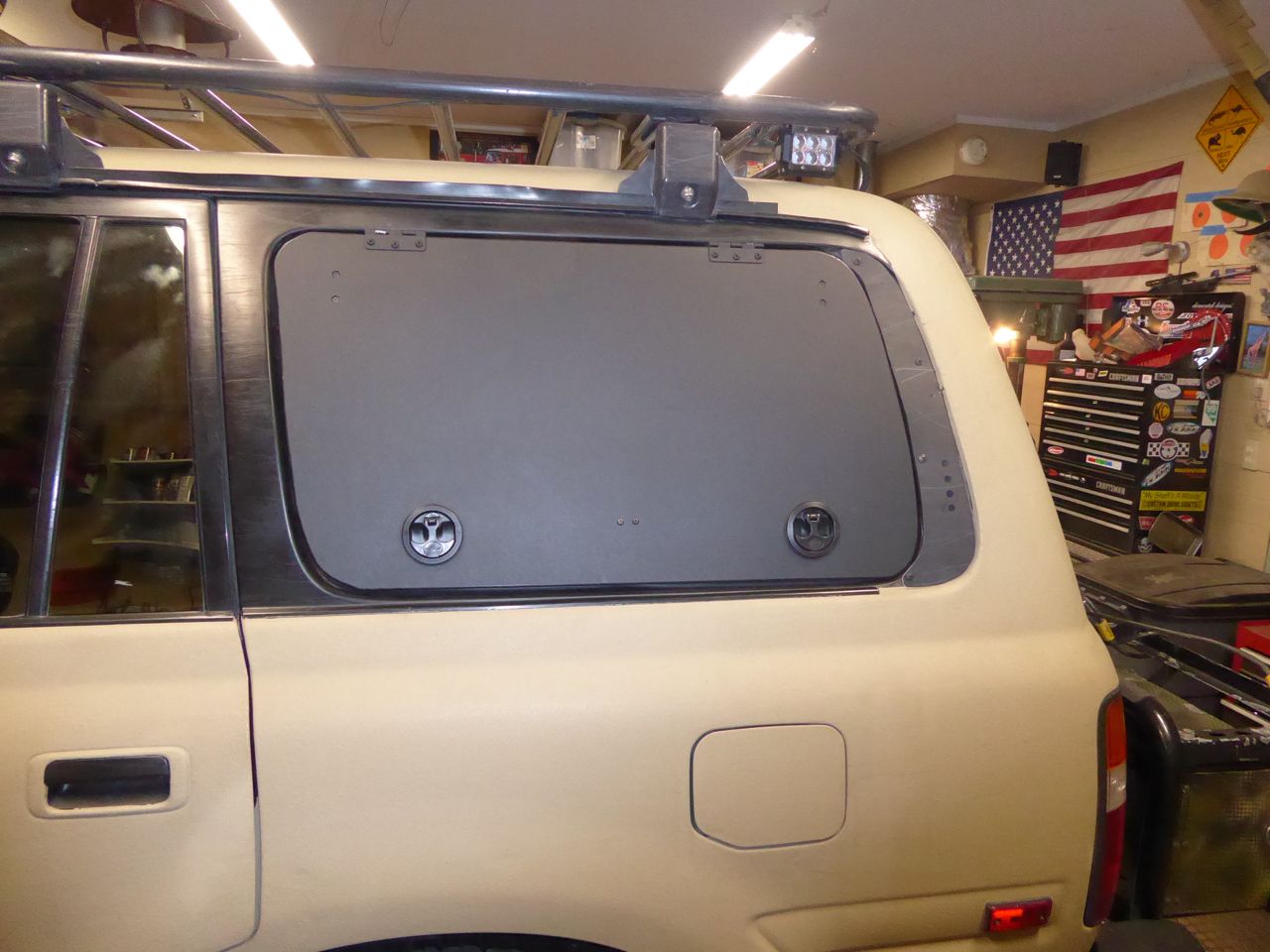

After our last trip I was determined to gain better access to the rear cargo area. I rebuilt the drawers and fridge slide to incorporate our new Waeco/Dometic fridge and built a fold out kitchen (photos of that later). A broken latch incident (dreaded 30 cent plastic clip failure) resulted in trailside cargo removal to gain access to the latch from the inside. The new box was taller and I wanted to access the useful space on either side. My sliding windows were not sliding so well and I needed greater opening space.
On return I looked longingly at the Land Cruiser Products cargo hatches, but had no budget for two of Land Cruiser Phil's awesome lift up windows.
So, after some research and a bit of material testing I decided on the following:
Panels are 1/2" King Starboard marine grade HDPE. Cuts with woodworking tools (jig saw, hole saw, router)
Latches are Whitecap T3226BC (locking)
Gas struts are from Apexstone (Amazon)
Hinges are standard cabinet hinges from Ace
Weatherstrip is from eBay
LED strip lights from SuperbrightLEDs
Total cost for two hatches: $225.
By no means are they in the same league as Phil's but I think they will work for me.
Some photos are attached:

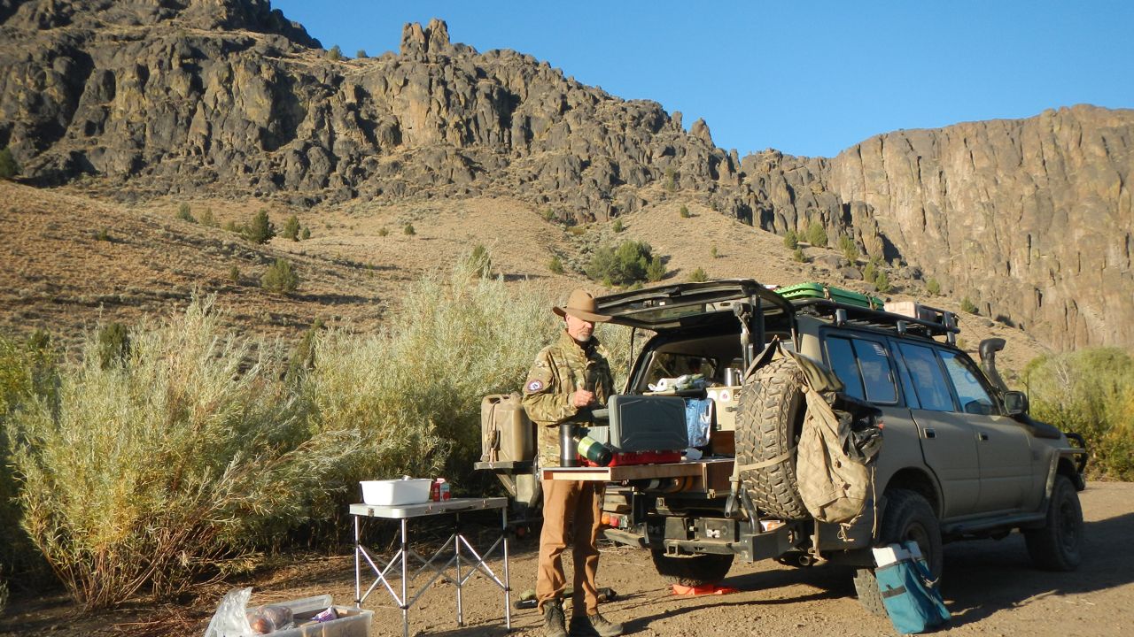

Since I sold my trailer, I concentrated on making the back of Dingo more efficient for meal prep, etc. A mate bought me a new fridge for helping him with his rig (and storing it while he was overseas). I decided to build a pull out/flip out kitchen using one of my rear drawers. Attached are a couple kitchen pictures.
The Camp Chef Everest stove is fantastic. And the Waeco/Dometic 65 fridge has both fridge and freezer.

View attachment 1572695 View attachment 1572696 View attachment 1572697 View attachment 1572698
Windows keep a seal? No water leakage?
After our last trip I was determined to gain better access to the rear cargo area...
looks great!
any details on the struts themselves? length? lift specs?

Some photos of slide out kitchen

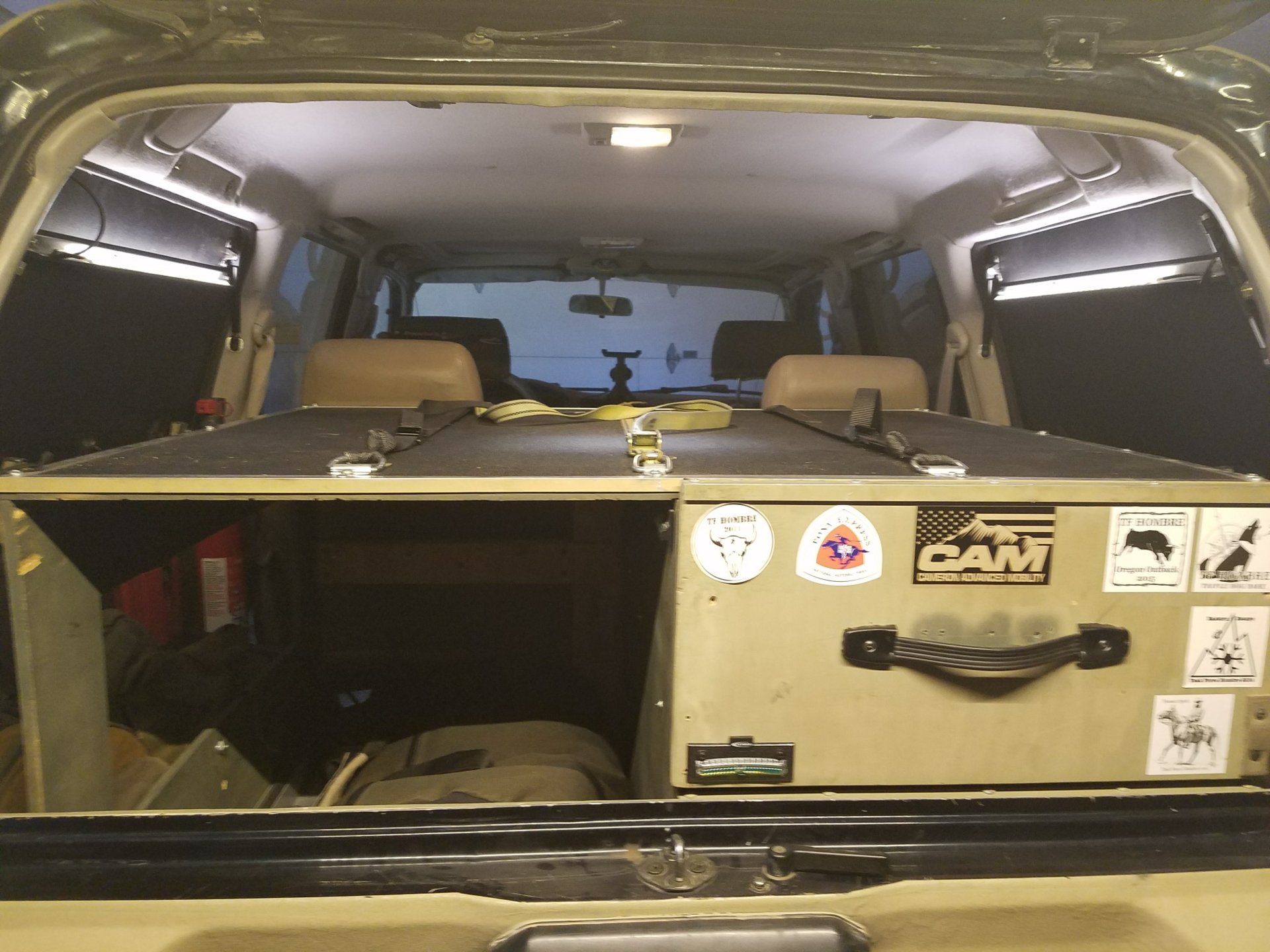

Some photos of the continued evolution of storage.

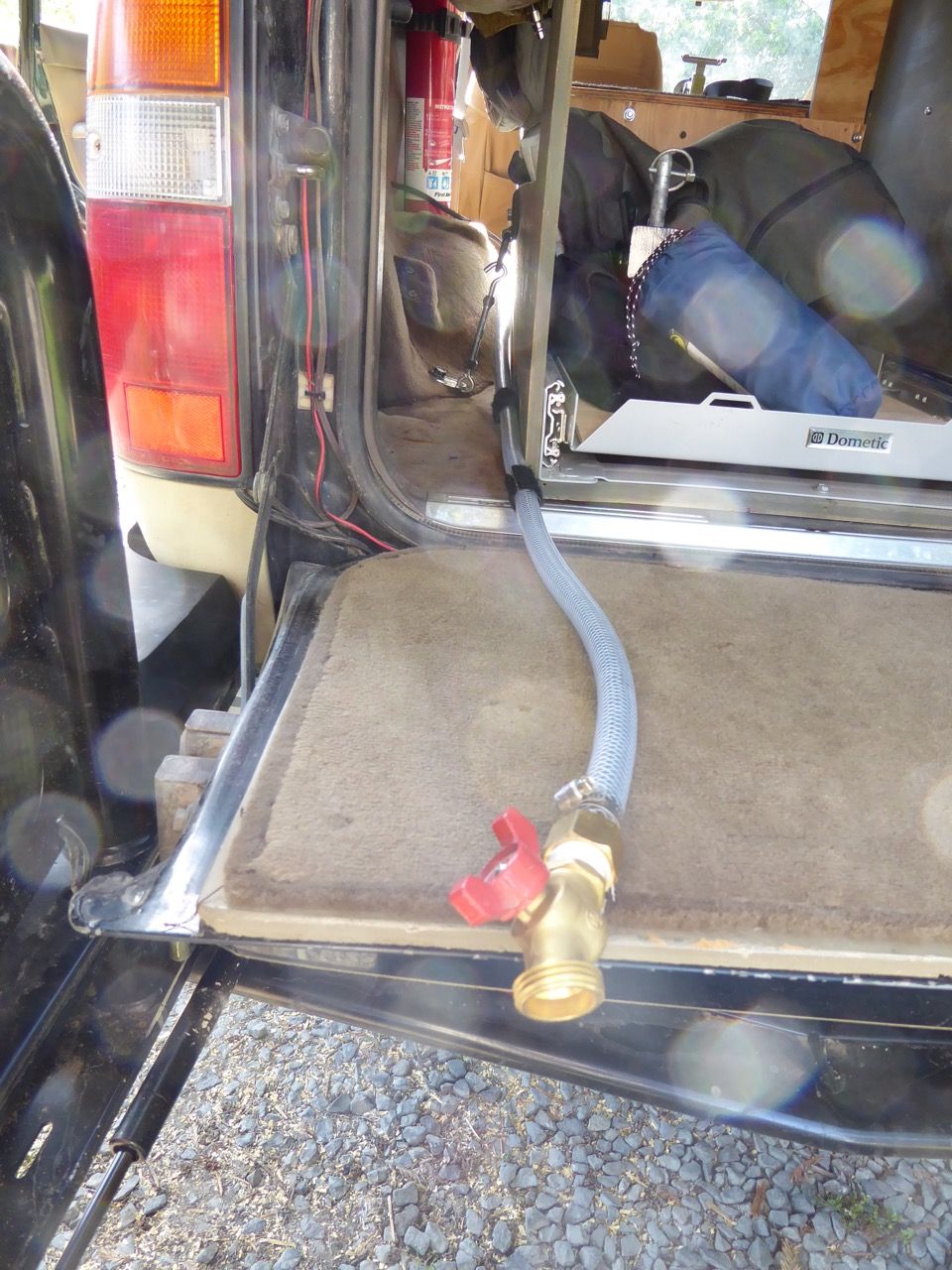

Front Runner water tank with tap at the tailgate

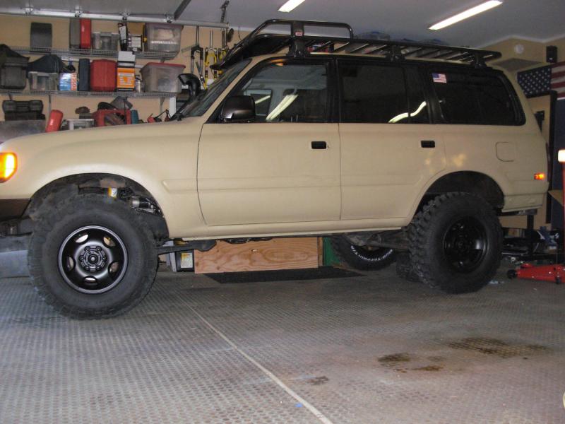

Could you post a pic from the side that shows the whole rig? I have the same lift and am looking at 315s vs 255s in the KM2. The 255s fit okay on the stock alloy wheels?
