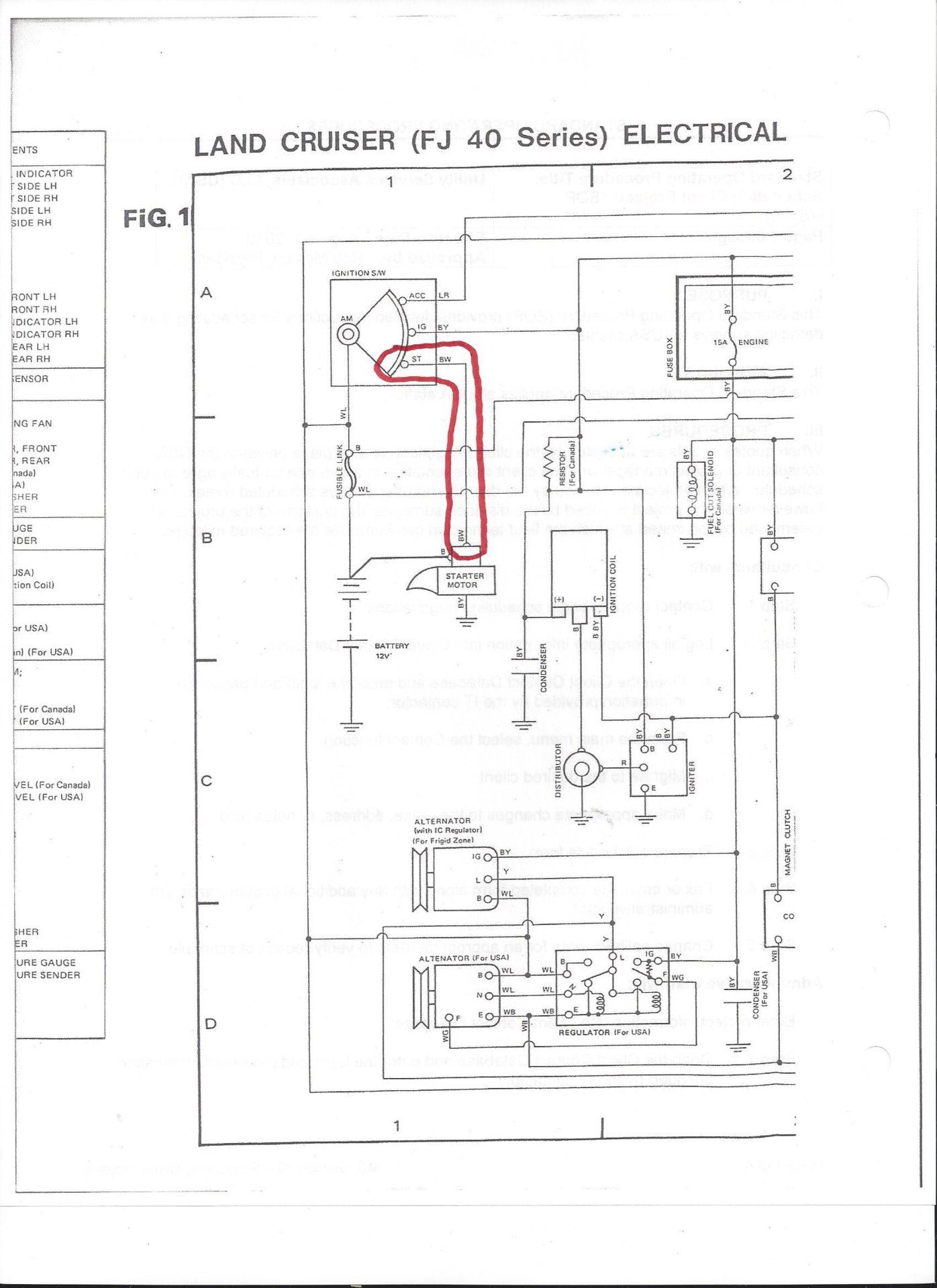

I believe you are talking about this wire circled in orange. When I tested it Disconnected from the starter it had full battery voltage when the key turned to start position. I will test it again while connected to see the voltage drop. It may good continuity and voltage when unloaded but not when asked to actually do the work. I suppose the problem could be upstream from the ignition switch through the fusible link and battery positive.
It could have 12v, but too much resistance to supply the necessary current.
