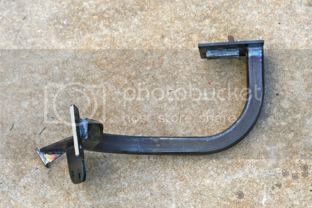

Due to a new connection with a local laser cutter, I've decided to re-enter the market with this design.

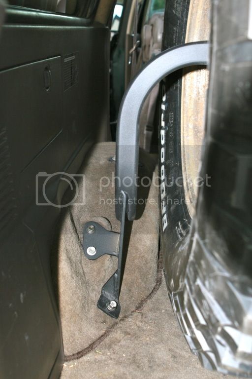

I was asked by a fellow Olde North State Cruiser member to help come up with a way to mount his spare tire, other than building a swing out tire carrier. He had a 4X4 Labs rear bumper that is fully capable and ready for a swing out spare mount, he just didn't want to go that route.
So, after some thought and a couple Smuttynose IPA's, I came up with this. It uses the OEM mounting holes for the 3rd row seat rail on the driver's side. I also incorporated the 3rd row seat belt bolt which adds another level of security and stability.
The best part, it takes minutes to install, no holes to drill and is very stout. It also has over 3" of adjustability, allowing tires from 31-37" to be mounted inside the rear cabin. This adjustability allows the tire to sit on the floor and not rattle at all. The mount also allows one to slide the tire out without significant adjustment/removal of rear cargo, just tilt the tire/wheel away from the mount and it will roll right off the tailgate.

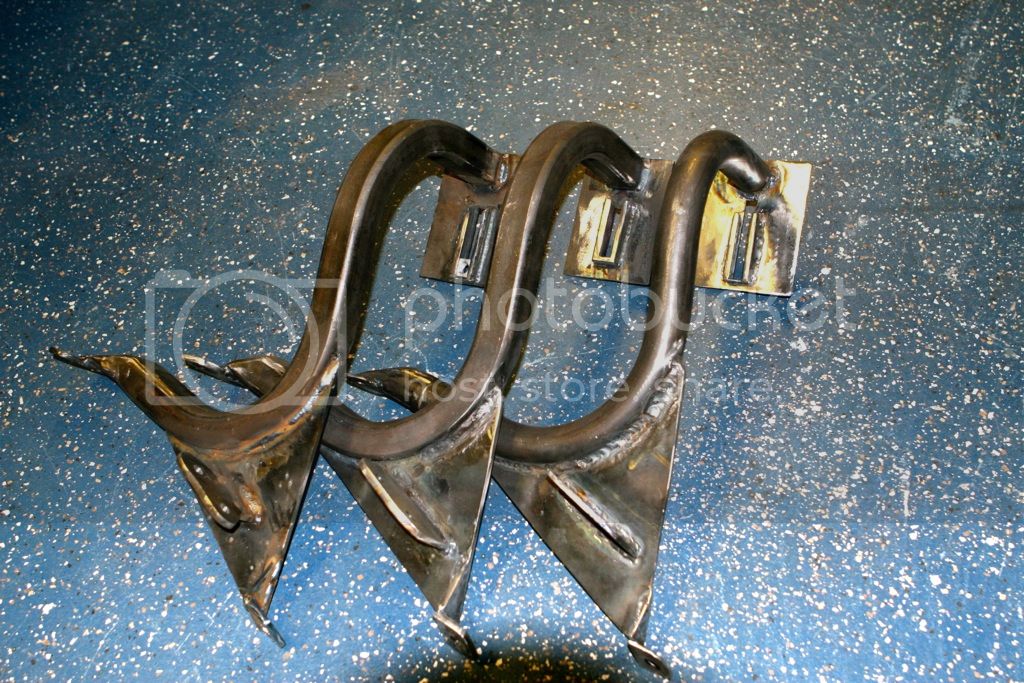

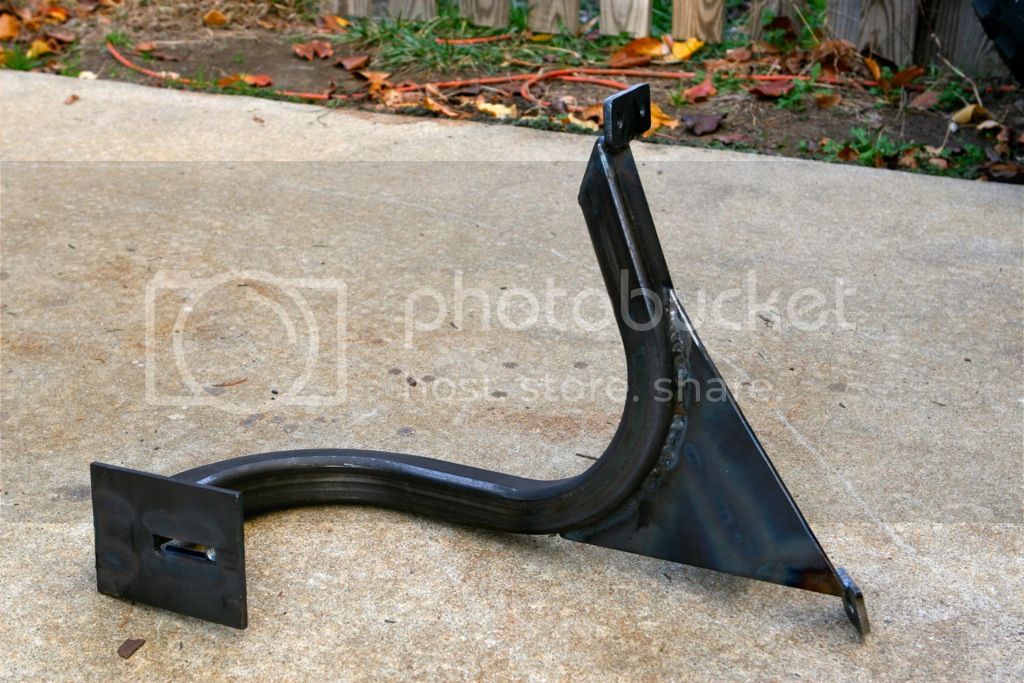

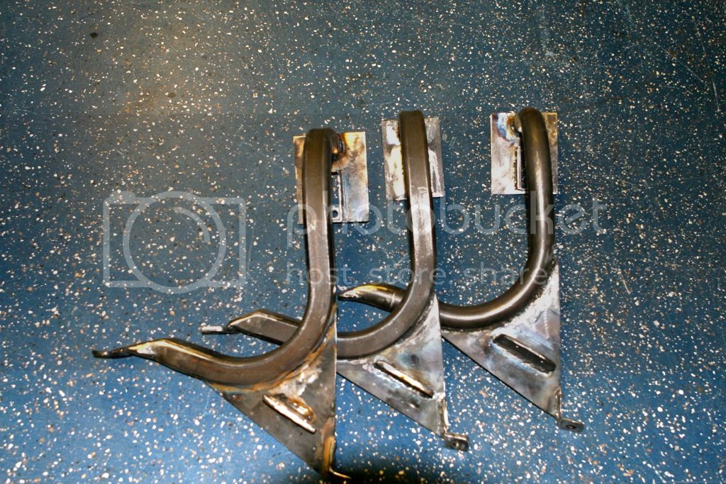

I'll offer them in two formats, Square and Round.

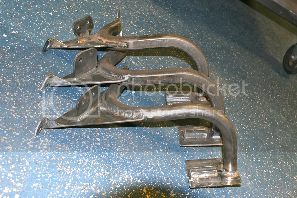

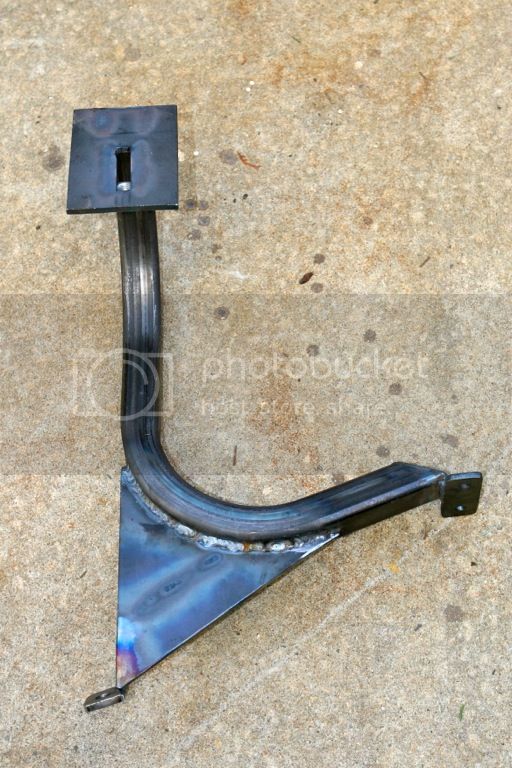

The Square...made from 1.5 X 1.5 X 0.120" square tubing and 7 gauge plate, exceptionally over-built (19 lbs shipping weight).
The Round...made from 1.5 X 0.120" round tube and 7 gauge plate, no compromise other than shape
$195 raw
Both will be available in the raw, for the end user to paint/finish as they see fit. Or, available powder coated in Satin or Gloss Black (other finishes available on request).

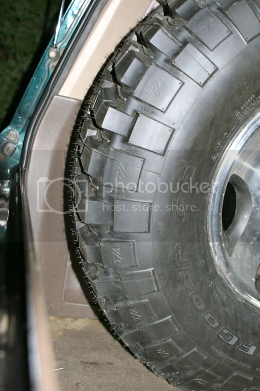

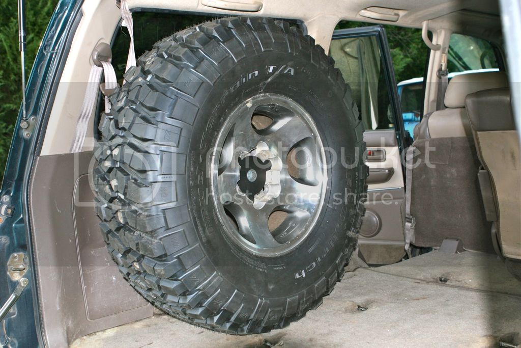

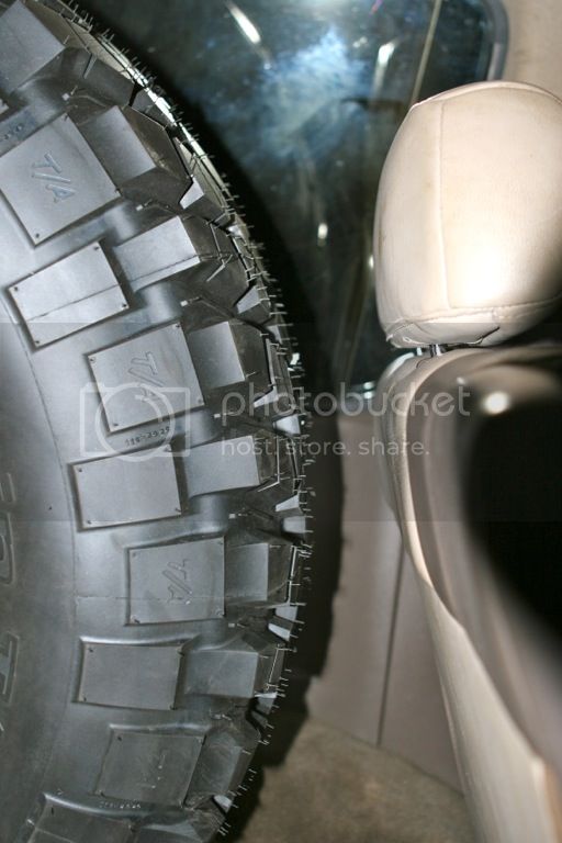

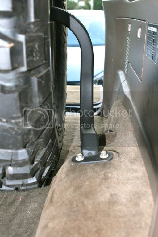

Features of both...adjustability...This picture shows the Interior Tire Mount with a brand new, BFG KM2 315/75/16 tire on a stock OEM alloy wheel. You can see that it will adjust up another 1" and down 2" (3" total travel) to accommodate tire/wheel from 31-37"...

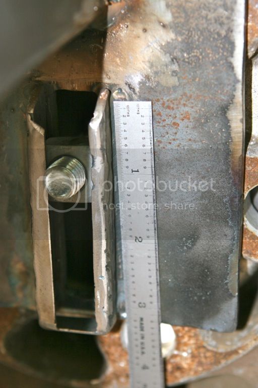

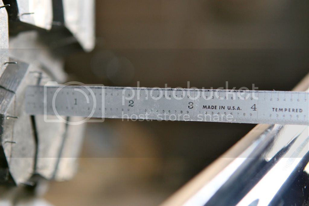

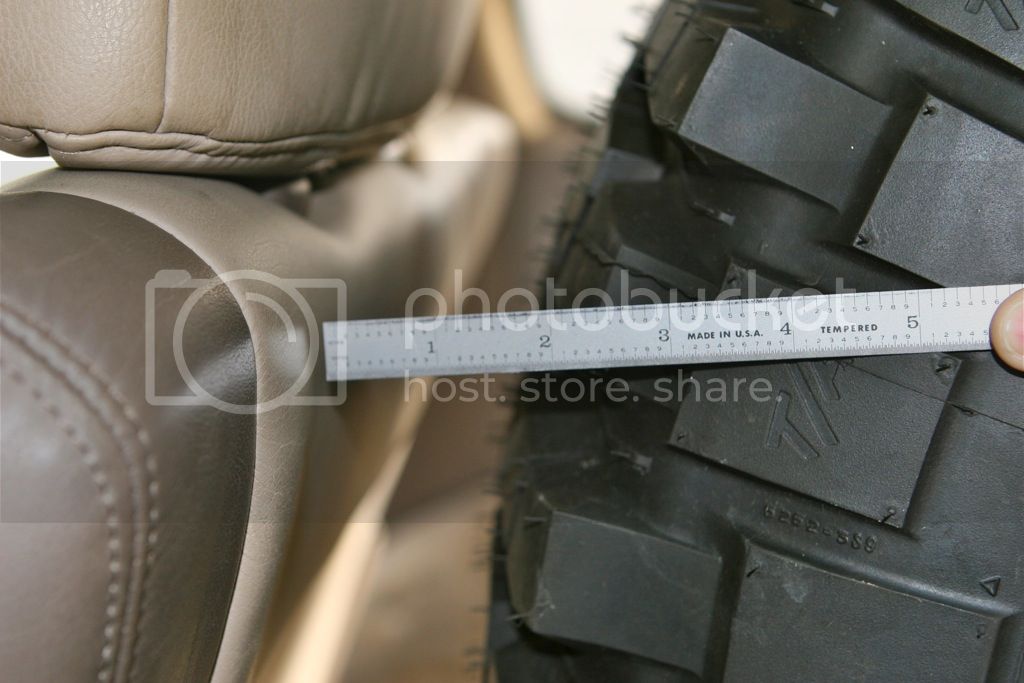

It has clearance to the 2nd row seats over 1.5" and 4" to the rear tailgate...

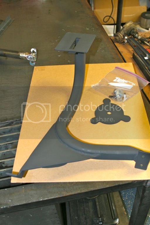

What comes in the box...one Interior Tire Mount, one wheel mount, one 2 X 1/2"X 13 tpi bolt, one 1/2" X 13 tpi square nut...

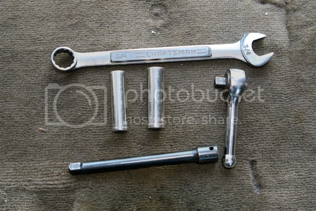

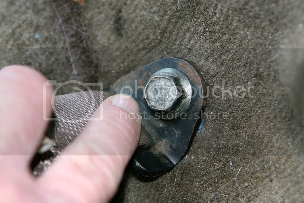

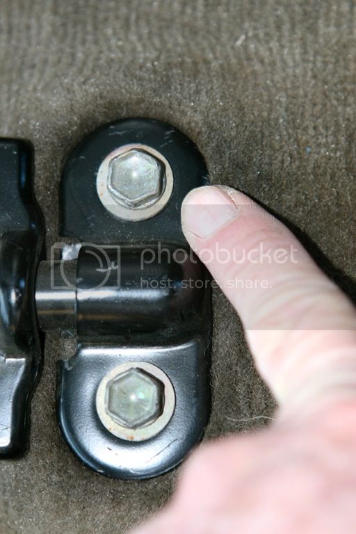

Easy as one could imagine. No drilling or modification of the rig, 6 bolts to remove, 5 bolts to install. Here is all you need for the install...

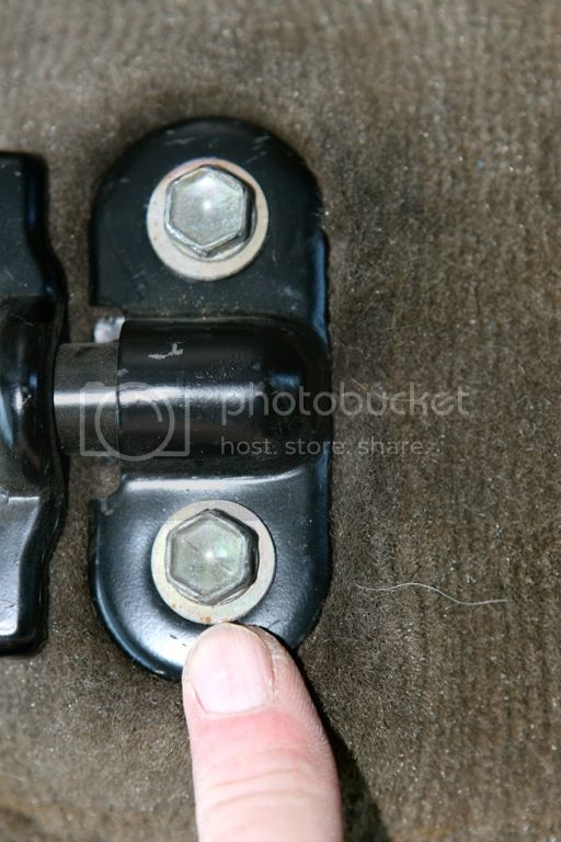

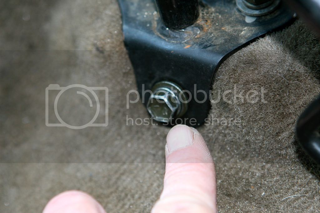

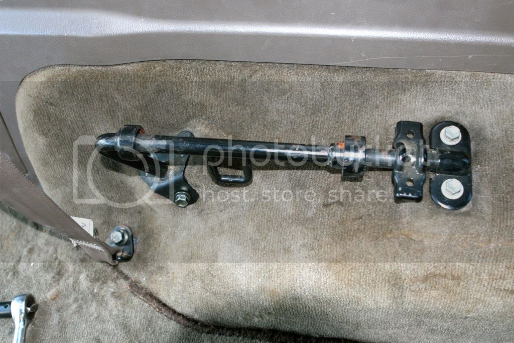

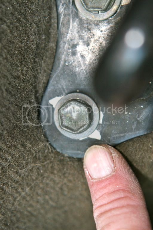

Some pics to help, just in case. Here is the driver's side seat rail to be removed...

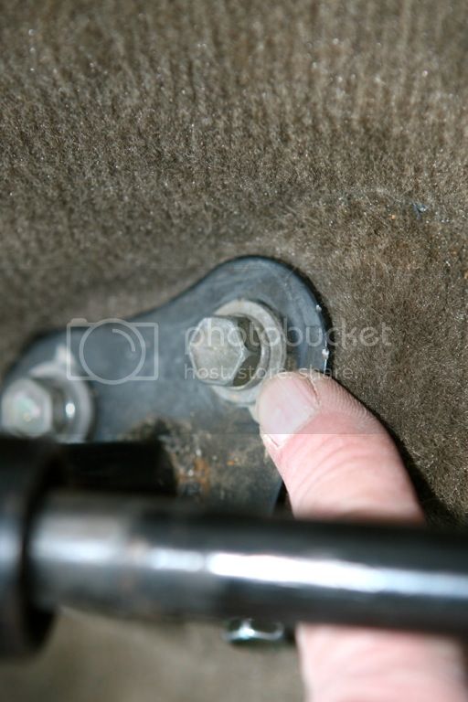

Remove these bolts...
Save your hardware, install the Interior Tire Mount to the two front, two middle and rear seat belt bolt. Roll the tire/wheel into place, use the 1/2 bolt, inside the wheel mounting plate, align it with the square nut in the channel and tighten. You are done.

Torque specs for 12mm bolts = 14-22 ft/lbs, 14mm bolt = 25-40 ft/lbs
Pics of the final install with a BFG KM2, 315/75/16 installed on the Interior Tire Mount...

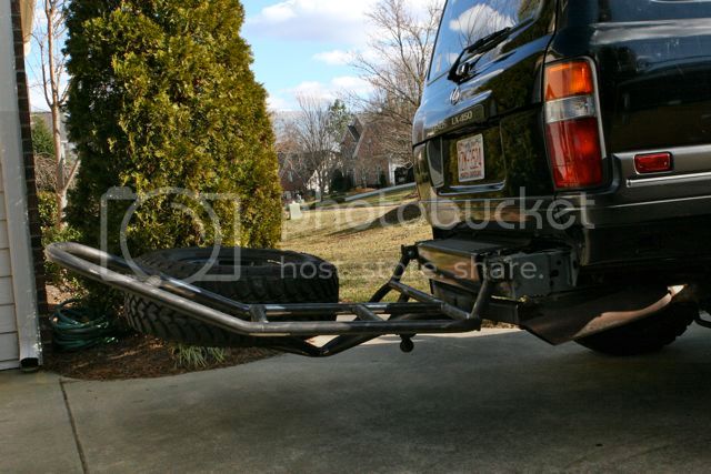

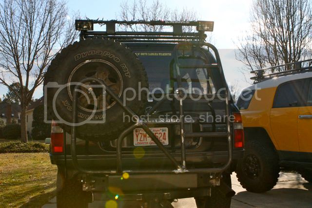

I built a "swing down" tire carrier w/ladder for a club member on his stock bumper although, he did remove the plastic to do it...
