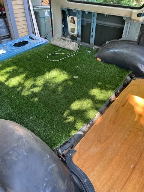

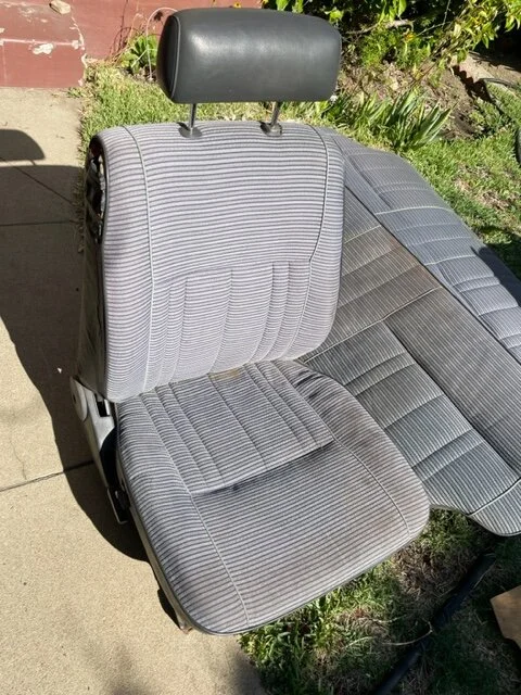

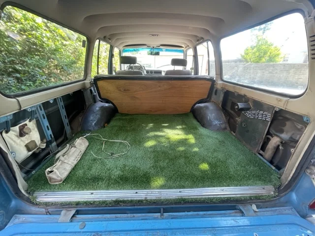

SO, I tore apart Yarn-ball's interior in preparation for carpet install, door panel replacement, upholstery install, steering wheel replacement etc
these pics are sort of the before. The wood panels that I made for all the wall, seat, back door panels aren't going back in. If someone wants them they can grab them in Pasadena until I'm tired of seeing them. They aren't great just bodged up to make the back look better than the mess it was when I gifted the truck to my Wife.
The turf I will keep. I've made a habit of putting it in the back of my pickups and wagons over the years, I find it really useful.
I didn't get very far today. but tomorrow I think I'll have the entire day to devote to it.

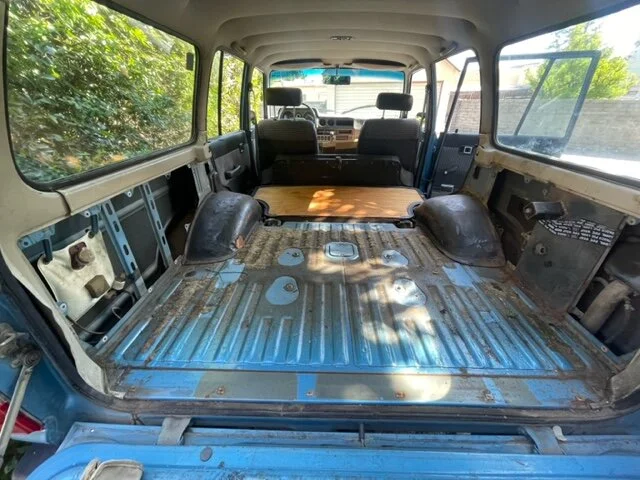

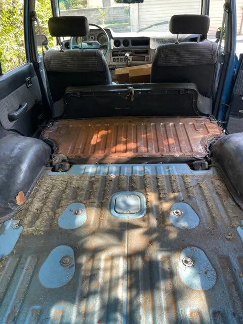

pieces that came out -
all seats
seatbelts
cargo area paneling
cargo "carpet"
rear seat carpet
center console
Wheel hump vinyls
then I vacuumed for what felt like 2 hours. Cleaned up the floor heater and tested it's operation. I think it needs fresh hoses which I'll assess tomorrow .
finally I laid the cargo and rear floor carpet in to feel like I accomplished something. It's just resting in there. There is a lot of floor cleanup, sound deadener, rust treatment to be done before it's actually installed.
the spare tire mount the previous ( maybe 2 ago) owner made didn't work for me. It will be cut off and the rust that has formed from the welding and spatter will be treated.
I'll also be giving the seatback a thorough scuffing and painting. With either por15 or a rustoleum type of product.

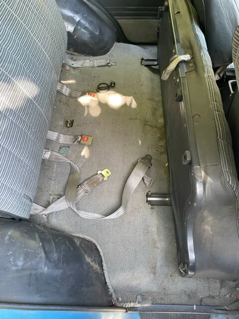

This area leads me to a question:
Is there meant to be a steel plate that covers the gap between the seat-back and the cargo floor when the seat is folded forward?
I notice nothing protects the seat belt reels or the small air space between the seat and floor in this truck.

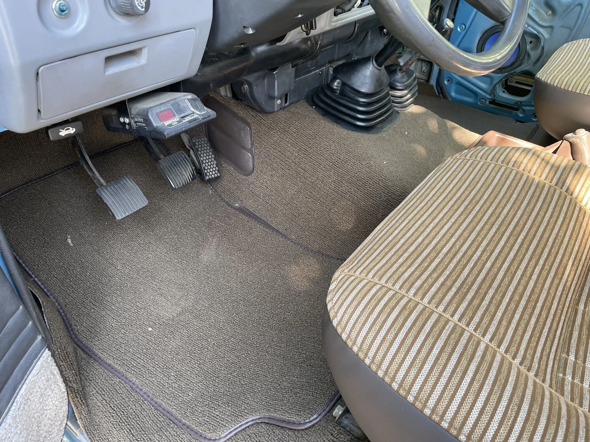

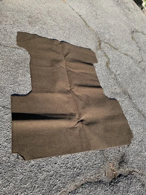

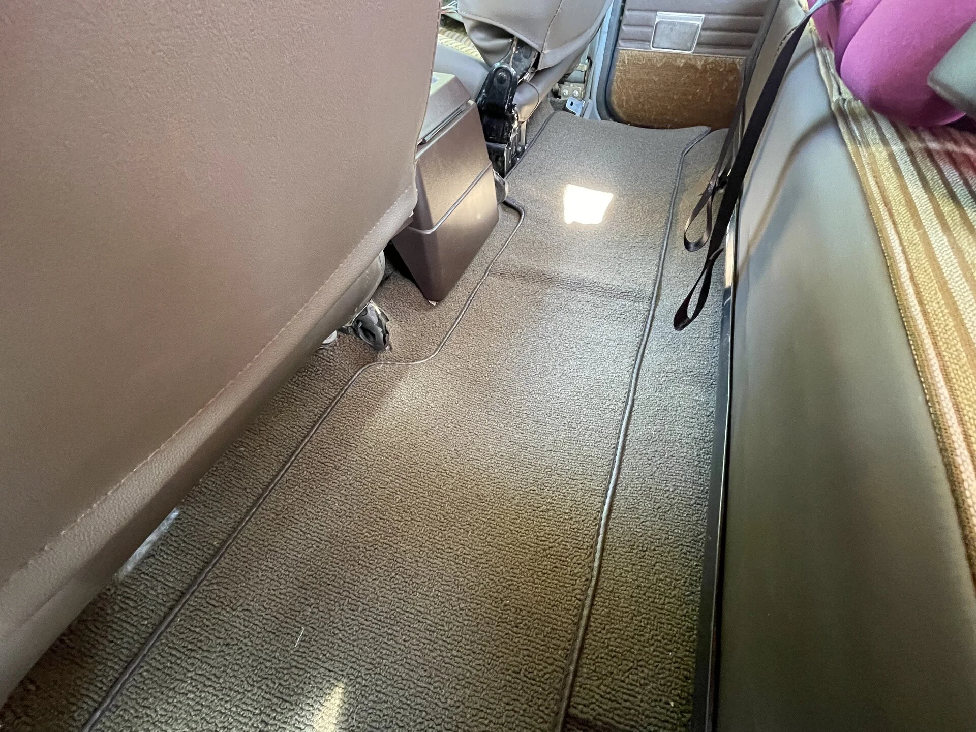

Carpet kit from @dnp installed and I find myself very happy with the result -

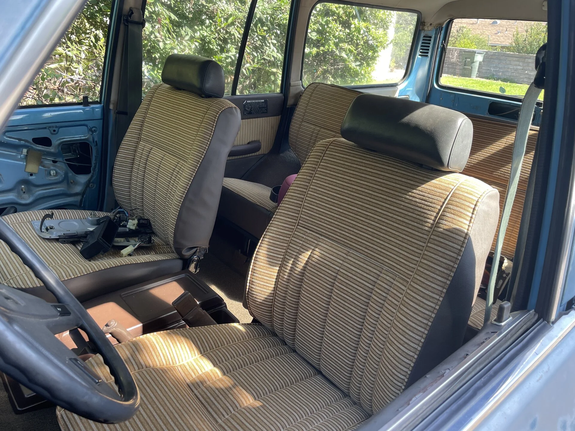

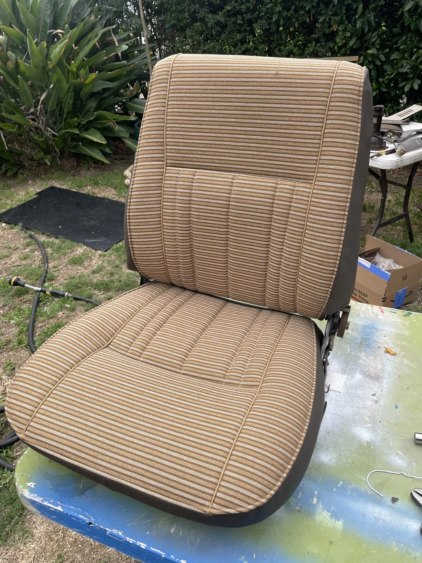

Seat cover kit from @MSP1989 installed and I find myself MOSTLY happy with the result -
Still working on door guts with new regulators , new speakers (with spacer speaker rings from @TheNeek) up front. Dynamat all around and new vapor barrier for all 4 as well.
Then I'll install my, new to me, brown door panels (cleaning them up now) compliments of @SAH
Steering wheel is in. column plastics are painted and in BUT I need to find a different shade of brown for them. I used a rustoleum product but I think the SEM Cordovan Brown is the better match for our interiors.
Debating the best dash pad move. I think a brown plastic cover and painting the lower would be easiest while using the truck. But I'm tempted to pull the cover and attempt a crack repair and refinish either with vinyl of fiber glass.

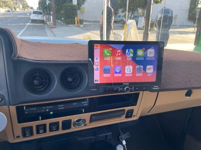

I changed the STereo head unit that we were running. It was an inexpensive Pioneer SPH-10BT that had Bluetooth and a clamp for phone mount where faceplate would normally be. It's a neat idea and I thought it worked ok but wasn't thrilled with the app (not mandatory) and getting the phone in the clamp wasn't an easy operation.
So I opted for a Jensen CAR910W with Apple CarPlay and backup camera.
I haven't owned a modern enough car to experience CarPlay or Android Auto regularly but I've really enjoyed it in rental cars over the past couple years.
I love this touchscreen.
It slides up and down, tilts,and rotates. picture is the highest upward option and pivoted toward driver.
I wasn't a fan of Jensen products before now, but I am very impressed with this one.
