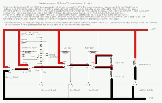

The Intermittent Wiper Circuit –
While ever the ignition is ON a 43,000 ohm resistor and a 100uF bi-polar capacitor are connected between +12V and 0V (through the wiper park system). The capacitor charges towards +12V.
When INT is first selected the power stored on the capacitor immediately flows through a diode and a 2,200ohm resistor to switch on a transistor. (A tiny amount also passes through a 47,000 ohm resistor). When ON the transistor switches the INT relay to send +12V to the wiper motor.
When the relay operates the +12V and 0V connections to the capacitor are reversed via the INT relay AND the PARK switch (the 43,000 ohm resistor acts as an isolator). The voltage on the capacitor drains rapidly through the 2,200 ohm resistor and continues to fall too well below 0V (to about -8V). It takes about 0.5s for the voltage to drop low enough for the transistor to switch off, but by this time the PARK switch is supplying +12V to the OFF position of the relay so the wiper motor continues to run.
After a full wipe cycle the PARK switch will again swap the +12V and 0V connections to the capacitor which will start to charge up from -8V towards +12V. The rate that it charges is controlled by the 43,000 ohm resistor letting +12V in while the diode, 2,200 and 47,000 ohm resistors are letting some leak out. It takes about 4s to rise high enough for the transistor to switch on at which point the Intermittent action repeats.
Modifying the Delay Times –
The 43,000 ohm resistor sets both the time for the PARK switch to take over powering the wiper motor and the time between wipes. We can replace the one, fixed resistor with a combination of a fixed resistor (sets minimum delay time) and a variable resistor (sets maximum delay time) – within reason.

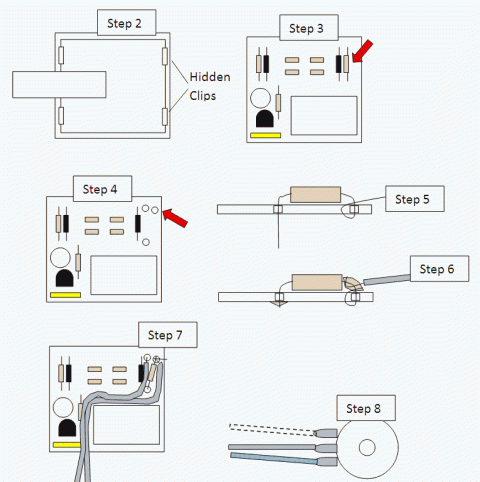

Step 2 – open the box and remove the circuit board – there are 4 plastic clips hidden under the overlapping lid, use a small flat bladed screwdriver to ease these open.

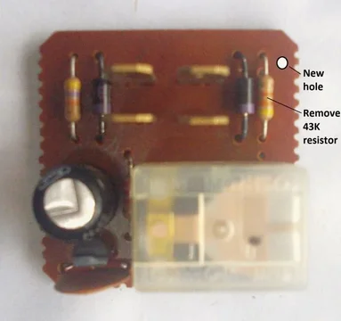

Step 3 – remove the 43,000 ohm resistor (yellow, orange, orange, gold) by melting the solder and pulling out. Clear the holes.
Step 4 – drill a small hole in the top right corner of the board, away from electrical traces.
Step 5 – fit the 22,000 ohm resistor. Put one end into the new hole, wrap the end of the lead wire around the board back to the top, then around itself. Put the other end into the lower hole and pull through until the resistor is flat against the board.
Step 6 – solder the resistor and 2 insulated wires, one to the twisted end of the 22,000 ohm resistor and the other to the empty hole. Trim the leads.
Step 7 – route the wires around the pins and relay (as shown).
Step 8 – solder the potentiometer onto the wires, centre and one end.

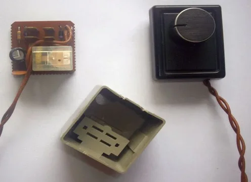

Step 9 – Plug in to car and test. If the knob turns the ‘wrong’ way swap the outer wire to the other end on the potentiometer.
Step 10 – glue the wire joints to the circuit board after testing (hot-melt is fine); this prevents the wires touching due to vibration.
Step 11 – cut a slot in the case to allow the wires to emerge then re-assemble the circuit board into the box. Fit the lid
Step 12 – install the relay under the dash and the potentiometer to a dash panel (flatten the lock tab) and fit the knob. If you use a ‘linear’ potentiometer it can be fitted to the back-side of the control stalk, but I’ll leave installation there up to the eager experimenter.
