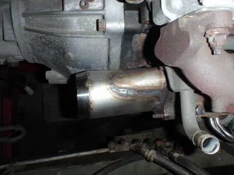

I'm knee-deep in the project now and fabricating the elbow as a side-project when I feel like doing something else.
After having read alot about turbo elbows around the web I had a general idea of what I would like to do, here's a few pics of what I have so far:
From the top:
From top/side:
And inside:
There's a small flap of stainless going in to the turbo blocking the path of gas coming from the wastegate and directing it in to the flow of the turbine wheel later on, as you can see.
What I have tried to accomplish is an uninterupted flow from the turbine, like a divorsed wastegate, but a bit simpler. i call it a separated wastegate ;)
That'll do the job.
Are you sure it's big enough?:D
Thanks! I was gonna keep it 81mm for the first 50cm because I've heard that the first ½ meter must have volume equivalent to the displacement. With 81mm pipe it was a perfect match. But I could mot find any bends that size in the pile so I stepped it down to 76.1 (3"). Although not perfect, as you say it will do the job! :D

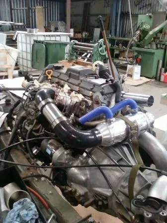

Thanks for the reply. I have settled on a water to air intercooler. Another reason for this is that the route I would have been forrced to take plumbing an air to air intercooler. The Volvo is in essence a mid-engined car. There's almost a meter between the motor and the rad as it is. Mounting an air to air intercooler would require 3 meters of pipe and hose between the turbo, intercooler and intake manifold.

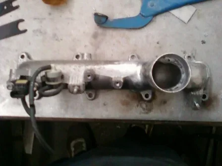

Btw i have made some progress on the exhaust as well as the intercooler. Nobody had spare time to help me change the intake manifold to fit the intercooler, so I had a go at it my self. I've had no experience in welding aluminium, remember I started TIG-welding when I started making the downpipe. But I thought I might as well have a go at it. After all I knew that the TIG welder had to be on AC instead of DC to do it, how hard could it be?
And I found it a lot easier than I thought it would be to be honest! Or maybe it was beginner luck...

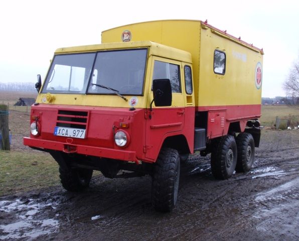

Thanks! Im guessing you don't know the truck we are putting it in to:
So no firewall issues there :)

Congrats on the fire up!! That's a great feeling isn't it....as evidenced be your grin.:D
