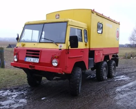

Well we are installing a 1KZ-T from a prado in an old army Volvo truck.

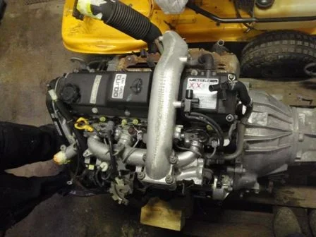

The 1KZ-T has no intercooler from the factory. I want to add one for a few reasons listed in order of importance:
