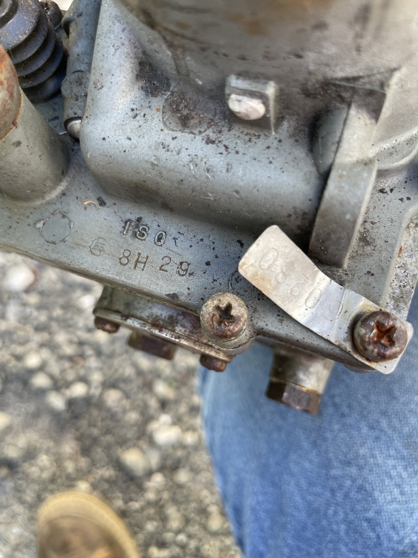

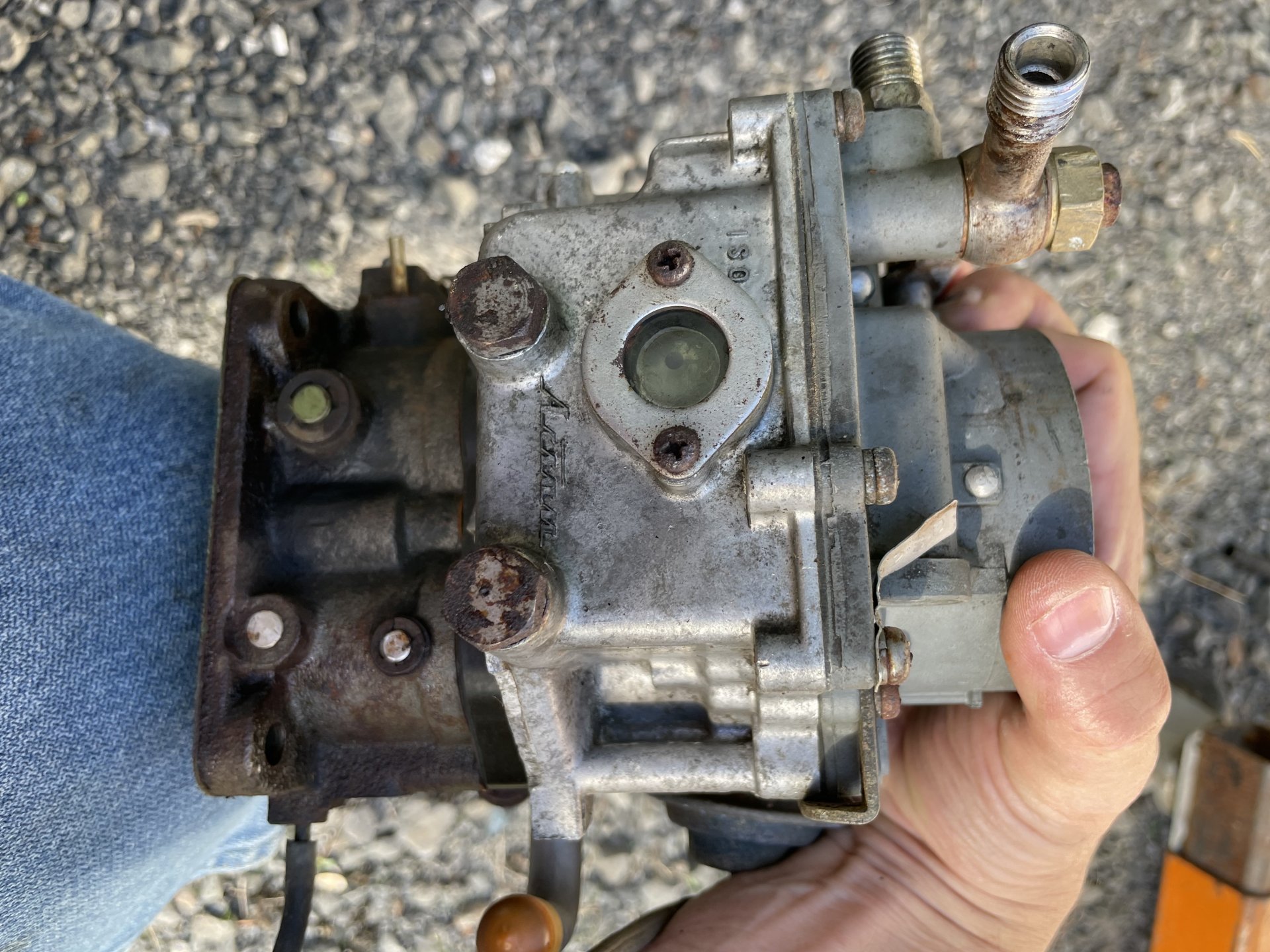

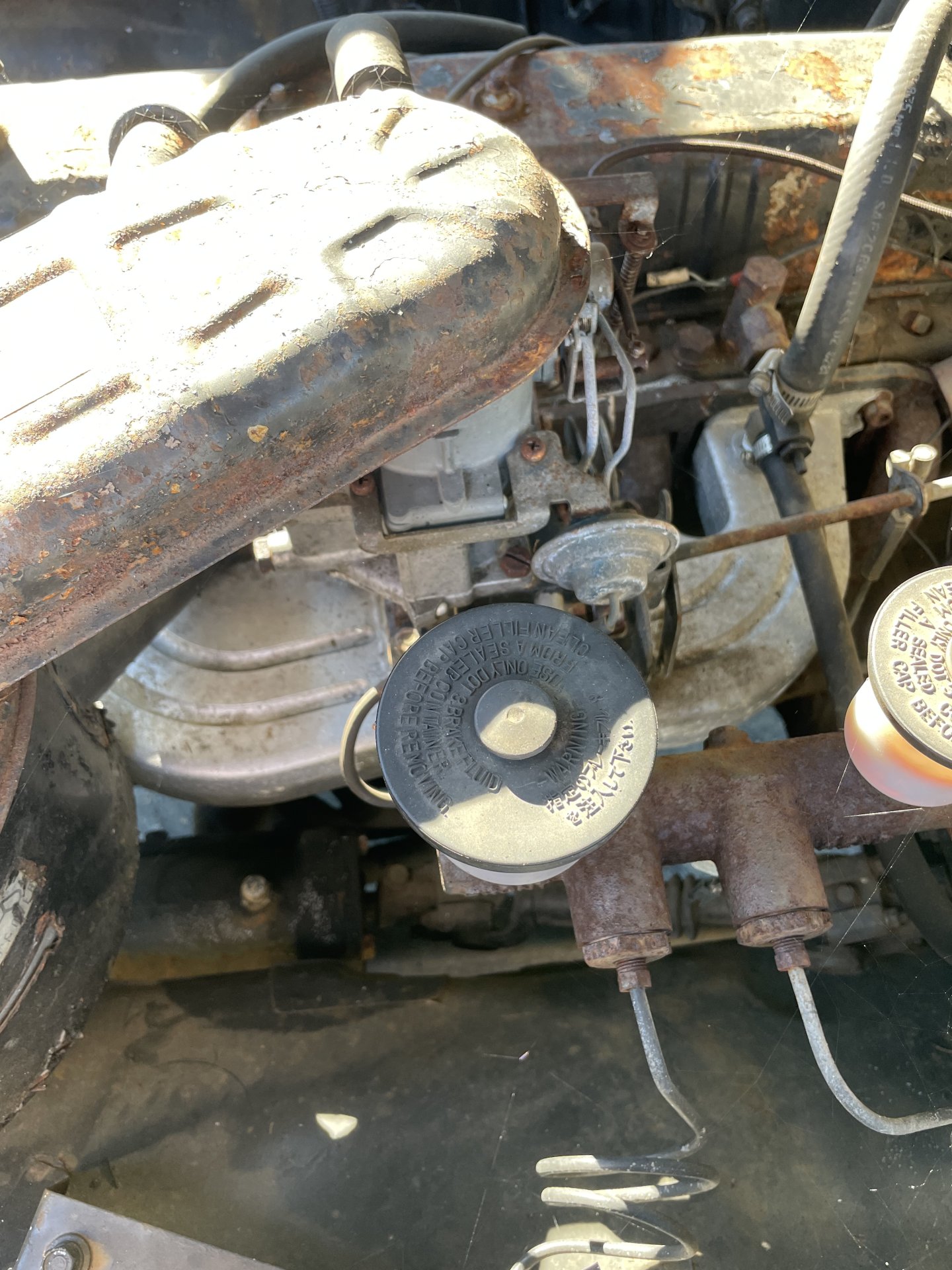

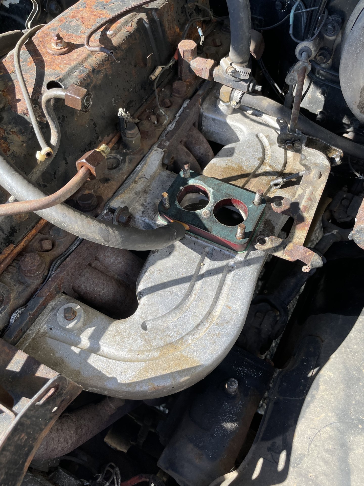

Picked up a new fj55 that I posted in the 55’ section. Anyone know what intake this is? Thanks!
Okay… I checked the faq that was linked and it doesn’t appear to match the wide runner intake. Also, if you look close under the carb spacer you can see some clean machine work. Like they port matched the intake to the carb. No markings found either, but I cannot see the underside very well.
I consider @Pighead to be the resident expert on Clifford.
Thank you for the kind words Mark, but you, of all people, should know that Pighead is no expert on anything.
Other than Offy and Clifford, the only one interested in sandcasting for the LC back in the day would have been Harold Graves. Mr. MANifold FREe.
I feel really old knowing that.
Here’s a great read on MAN-a-fre and several others …
You said it Mark, really old but well aged, theres value in that. Did Warden ever make a manifold ? Maybe we should check with Cruzilla , someones gotta know... Pardion, anyone ?
To narrow this down a bit….Wardens did not make an intake manifold. My first thought was like @65swb45, being a prototype of Harald Graves, possibly one of his daughters have seen this? Laura or Kay? Hey Al are you out there? Offenhauser and Clifford also had intakes.
