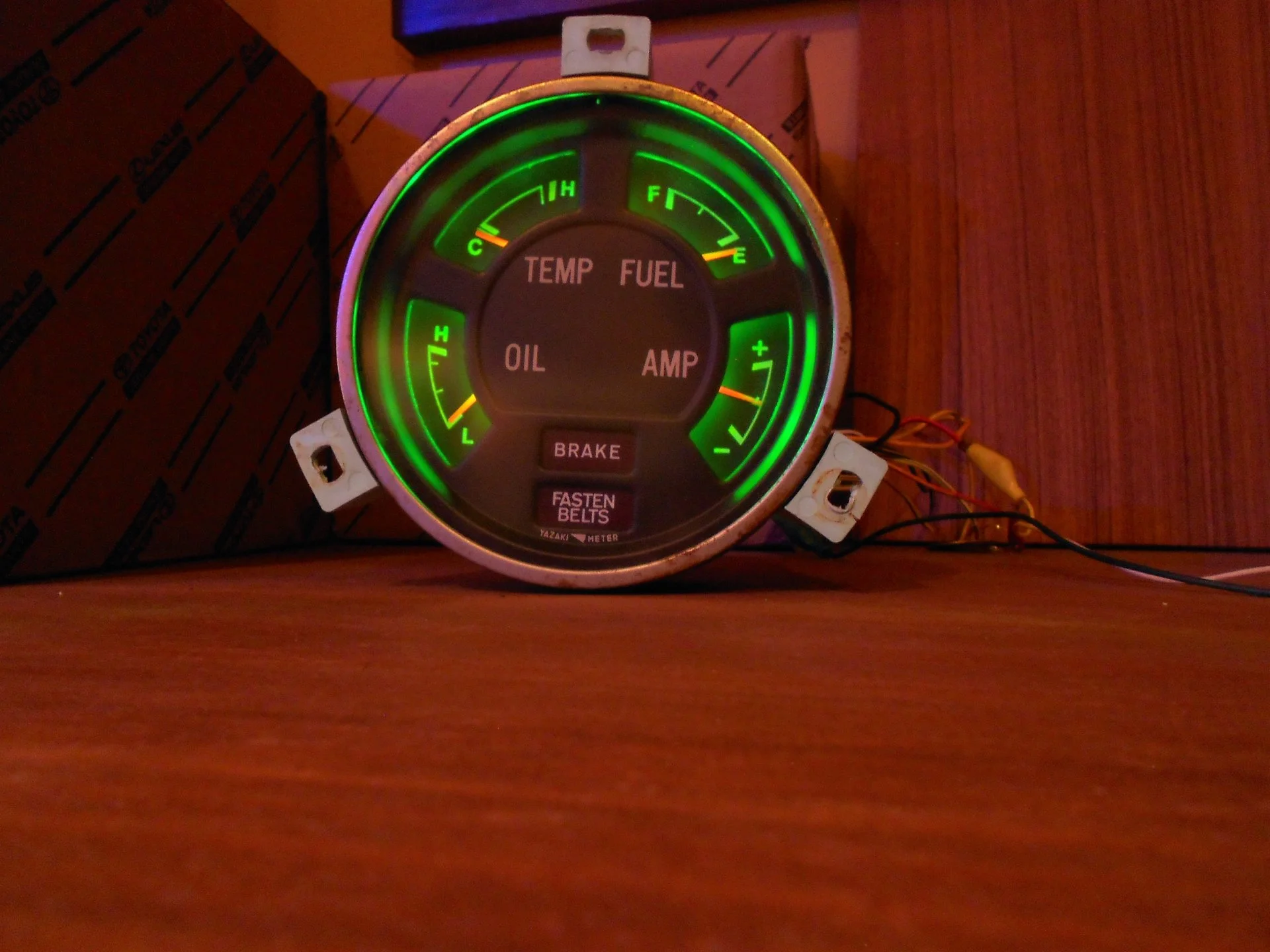

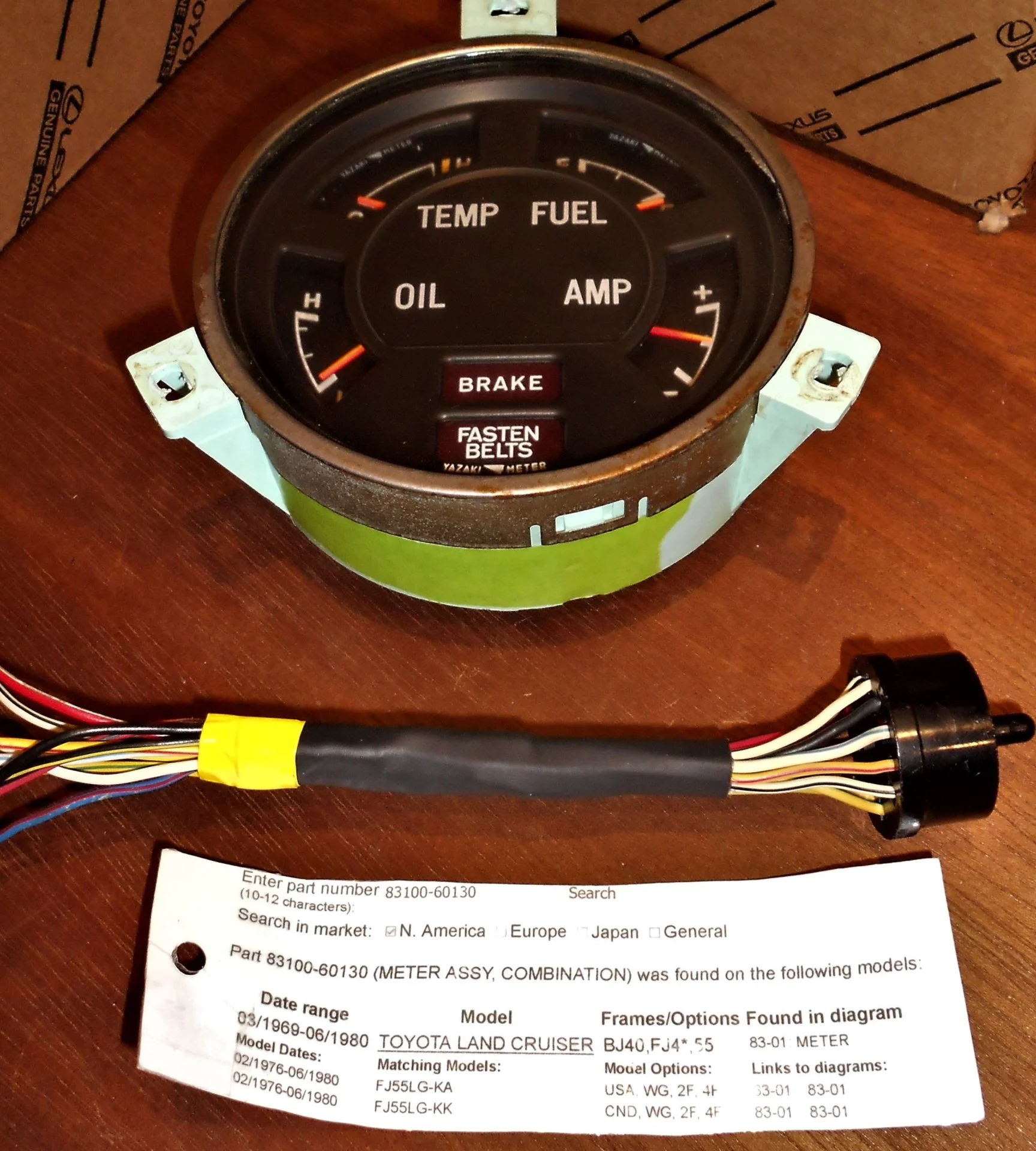

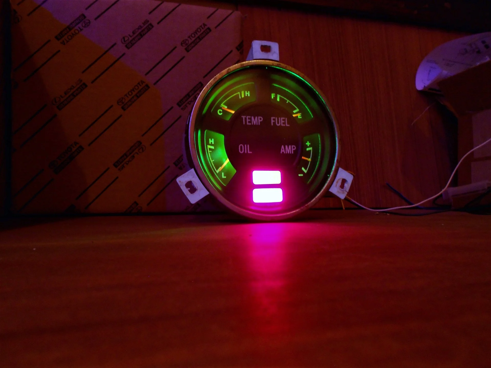

i have updated several FJ55 Cluster meters over the last 2 years or so ,

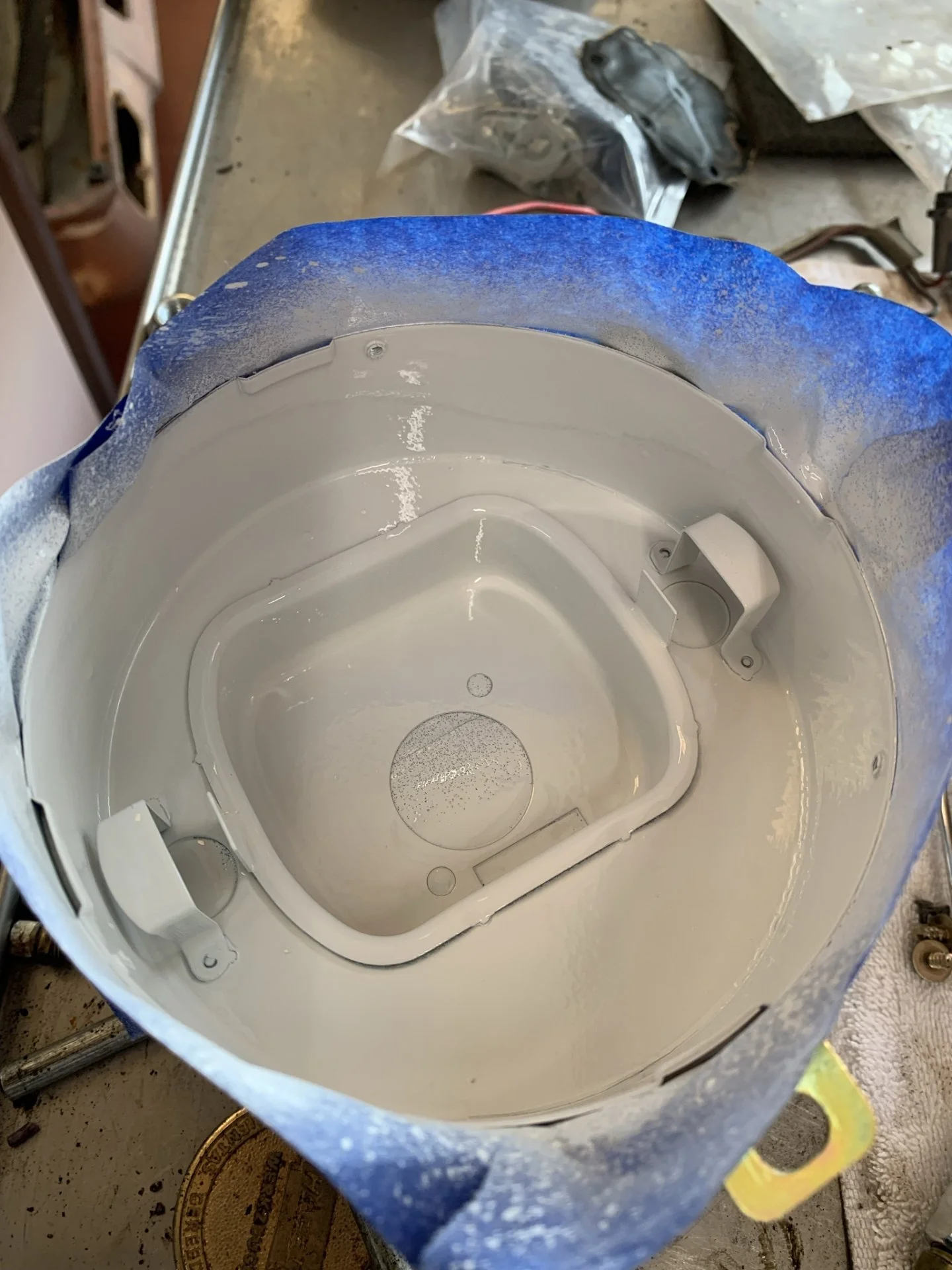

in addition to simply adding / updating to LED bulbs , you absolutely want to consider a LIGHTS Shades Modification , this will change your nightime driving experience for the rest of your life for the better !
here are a few examples of my past 55 work and include ALL the lightshades Modifications too
View attachment 2836941View attachment 2836942View attachment 2836943View attachment 2836944

- LED Super Max Lumens Bulbs
- ToyotaMatt’s. Patient’d light SHADES prescribed Upgrade indeed well needed MoD …
- rust oleum brand CHROME metallic areosol spray at Home Depot
- BLUE color tone LUMENS LED bulbs that make both Oarnge , Whites , yellows , cluster colors pop and glow like glow sticks !
- blue led also makes the color black of a guage face basically disperse and disappear all together …

- NEW Reproduction. 12pin round Barrel Connector Kits are now available too …..
