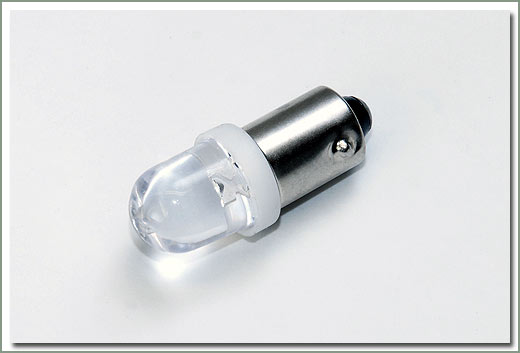

Thanks for the link. Does anyone know if they're actually brighter, or are they just replacements?

I bought those lights from SOR. I was a little dissappointed. i thought they would make a huge difference. They were only a little brighter.....

So it bolts right up? Seweet! And you like them, too. I'll have to look into that, Thank You!
The main thing you have to worry about with LED replacements is sometimes the base will match but the bulb will be longer or shaped differently. In tight spaces like the instrument cluster there might not be space for the LED bulb. (That was the case on using LED in the dash of my datsun 280z.) But is nuclearlemon has already figured that out, I'm sure you are good to go.
(The other things with LED is if you change out the turn signal bulbs, it screws with the speed of flashing since older flashers used the current draw of the circuit, and the LEDs draw very little current.)

Has anyone tried these LED lights from SOR. I have not pulled my instrument cluster to see if they are the same as the 40 bulbs. I just purchased the replacement instrument panel and was going to clean everything up and see if I could get a bit more light since it is my daily driver.

are u sure there the BAYONET style twist LOCk or and NOT a T-10 wedge style peanut bulb ?

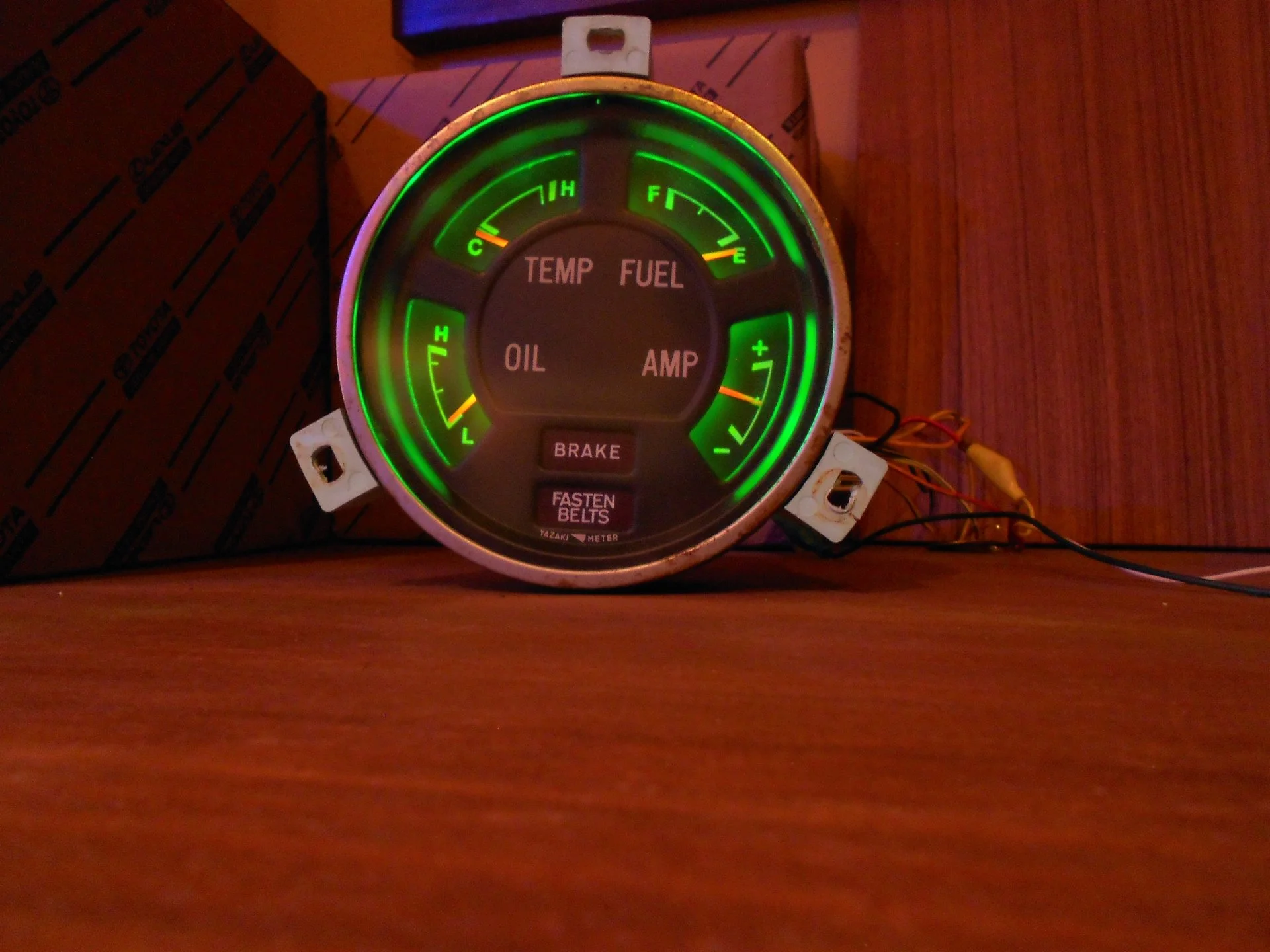

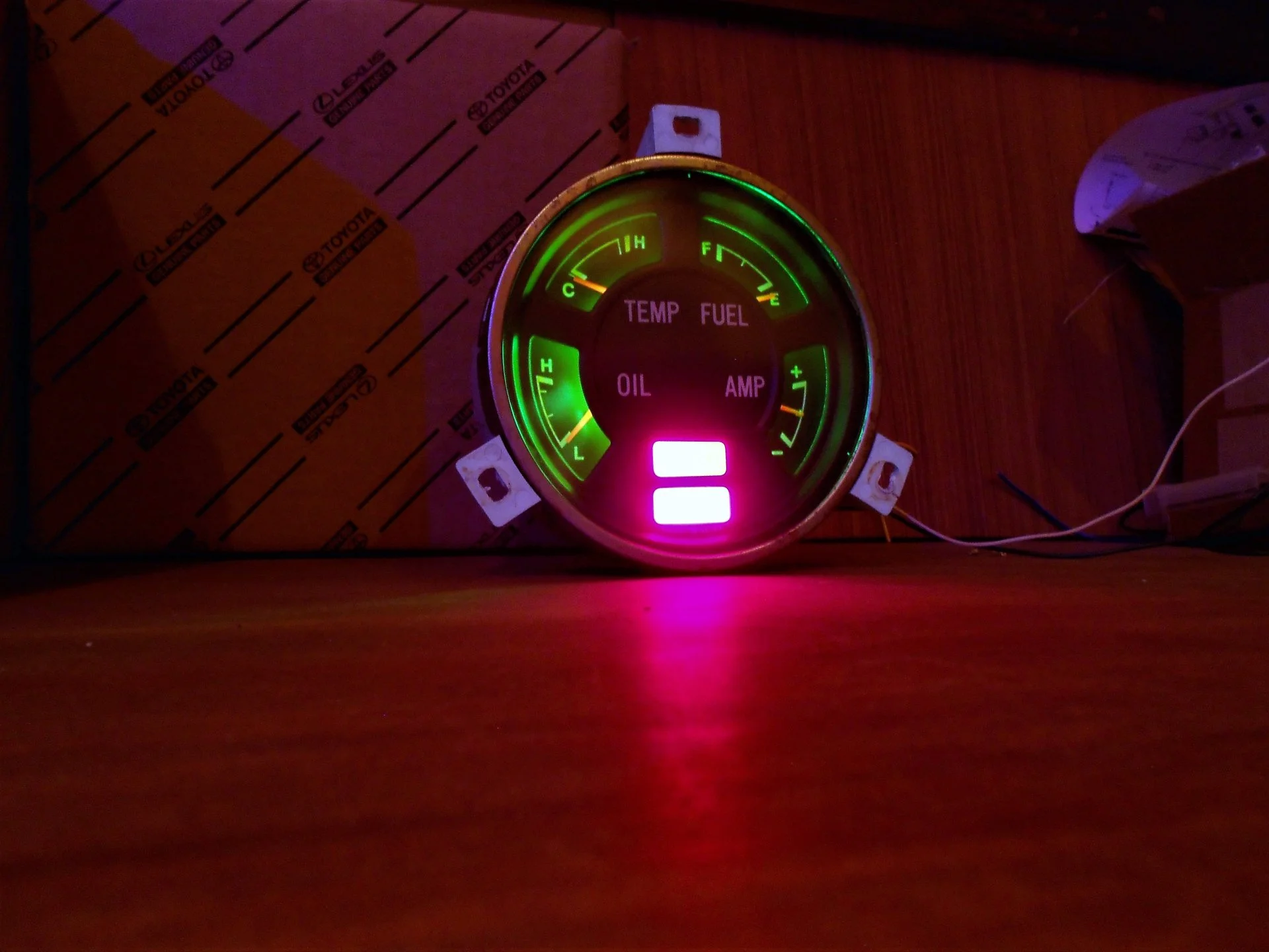

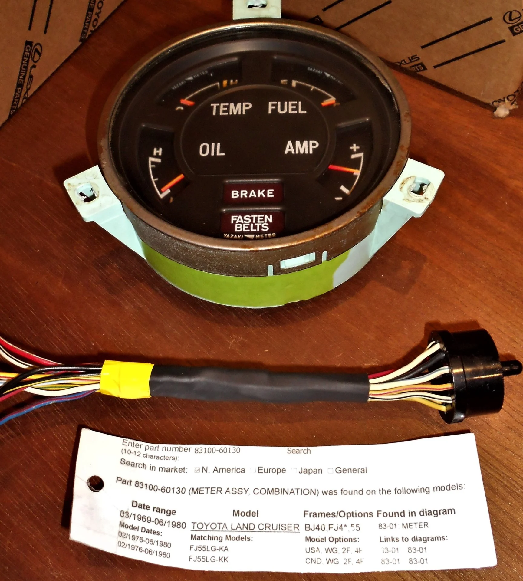

i have updated several FJ55 Cluster meters over the last 2 years or so ,
in addition to simply adding / updating to LED bulbs , you absolutely want to consider a LIGHTS Shades Modification , this will change your nightime driving experience for the rest of your life for the better !
here are a few examples of my past 55 work and include ALL the lightshades Modifications too
