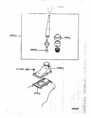

ok here is the diagram the guy at the dealership faxed over. i hate dealerships but its the closet place to get the part, about 90 miles. :bang: (again i just like the smiley)
the part the dealership thinks i need is the #33548F.
Nope, that is not the shifter seat, that is the small bushing at the end of the shifter. I would go ahead and replace it, but I don't think that will help anything. The part you want is actually not shown in that diagram, they might not sell it seperately for your 2WD tranny.
Call Marlin Crawler, tell him what you have, I would bet that his new HD Shifter Seat will work:

X2. Got mine from Marlin and it helped a lot on my 85 4Runner. While I was at it, I also replaced the small bushing at the end. Got both from Marlin. Wasn't real expensive while I had it all open.
