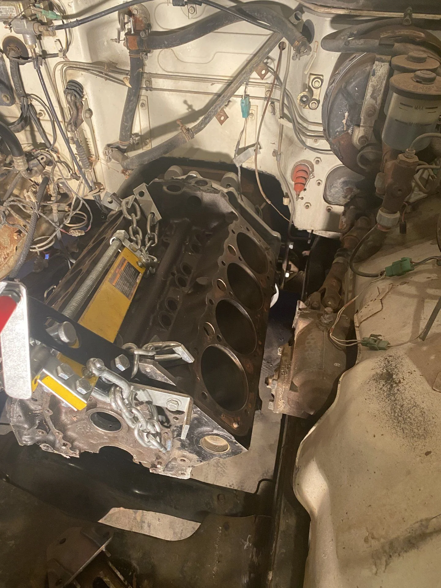

I’ve been working on plugging the 350 in the ol girl this week. I’ve got an extra bare 350 block I’m using for fit. I’ve got the marks adapter kit, which seemed like it was going to make everything simple!
Some problems I’m having:
1) the kit only came with one bell housing mount and I don’t have the originals. Should I make one? Will one be fine?
2) the motor is seeming to sit really close the driver side. The steering box is also very very close and I don’t see the complete motor fitting very well.
I haven’t tacked in the new motor mounts yet, I haven’t felt confident with placement yet. This is my first swap/engine build/ land cruiser. I want to make sure everything is done properly so I don’t have to do it again!
thanks for any help
chris

You want the motor as far as it will go towards the pass. side for the p/s pump fitment as Lil' John said, but make sure you have room for the a/c compressor on the pass. side. Also pick out your exhaust manifolds/headers before welding in your mounts. Block huggers work well, but some manifolds dump right out on the frame, no good.

I’ll get the motor as close to the passenger side as possible. I enjoy the process, so I’m just going to keep moving and tackle the issues as they come. It seems that I’m on the right track and I’ve got a full day of daylight to work with today.

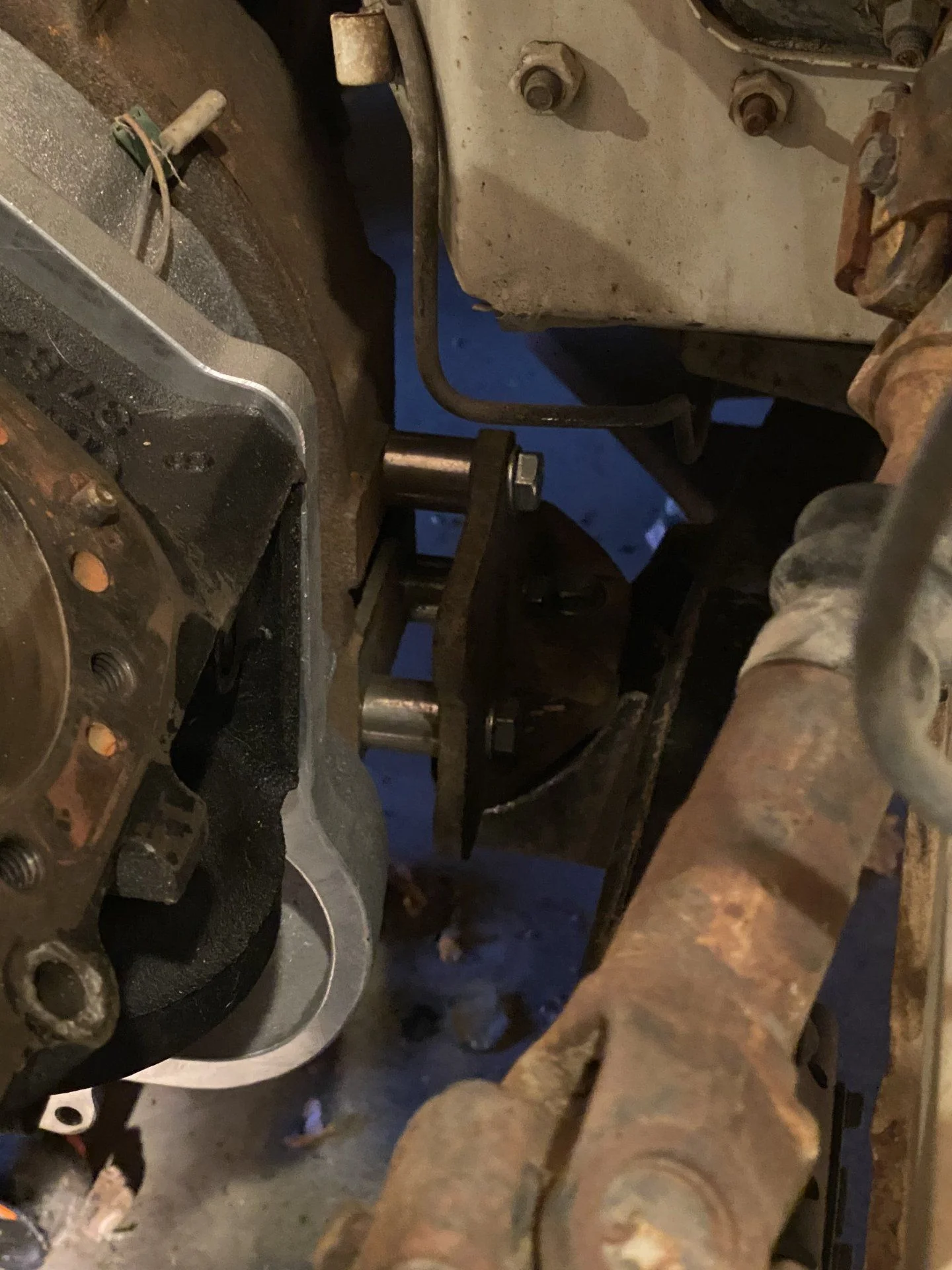

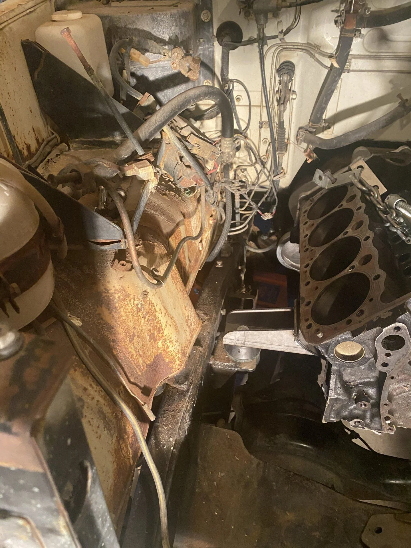

This was once someone’s project about 40 years ago, so I come across all sorts of exciting things. Here’s where I’m at so far:
Bell housing mounts are in, adapter is bolted to bellhousing. Clutch slave cylinder has been rebuilt, master cylinder cleaned, throw out bearing adjusted per the instructions. Motor face to clutch fingers (81 or 82mm) measurement -8mm for throw out bearing adapter engine face. I put a block in to get mounts lined up and tacked in and it appears to be pointing towards driver side. All I can think is that the passenger bellhousing mount is preventing the whole assembly from going towards the passenger side.
Anyone out there have any input? Or suggestions?
Your pass mount looks really long. IIRC my sbc was pretty much in the center of the bay. The SBC swap was before my time but they did not use the transmission mounts.
I'm not sure about those bellhousing mounts, either. I didn't use those in my FJ40. Front mounts and a batwing or some other type transmission mount. If you got rid of the bellhousing mount, couldn't the motor be positioned correctly in the bay? You want to get the motor as high as you can, also. With only a short block you won't know where to set the mounts. I'd think about using the whole motor, etc. to get the whole picture of where things will be, then weld them in. Where it's setting now, I don't believe you'll come close to bolting on the power steering pump without hitting the steering box.
When I done my swap I bolted the motor mounts and frame mounts to the fully assembled block and sit the motor were I wanted it to sit then tacked my new frame mounts in place.
I’m using the Mark’s adapter and I had assumed the bellhousing would mount into the existing frame mounts.
I think I’ll go the route of removing the frame mounts, putting th complete motor in getting it where it needs to be and tacking all mounts into place.

I’m going with nvrlose54’s advice. It will be the most straight forward. I removed the bellhousing mounts from the frame this afternoon. I’m going to weld them to plates so that I can get them put on the frame nice and clean. Welder is out of gas, so she’s parked until tomorrow!
