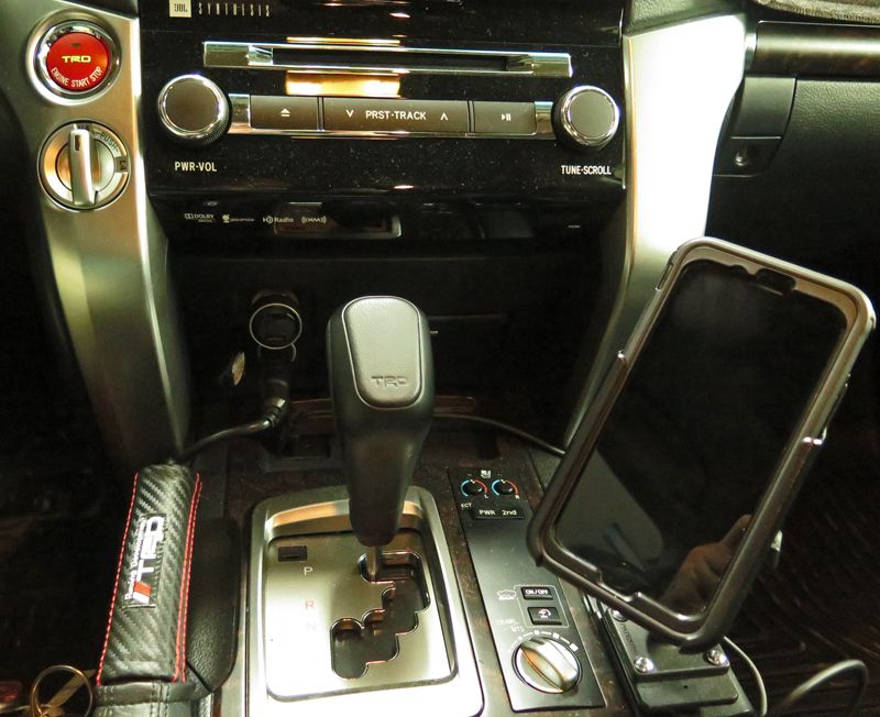

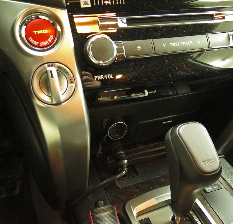

Sure! Here's a 3-Fer in my 2013LC (TRD Start/Stop Button, TRD Shift Knob and TRD Carbon Fiber Emergency Brake Handle Cover) - total HP gain by Butt Dyno = 75HP:
Another angle on the Start Button and Shift Knob:

Oh dear...
I got one, and noticed that when shifting out of Park, the TRD shifter hits the silver bezel around the shift plate.
So I removed it, anyone want it for $70 to your door? Brand new, I can return it, but it’s easier ship off than return it to the dealer I got it from.
