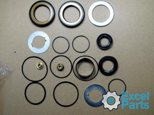

I don’t know why I’m looking for on the seals is it possible you could advise on part number or what they look like please?

Could this be the fix?
