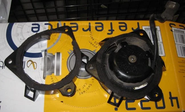

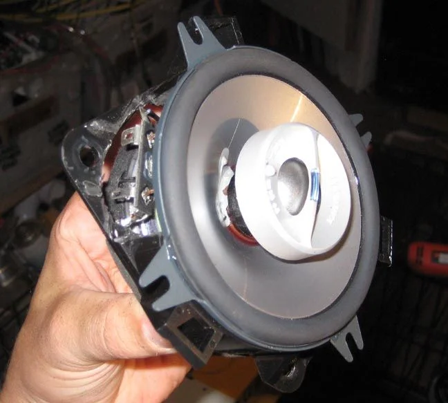

Sunday I installed the 4022i's in the rear doors of my 93. I follwed Romer's points above and have the following comments:
:) I used a dremel guide point rotary bit to cut out the guts of the plastic bracket. Worked great (plastic shavings everywhere!).
:cool: I had to cut out some metal to enlarge the door hole. I used the Dermel cutting disk.
:cool: I was able to do all this without remoing the door panel.
:frown: I did remove the crosspieces inside the stock grill but it still will not snap on properly. I see my options as trimming the bracket further to get a better fit (lots of work and I'd hate to damage the plastic bracket) or getting or making some kind of trim ring to put behind the infinity grille as a spacer. Ken - was this an issue for you?
:frown: I could not get the for mounting tabs of the speaker to in any way line up where at least one of them was not blocking the grille clip holes. Solution: I removed one speaker mounting tab.
:doh: Sounds good but not profoundly better. I probably need to spend some more time setting up the head unit.
FYI - head unit is Alpine CDA-7894 and I'm also running a 10" Kenwood subwoofer in a sealed enclosure (part of my storage drawers) off a 300W mono Blaupunkt amp.

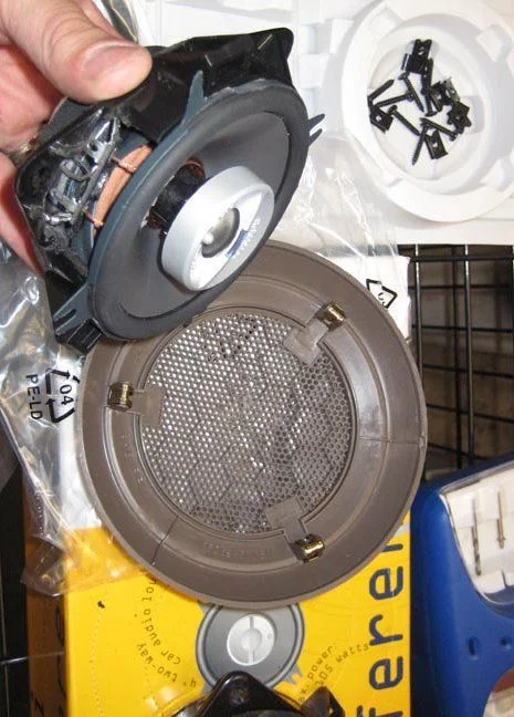

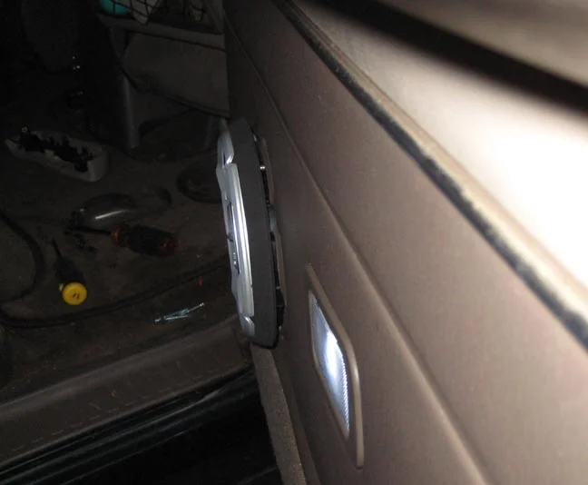

Ok, I don't have the speaker grill cross member, and my grills don't fit. Any thoughts there Romer? It's obvious my new speakers are smashing into the grills before it can clip in.. I"ll post up a couple pics in a sec.
Sorry buddy, worked on a Lexus:D
I was going to try and find a slim round piece of plastic, kindof like a spacer or O ring between the door and the speaker grille to increase the distance from the speaker grill cover and the door. You happen to know anyone who can make special design stuff like that:rolleyes:

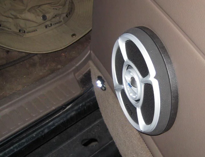

the focus is bad, but still obvious what's going on.. one of the three speaker grill tabs will snap in, but nfw the other two are even coming close. Guess I have to run the Infinity covers?
Daniel how'd you get yours to work?
Those pics look like mine exactly. Did you try carefully pushing on the mesh to make more room?
Is there some room to shave down the top of the plastic bracket so the speaker goes in a little deaper?
I guess you guys are going for the OEM look, but why? Not hatin', just asking. I think along with the lift, racks, bumpers, sliders, winches and other accessories that are cleanly installed, but not OEM; why not go with the infinity speaker grills? show off the upgrade?

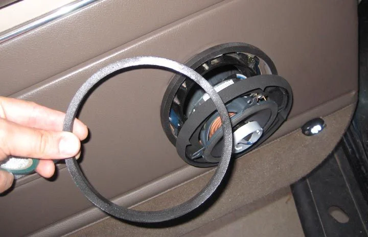

Ugh... because this looks like total crap. I tried to use one of the plastic nutzerts and the speaker is now twisted CCW about 5°. I can live with that.. and could always remount it straight. But what's worse is there's a huge gap behind it now, that would have been covered by the stock grill, had it fit.
this sucks, I should have got the Pioneers... so I guess either Q needs to come over and show me some magic trick, or I need to fab up something that mates the speaker with the stock grill. Or, at least fab up a spacer to fill the gap. :mad:

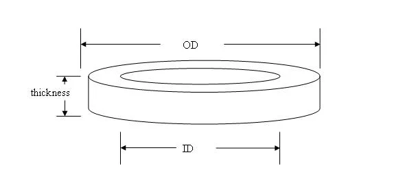

Sorry Ken, do you have a gap in front where you had to use the stock grills? Yes I can make you a spacer, just tell me the OD, ID, and thickness you want and I'll bang them out. Here's quick sketch in case that's not obvious.. sorry for the WordCAD but it's late.. :rolleyes: I'll end up making a set of these for the back if I can't figure out the stockers.. this will all have to wait until next week though, kinda got a big weekend ahead.

I have an idea of how to carve away at the stock bracket to seat the speaker deeper and hence use the stock grille. First need to determine how much clearance between the window glass and the magnet there is....

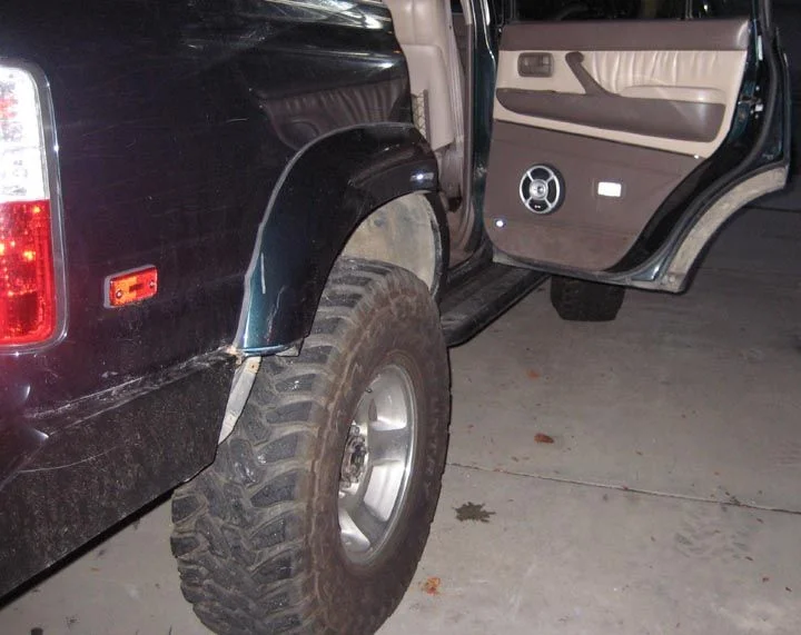

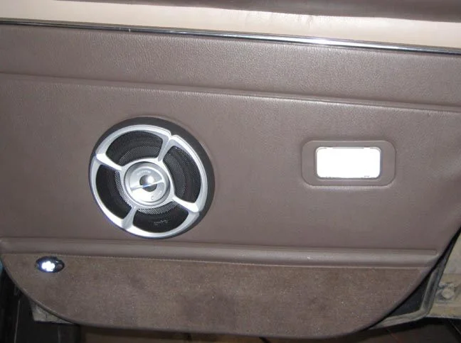

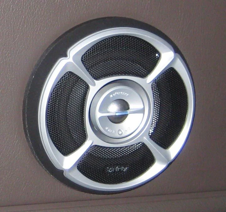

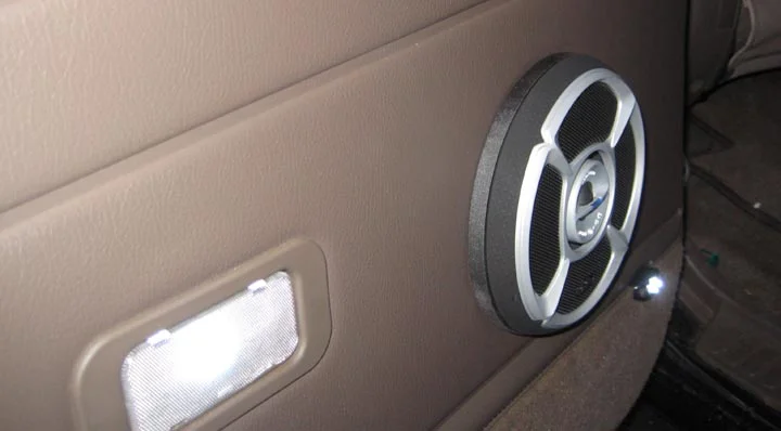

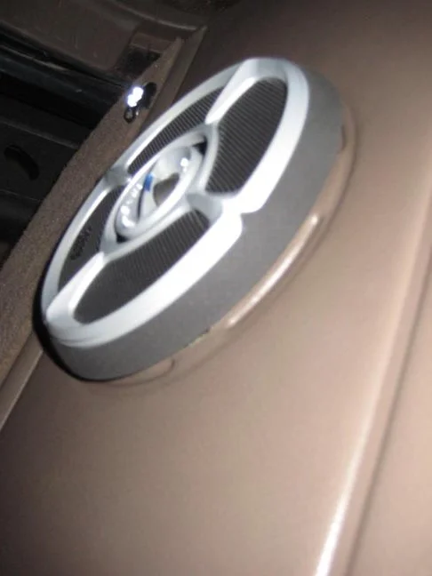

Ok, I got my spacers made and they fit up as expected. Got the passenger side aligned straight, this is as good as this is going to get. The consensus among the club now is that LX speaker grills are deeper, because LX's came with superior speakers from the factory.. so far we've only got a couple data points to prove this, but it seems to be a pretty workable theory at this point. question to anyone else out there...
-Who with a non-LX has got the Infinity speakers to fit in the rear and managed to use the stock grills?
I am now on the lookout for an LX being parted out, would like to pick up an extra set of grills on the cheap. I'm going to try to borrow Romer's some time as well when he's not looking just to prove the theory in the mean time. :D Ok here are your pics:
the sound quality is improved now that the rear speakers are somewhat enclosed. These still sound kind of crappy though compared to the new Pioneers in front, the Pioneers have much more depth to them.. Once mixed together the two do sound pretty decent though.
couple more pics..
