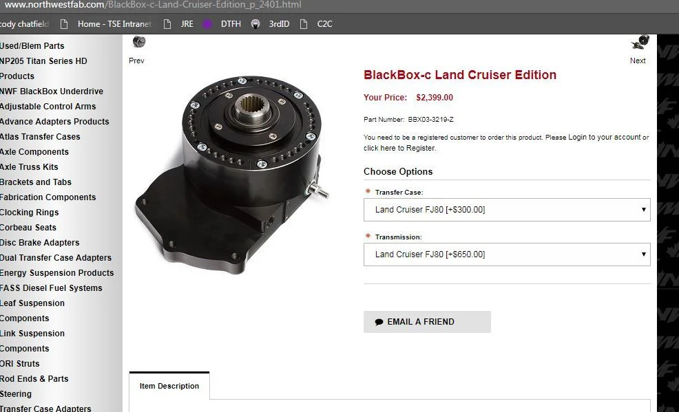

I sent an email to ask if they would sell the doubler (ecobox or blackbox) with the adapter for the HF2A, and if we could order a "blank" input shaft with it, to get it cut/broached elsewhere to fit, also if they would sell the trans adapater.

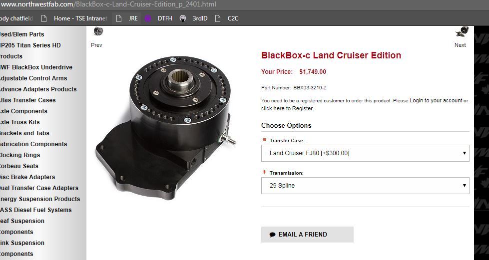

I guess this is the final option, from NWF (Kris):
"Right Now we can do Domestic Transmissions to 80 Series Transfer Case, 60 Series Transmissions to 80 Series Transfer Case, Domestic Transmissions to 60 Series Split Case and 60 Series Transmissions to 60 Series Split Case. "
So you can run a doubler and split case or HF2A. But you have to put a domestic trans in front of it.
