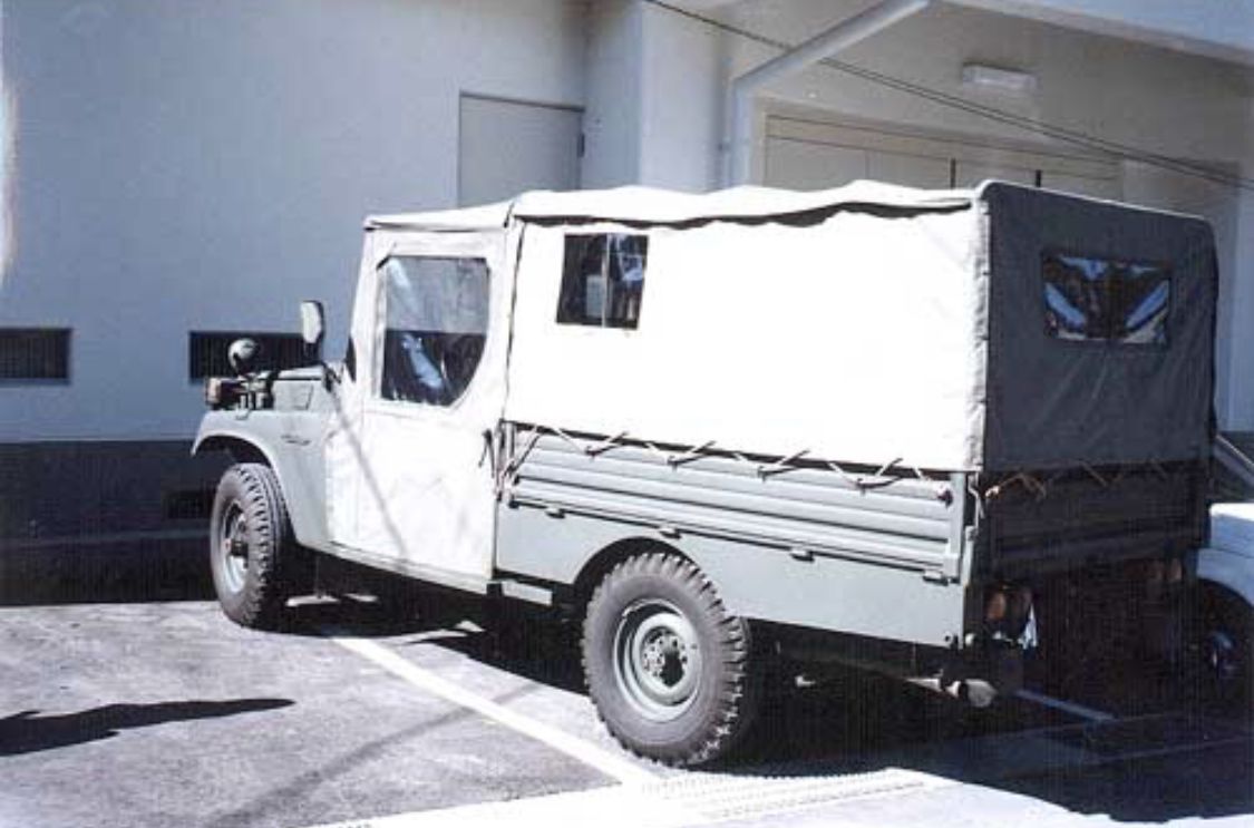

The year is 1968. Toyota’s release of the FJ55 in the American markets had mixed results. However, the Land Cruiser design team and heads of sales felt strongly enough about their new direction to convince Toyota’s corporate board to drop the 40 series entirely and push forward with the new 50 series. In order to satisfy the demands of world markets, the design team was challenged with the task of recreating their internationally recognized vehicles with their new design changes. The factories also needed to upgrade their facilities to include the additional tooling required to make changes required for short customized production runs for military and governmental needs.
The design team needs your help finalizing the details of the design crossover, as well as their respective numerical designations.
One of the Toyota guys says, "Hey, should we try out this new-fangled rust proofing stuff we keep hearing about?"

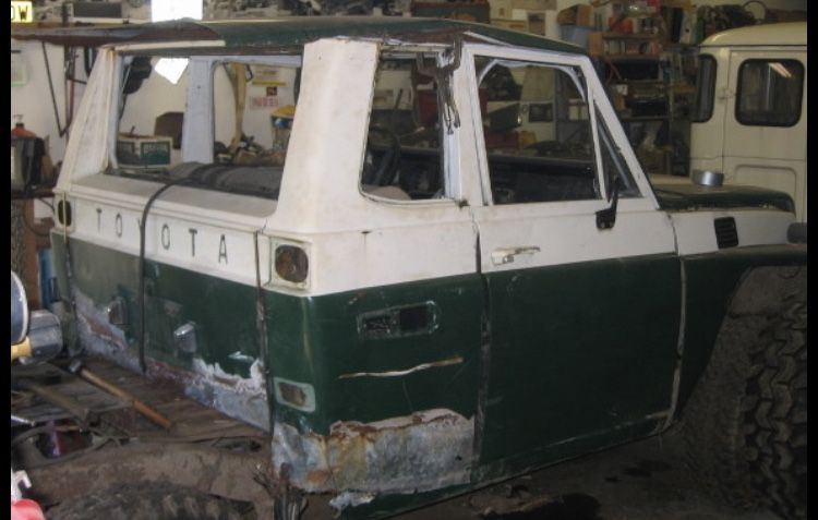

SECOND RIG IS A PHOTOCHOP... DERN GOODUN, TOO...if you chopped the B-Pillars as close, youd have less headroon behind the seat than youd need to not bump a hole thru the back of your head going down a smooth street... Mine has more B-pillar, and it's still too close. Another 3" is my minimum if I ever did another one... look at the 70 series real close... their doors are longer, and the floorpan is lower so you can really sit in them... Tellin ya, you could have mine... shameless plug- OVER///
I like it! Kinda elcamino, but also quite piggy... not a lot of work to divorce the bed from the cab... I could see it looking really good. If I may, give yourself more room behind that b pillar than you think “looks” right.... sit in it a while;)

This cab here approaches what I’m envisioning, by using the back end of the tub, roof, and tailgate to round off the back of the cab. The space behind the B-pillar is a little awkward. Fill it with glass? Better visibility that way, rather than fill it with steel. Also think I’d shrink up the width of the flat on the upper tailgate and the angle of the back pillars to suck it in a few inches and give it a little more of a vertical angle.
Need to tag @gofast into these great pigup shots...
I think you would want glass behind the B pillar. It is pretty crazy how far back that front seat goes behind the B pillar.
