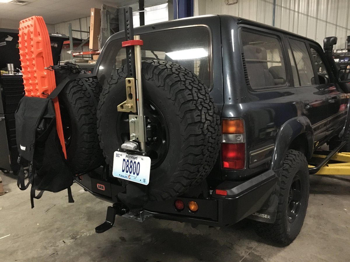

Was going to use this: https://www.maxtrax.com.au/product/maxtrax-rear-wheel-harness/
So it would outside the wheel. I'll have to check if there's space on the inside - I think the two maxtrax stacked would be too wide.
I won't be able to use the trasharoo anymore, so maybe I'll use this as an excuse to get a roof rack!

Was going to use this: MAXTRAX Rear Wheel Harness - MAXTRAX
A Trasharoo will still fit with the Maxtrax mounted to their wheel harness. It's a little more important to make sure the Trasharoo straps stay tight, but it does work. Couple pics below from a quick Googling:
But, that doesn't mean you can't still get a roof rack.;)
