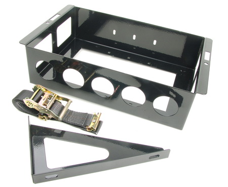

Picked up a Slee jerry can carrier:
As with all Slee stuff, it's high quality. The strap system is very nice. I just need to pick up one more can

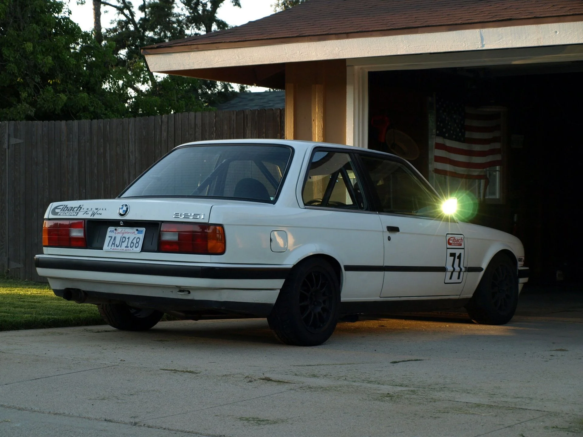

Thanks man! I've been spending a lot of time with the cruiser but finally got around to pulling the E30 out of winter storage today -
Wish it was an M3 so I could one day make some money off it.. haha oh well.
Where did you pick up the ratchet straps..need something that hefty
Yeah it's nice. Came with the jerry can carrier from Slee - must be a proprietary thing cause instead of hooks it has attachments to mount to the slots on each side of the basket.
is that a flocked dash on the e30? digging that. Wish I would have done that on my e30.
here she is a few years ago. she was slow but she handled so well on that track.
Very cool. I've been debating a roll bar in mine. Still have your car?
Yeah, it's a flocked dash. Really happy with how it turned out. My dash was super nasty and cracked
Naw long gone. two kids later I had to give track cars a break. that's actually when I turned to off road camping. now I can carry my family around in my money pit haha.
