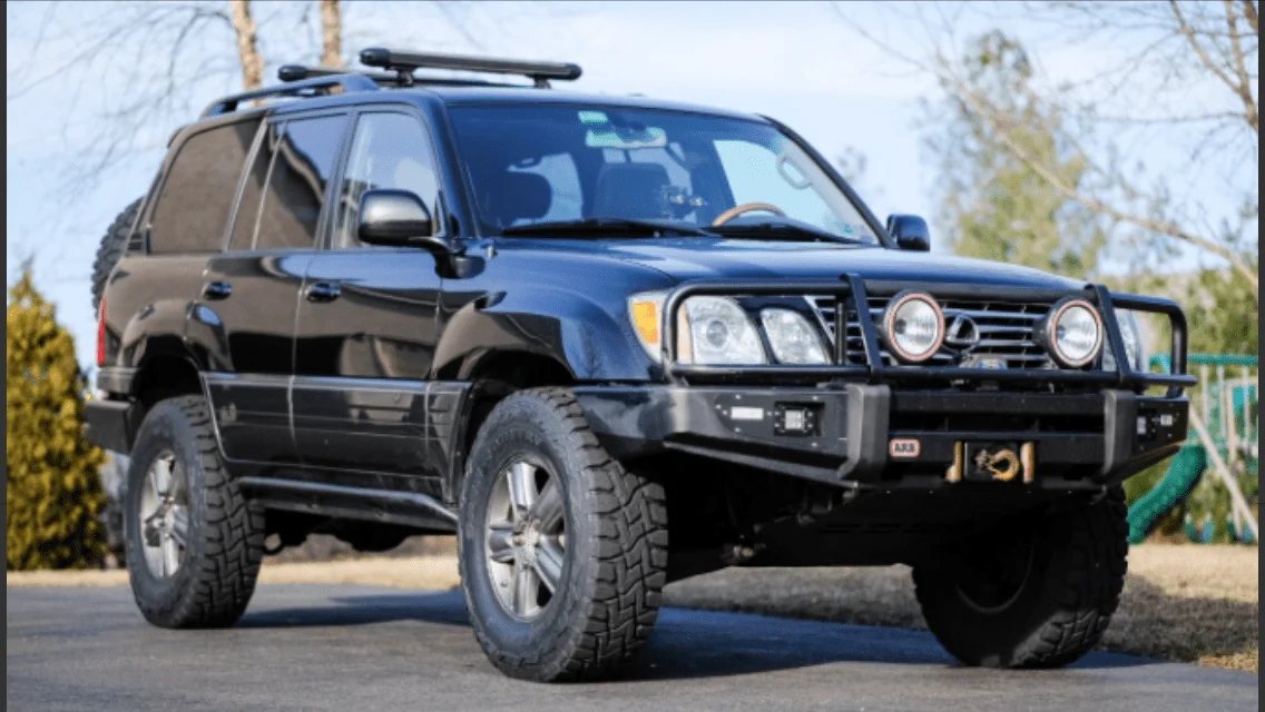

Got the Slee sliders installed today:
Easy enough to do by yourself, just need some jackstands and a jack.
Ran into a couple minor problems - had to cut off an AHC stud and bend an AHC bracket out of the way. The bolt was rounded off and impossible to reach, so I just had to leave it.
I realize now that maybe I should have talked to Slee and asked if the LC non AHC sliders would have any problem fitting on an LX. The feet mounted just fine since my AHC is gone, but LXs have the body cladding/body trim around the rockers. Seems to add about a half inch of material:
I was able to get the sliders to fit but they're touching the trim up front. That's just plastic, and it's hollow underneath, so I'm hoping it won't rattle or anything. I took it on a quick test drive and didn't hear anything. I could have dremeled some clearance I guess, but then I'd have a hole for water and debris to get into and stay there.. we'll see how this goes. Should be fine
Other than that, the fitment and build quality is amazing. I'm always impressed by Slee stuff.

Couple of things,
1. For purely esthetic reasons alone I like the high clearance slider choice you made - very stealth looking and keeps the height
2. Those are cool jack stands - seem to allow way more room to get yourself under there to wrench vs the traditional 4 legged base stand
3. To provide you with peace of mind that you made the right decision on slider choice (TLC vs AHC) I've attached 2 pics of another members rig I had the opportunity to see and drive. He has AHC and therefore the AHC sliders. Note your area of cladding protrusion concern - exact same results as yours.
As always, you make quick work of your installs.
The local shop that made mine, terminated the step hoops a tad shorter than Slee's, just for ref on the cladding interference. Your's look great.

Installed Trail Tailor recovery points with the ARB spacers. Used 10.9 grade 14x1.5 - 60mm bolts from Bolt Depot.

back to your recovery points...did your bumper come with those arb spacers? I don't think mine did. I'm literally looking to do the same setup on my 03 arb bumper.
Jason at Trail Tailor sells them. He makes them I believe.
Yeah both the recovery points and the spacers are from Trail Tailor. You need them for your shackles to clear the box around the bolts on the arb.
