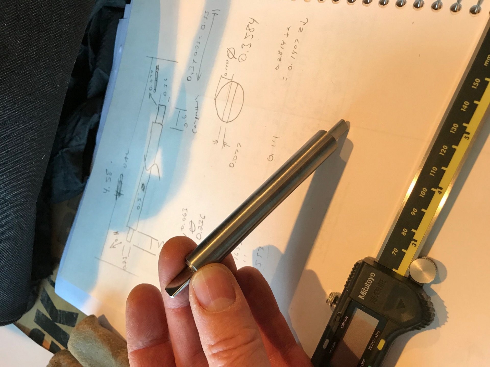

thanks for the measurement , it definitely makes it easier.
That looks much nicer than mine. Pretty sure I wasn't holding four decimal place tolerance with the belt sander! Nicely done!

I'd be lying if I say I made it myself.
I got lucky to know someone that loves doing cnc stuff, he made one for me
I have shown him so this thread , I got 20 or so messages looking to make this. but he is not interested unfortunately.
Could you post the dimensions?
