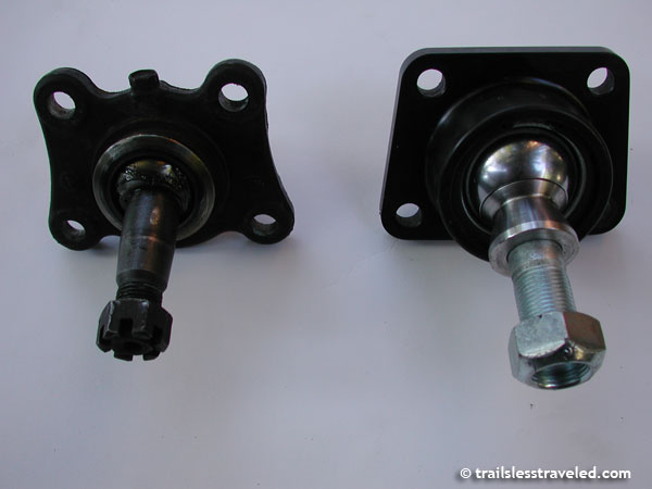

T100 ball joint
LC100 ball joint pic WANTED ..

Do you think it would be possible to cut the 100 ball joint out and replace it with the T100 bolt in ball joint including the spacer, and not bind up, and make some gain?
ats4x4dotcom mention that ..
Spacers would be ok, as long as the up travel was limited so the ball joint didnt bind on up travel.
think about it like that .. buy the Uniball kit .. bolt it on .. and make the Arm around it .. easy as it look .. and easier if not you how will do the job :D .. seriously i may have a hard time to find the right shop .. but if i were in USA .. with the all skills and fabrication shop .. its a matter of time and couple hundred of bucks .. some body have to move his @ss :flipoff2: ..
