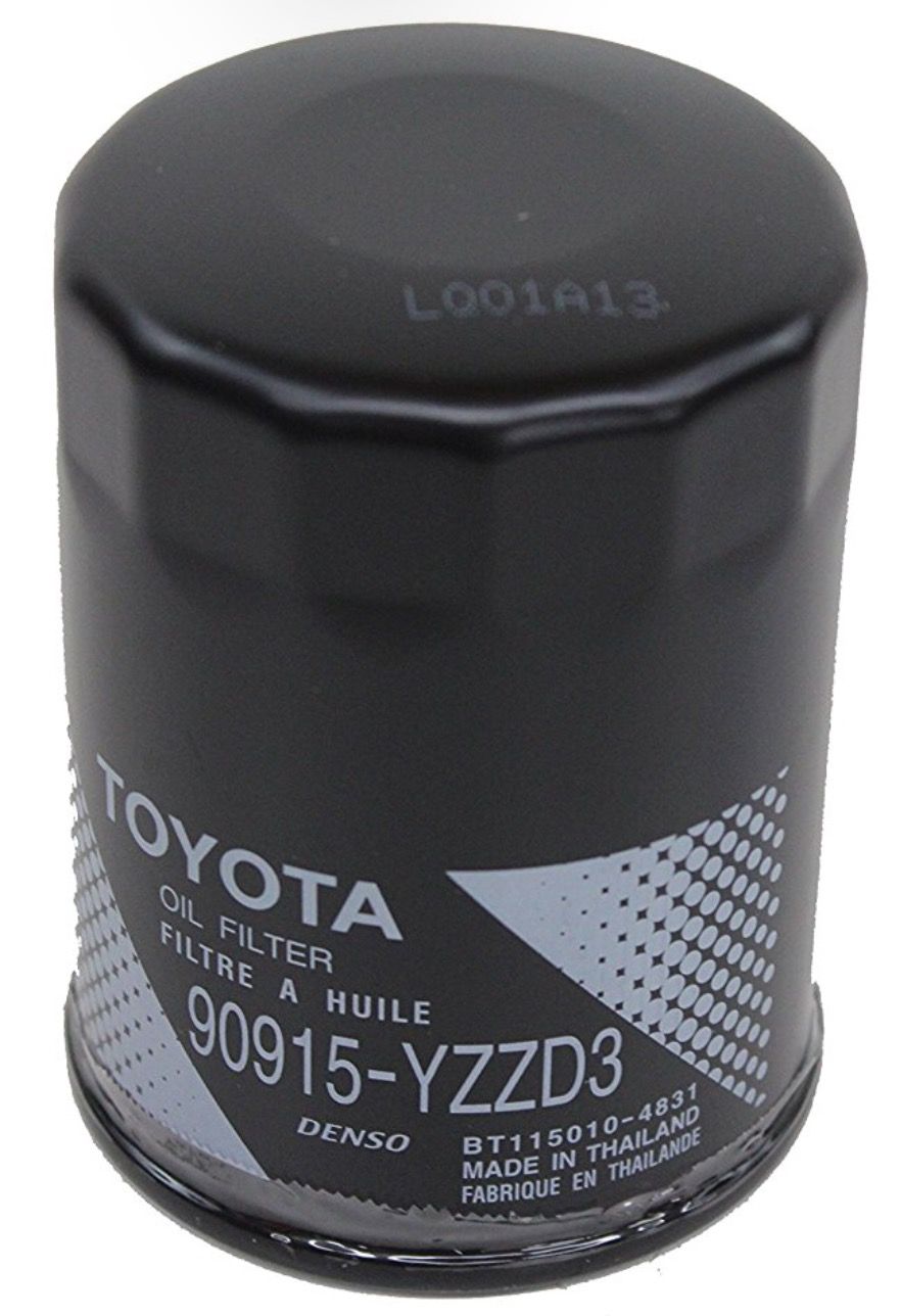

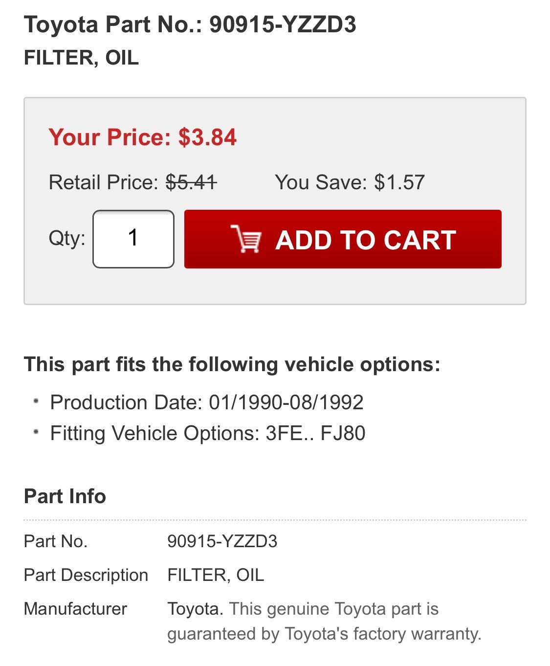

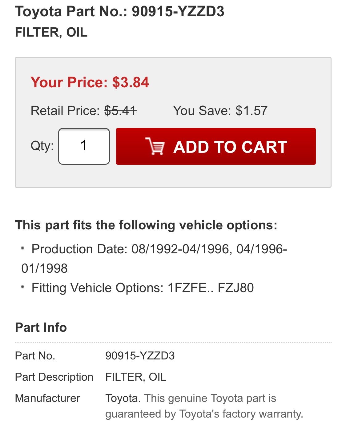

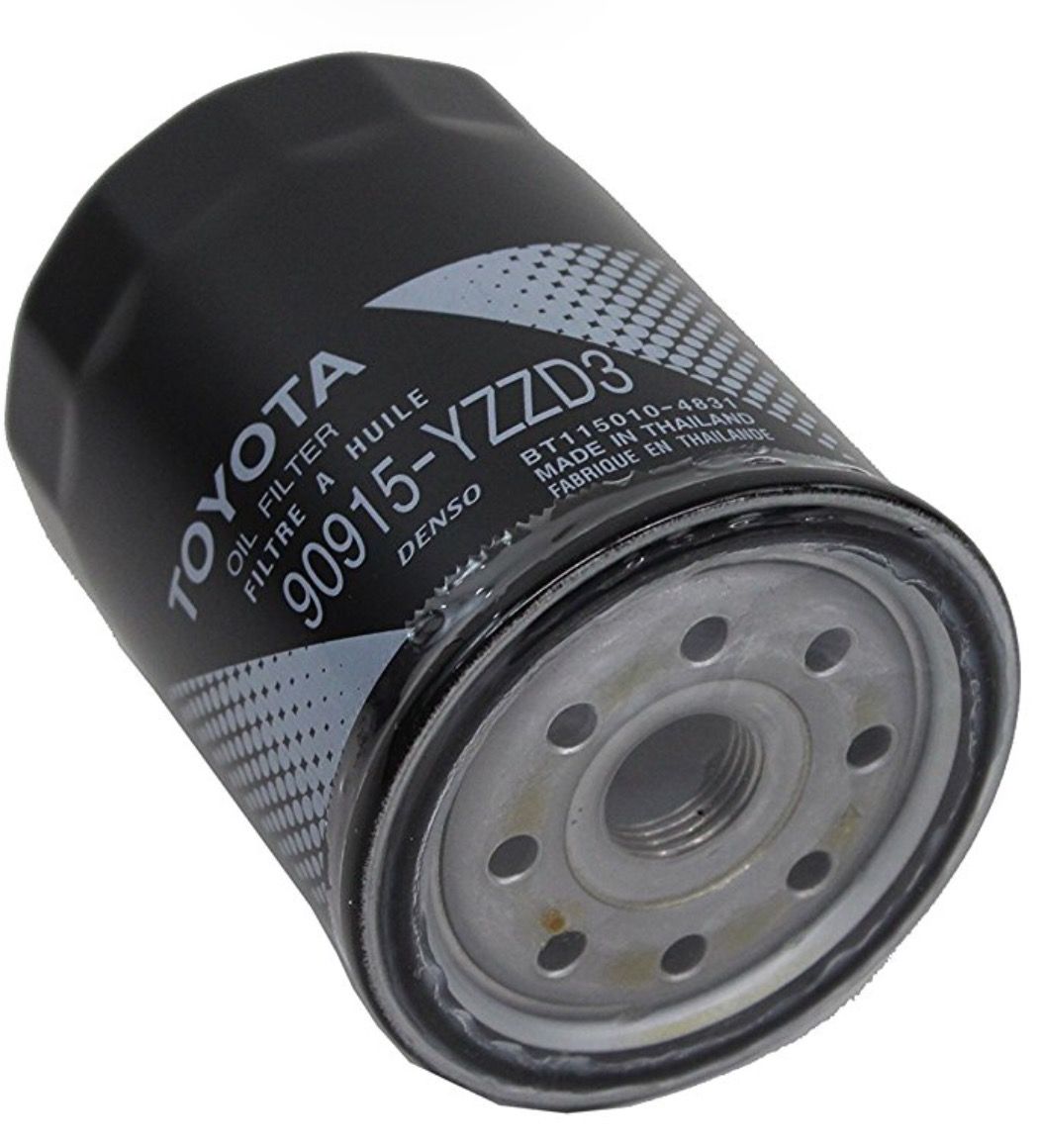

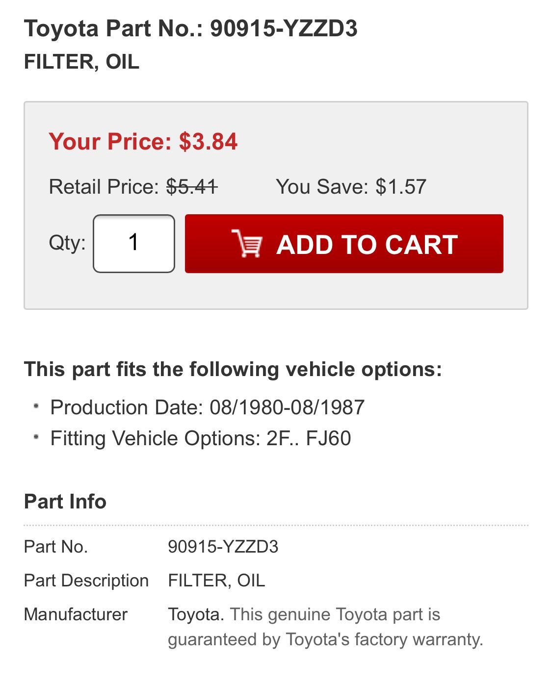

...Now I'm wondering if I should have gone with the 90915-YZZD3. I have used this filter in the past on my 80s with no issue and assumed it was the correct application for the 80 but maybe not?
...I've got a Wix sitting in the back of the truck right now waiting for oil-change'o'clock. What part# is the Toyota oil filter for the 3F-E?
The Toyota 90915-YZZD3 is the recommended oil filter for the 2F, 3F-E and 1FE-FZ
