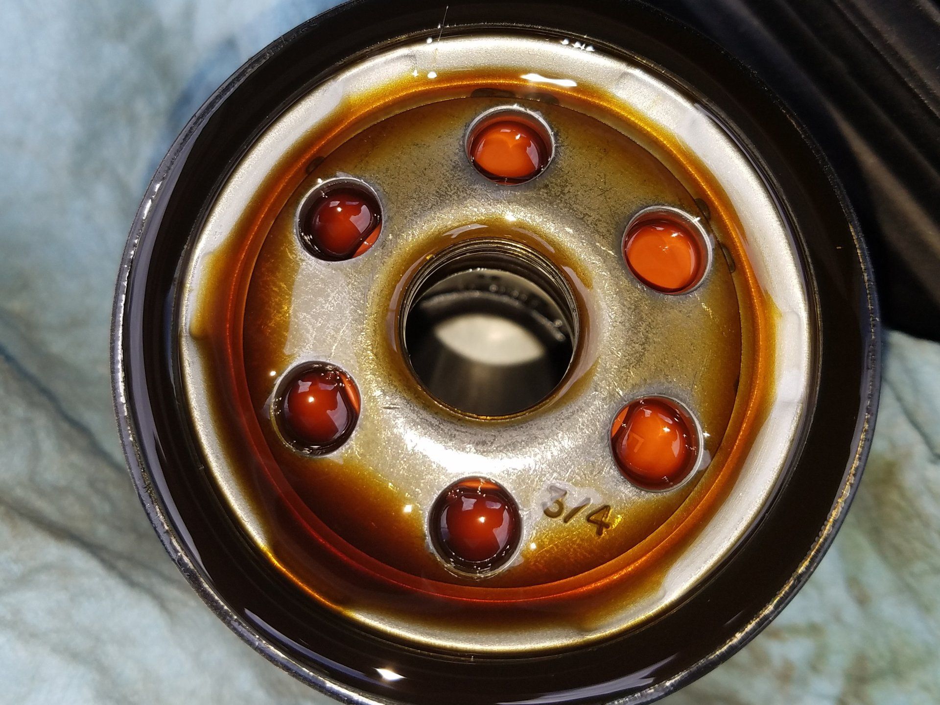

Update on my issue... (With the instruction on how to move forward from the WIX rep Scott Taylor) BTW the "rep Scott" wanted to get into an argument with me that I was using diesel motor oil in a gas engine because when he asked what I use... I told him Rotella T5 synthetic blend "diesel oil". I had to tell him that he was going down the wrong road with me if he wants to say I'm using an improper oil because it meets ALL of the manufacturers specs. At this point in our exchange I had to inform him of my work history at Ford Motor Company, and my technical degree in gas turbine engines, and more than a decade that I've worked in private and military aviation. I also made mention that I was posting my experience in this forum.
So... I took the WIX off and put the OEM/ Toyota filter (with some oil in it) on, Got in the car and turned it over... it started up and the oil pressure needle climbed to the normal range.
No need to suspect a bad oil pump, or anything wrong on my end than a truly defective filter. I don't really know how to spot a defect other than in a side by side comparison with other WIX filters mine does look different... there is visible print (see pic), and whatever the drain-back valve position should be... mine looks flipped. I've posted a pic viewing down at it here to see if anyone else sees it.
On an unfortunate side note... the howl/screech that first alerted me to something being wrong had gotten more quiet, but hasn't gone away completely and I'm still hesitant to drive the vehicle. I'm afraid the damage has been done and it's a matter of time this takes a dump :/
He wants to see pics of my progress and will give me the address to ship this to this coming Monday... To be continued... wish me luck

I wish I knew what I was actually looking at/for in that pic. Comparison pics with a Toyota Filter?
I should have taken pics of the Toyota, but I am going to stop by napa and grab an exact filter to both do comparison photos and cut the one I bought open to see if its what I think it is ( a flipped drainback valve). Anyhow, the WIX rep is coming out in person to fill out documents that show I'm surrendering my property so they can evaluate it. I told him I was uneasy with the ethical side to all of this since I can prove the fault lies with their product. I'm still uncomfortable using this vehicle and I'm going to keep it out of service till I have confirmation they're going to cover whatever the associated costs are with a rebuild. I'm still sick to my stomach his all has happened, and would almost bet that the lucas stabilizer kept this from throwing a rod.
Do not cut open that filter without the rep being with you! That’s exactly why they refused to do anything for me.
