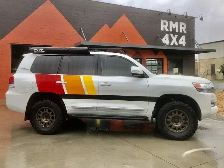

285 70 r17 k02’s or toyo at3’s on evo corse’s…they’re a bit heavier than rock warriors but I get the feeling they’re stronger…easy to repaint or powder coat in the long run too.

These are the wheels that I want for my 2019 LX but was told special order item only and will take 8 months to get! Where did you buy yours? BTW- your LC looks great!
Not mine. Just a good photo of evo corse w 285 70 r17’s I came across.
