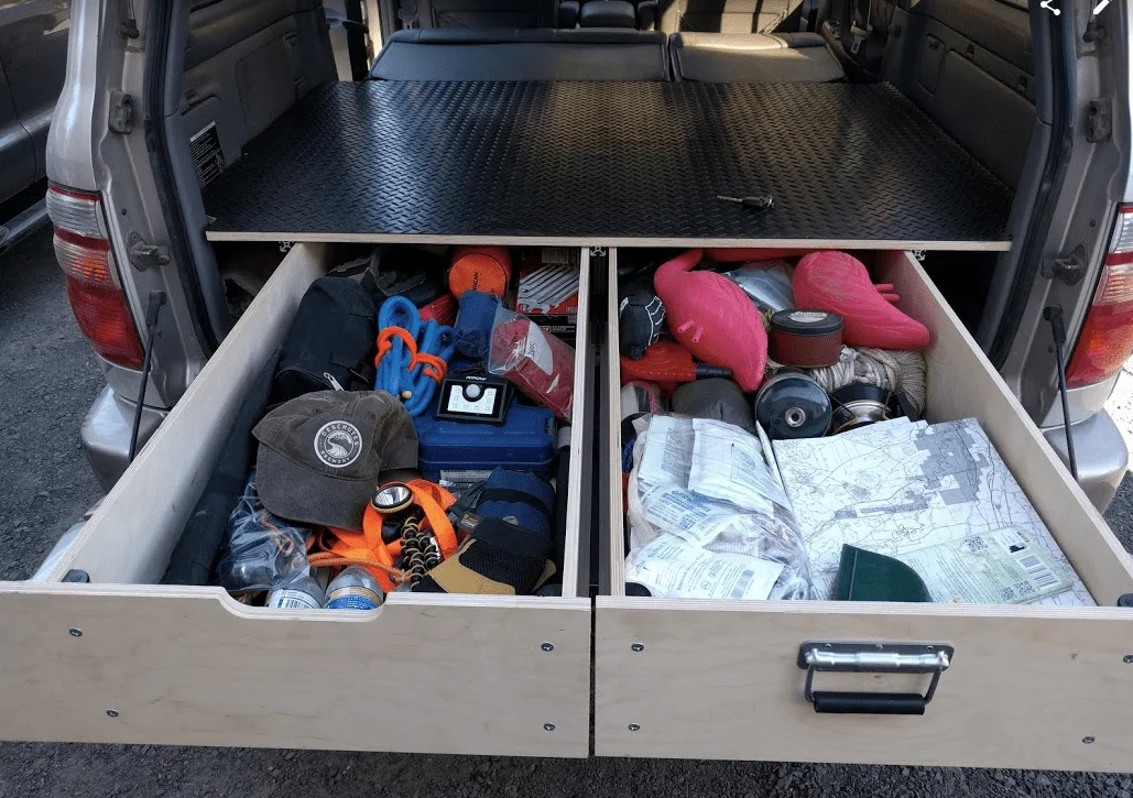

Now you see why people make/buy storage drawers... I have one dedicated to my rig & recovery, one to survival/camping gear.
Any time the fam wants to head out into the woods (or SHTF) I am ready to go!
