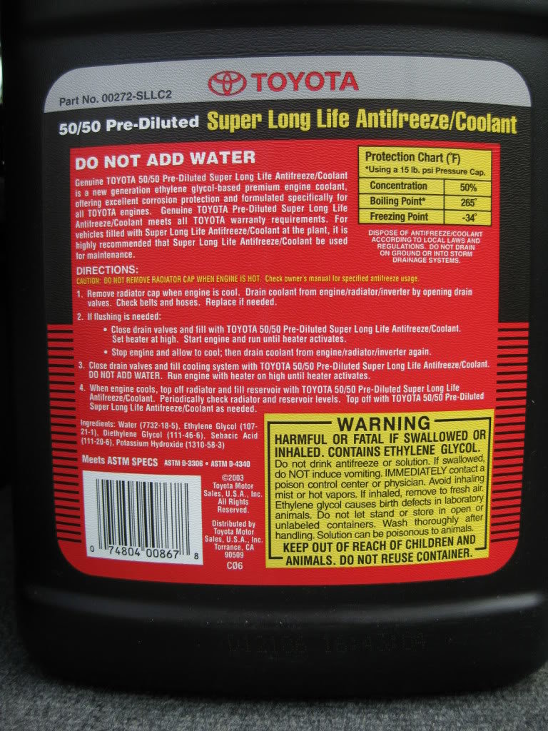

What temp does our factory coolant start to freeze at?
Pre-mixed 50/50 SLL freezing temp is -34F
I think dealers in Canada use a 70/30 mix that's -90F.
