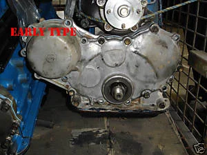

So, I found in another forum a similar topic and there it was also mentioned that pre 11/84 models had factory-made sleeves and that the two versions could be differenciated by the timing belt cover.
see here what they suggest as the two different timing belt covers. If i compare that with mine it looks pretty much that mine would be the earlier type.

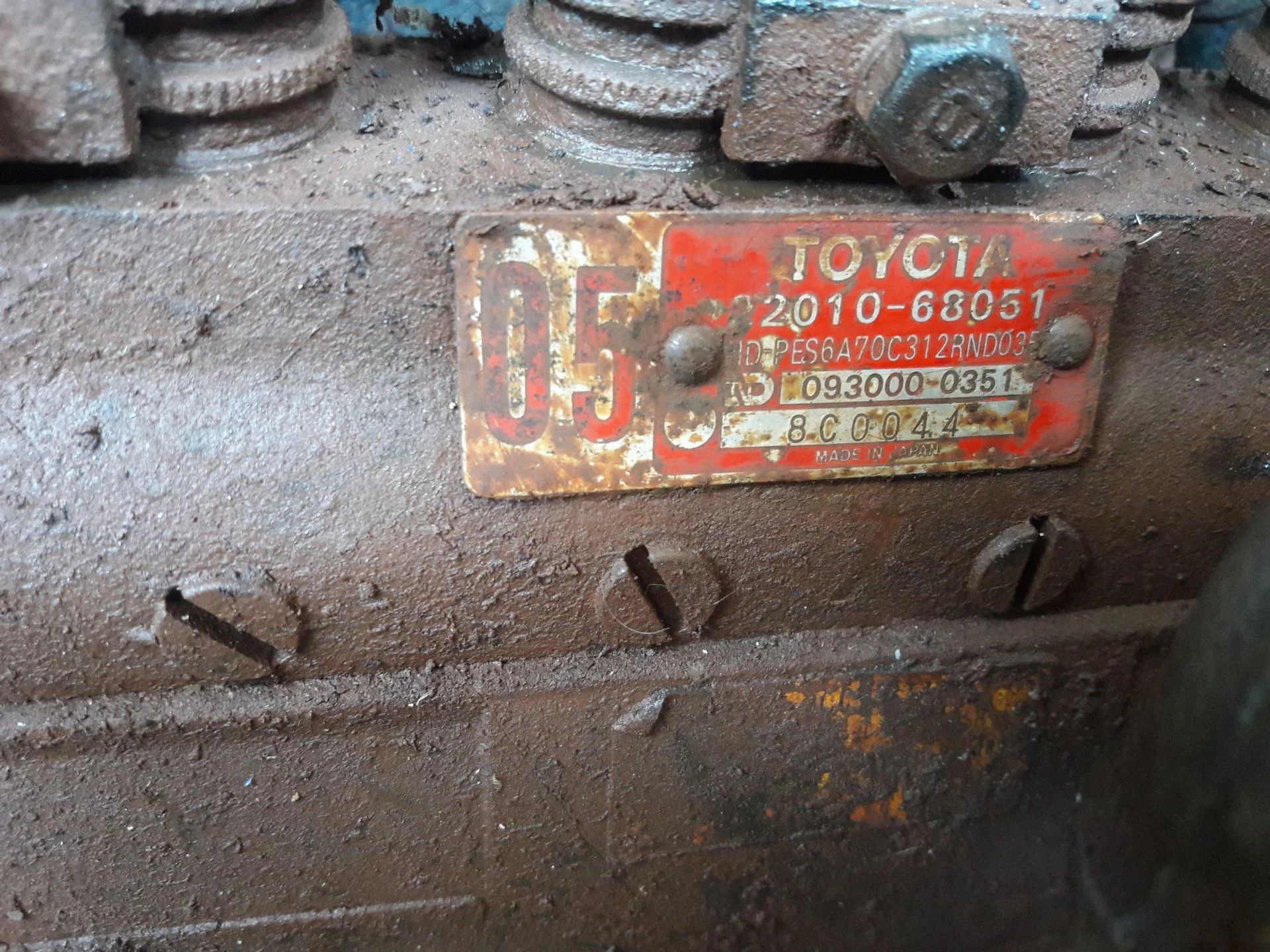

Othere way is to check the injector pump number. Late 2H pumps generally end in the 4 digits 1070 or 1080.
not seeing such a number on my plate of the injector pump.. so another hint for old type !?

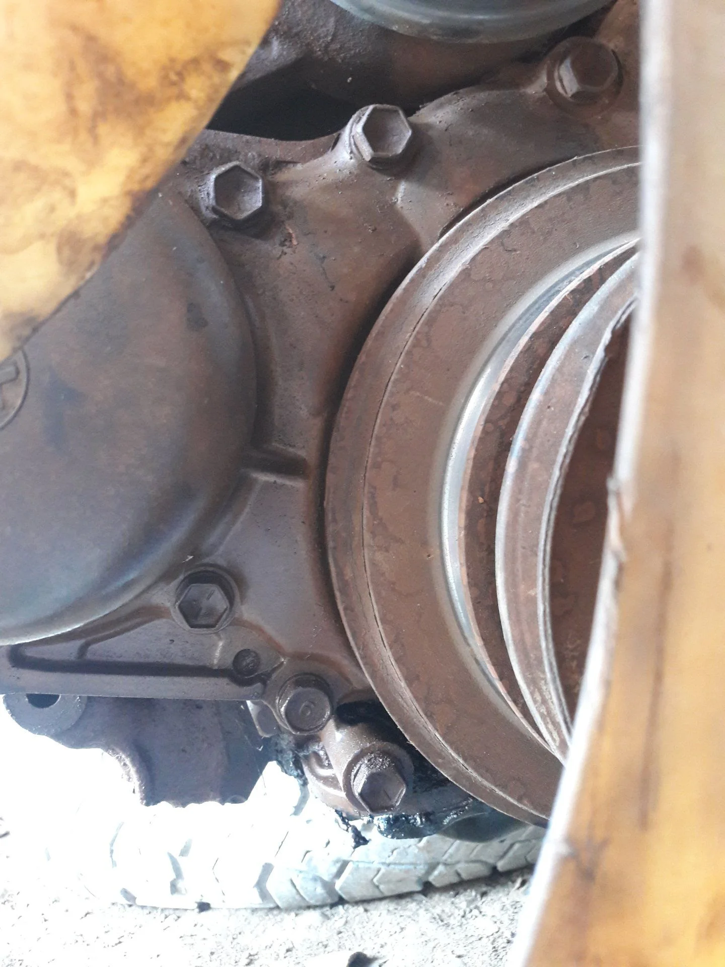

the one picture in the post before shows an excerpt of the my timing gear cover.
BTW: just checked in my 2H repair manual from 1980 (so obviously only early type).. there they really speak about liners (while it is stated that they also can be bored open and an oversize piston used).
also it shows there the same "early type" time gear cover as shown in the post above... was crosschecking with the newer 2H-manual (which includes the 12-HT) but they were not using photos anymore but drawings, so it is not as clear as in the old manual
