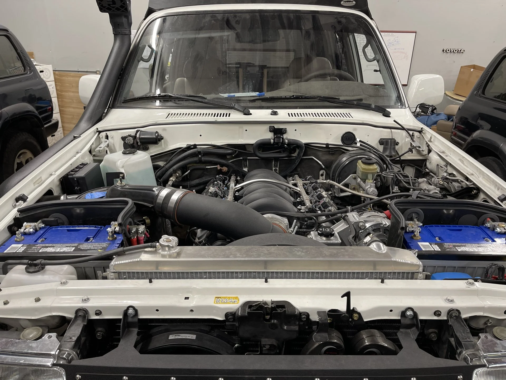

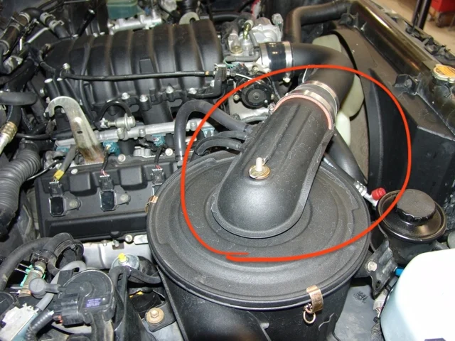

Hello all, I need advice on how to get an air intake tube so I can reinstall the old airbox so I can install a snorkel eventually. I currently have a cold air intake behind the battery on the left side of the engine bay (shown in the picture), I have the old OEM round airbox and am planning on repurposing it but need a different top to it. I found essentially what I want off of Slee's website's customer's builds but don't know how to make/find it. Does anyone have any ideas? (Intake tube on top of the airbox that I am looking for shown below circled in red)
Looks to me like it's just a stock lid from a 96-97 maybe 95 too?with a silicone reducer coupler and the top is rotated my guy. :meh:

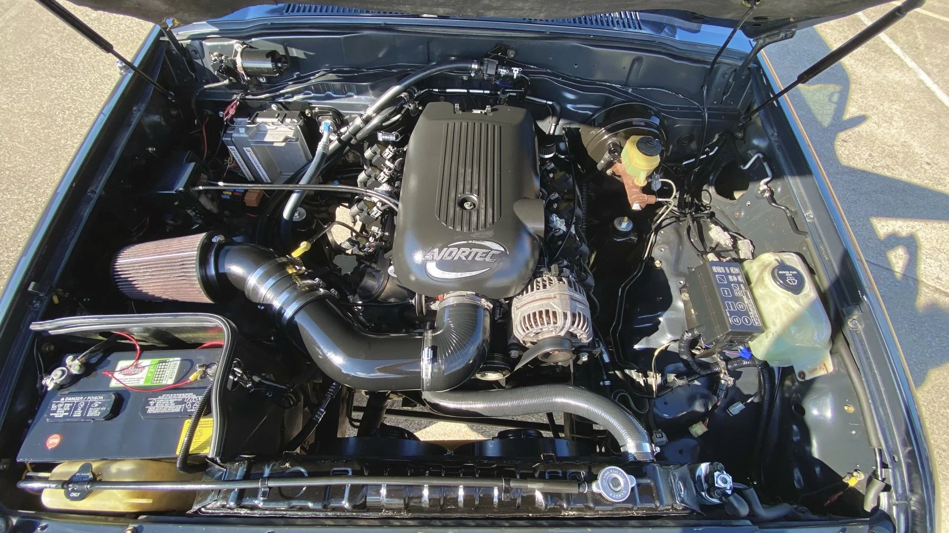

Yeah that’s stock. Let me see if I can steal someone’s pic from the V8 swap thread. Can’t remember who it was, but he just used a stock top, and cut the Toyota riser off, and put in a low profile 4” 90°. If I remember right, he had good luck with it. I’ll see if I can find it.
Edit: This was user Oscar Witte. Some guys were saying even that filter head was restrictive, he did this: Google Photos - https://photos.google.com/share/AF1QipOojSyZDWsYU4QEv2m7K6nXk4yufm7xgHtry9H0QjFZBT7PiL9cxE7ohVlwDwiqeQ/photo/AF1QipOGfc_hlntQj_EZI5VPsSeEYAdocTHj1oqWgVOe?key=Vkl4N0V0akRLSjJfb21tVHdrbWN3eXhkWWd0eFVB
