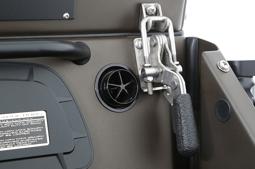

i used the image below to cross reference to this part:
DE-STA-CO Latch Clamp,SS,U-Bolt,2000 Lbs,2.89 In - 3CXE6|341-SS - Grainger
I have finally decided to buy a pair of these latches and did another image cross-reference from an icon old school photoshoot that came out a month after my last post. as you can see. I had the right brand but the wrong model.
There are actually two versions used by Icon.
https://www.grainger.com/product/DE-STA-CO-Latch-Clamp-3CXF8? (Steel) 341R
https://www.grainger.com/product/DE-STA-CO-Latch-Clamp-3CXE9? (Stainless) 341RSS
The picture above is the steel version. note the mounting plate at the bottom is curved up doubling as the locking latch.
The picture below is the stainless version. note the mounting plate being flat and the locking lever clearly visible.
