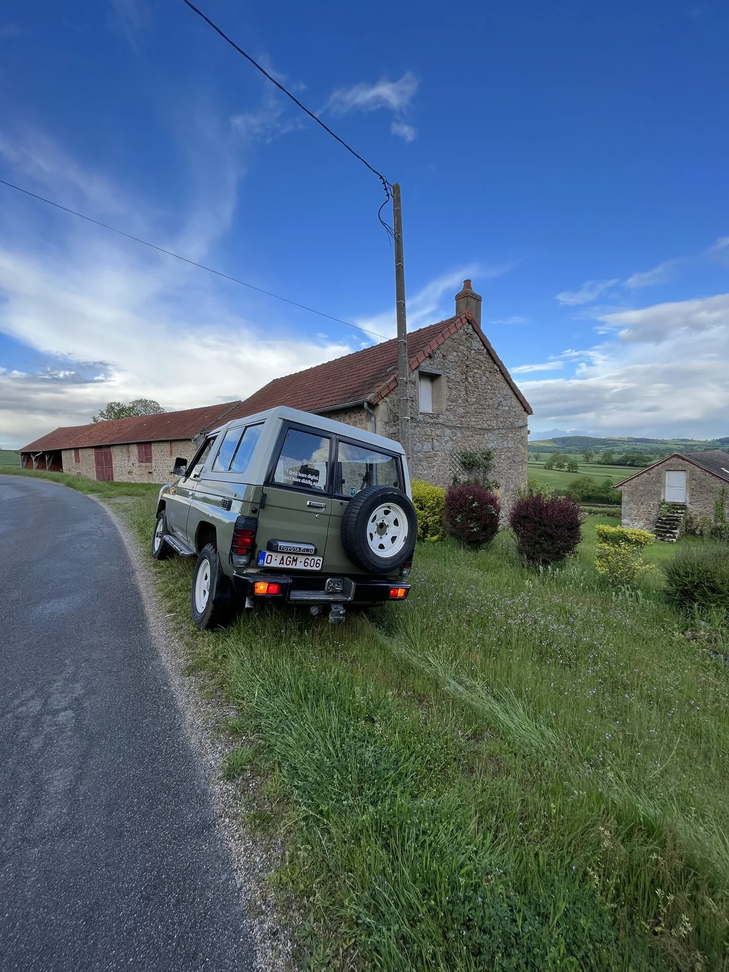

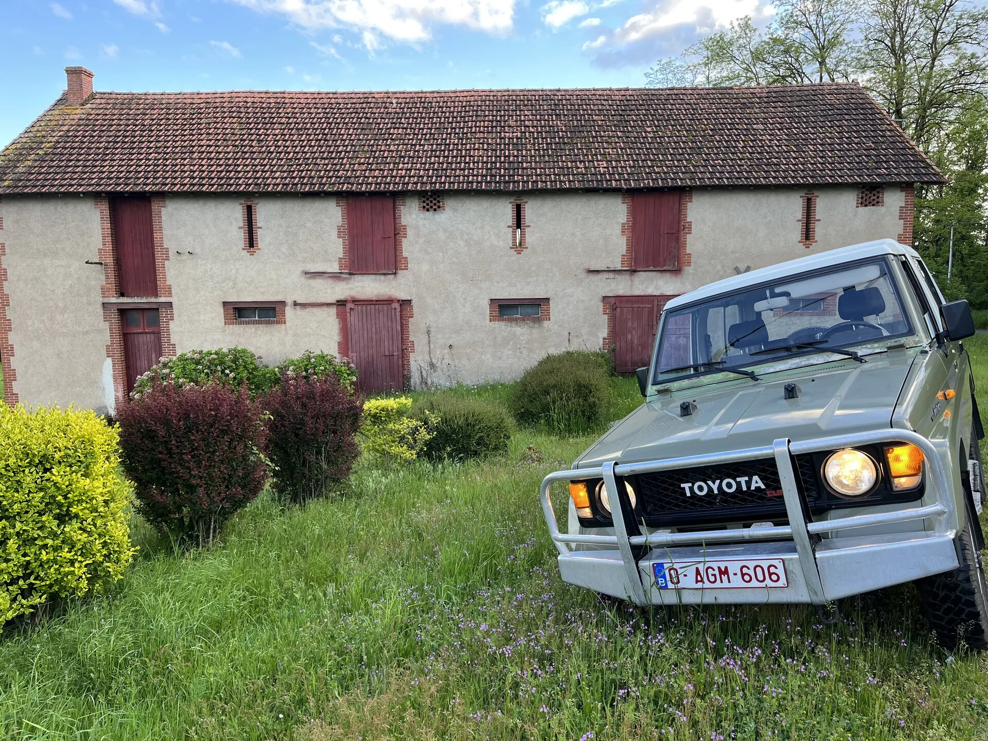

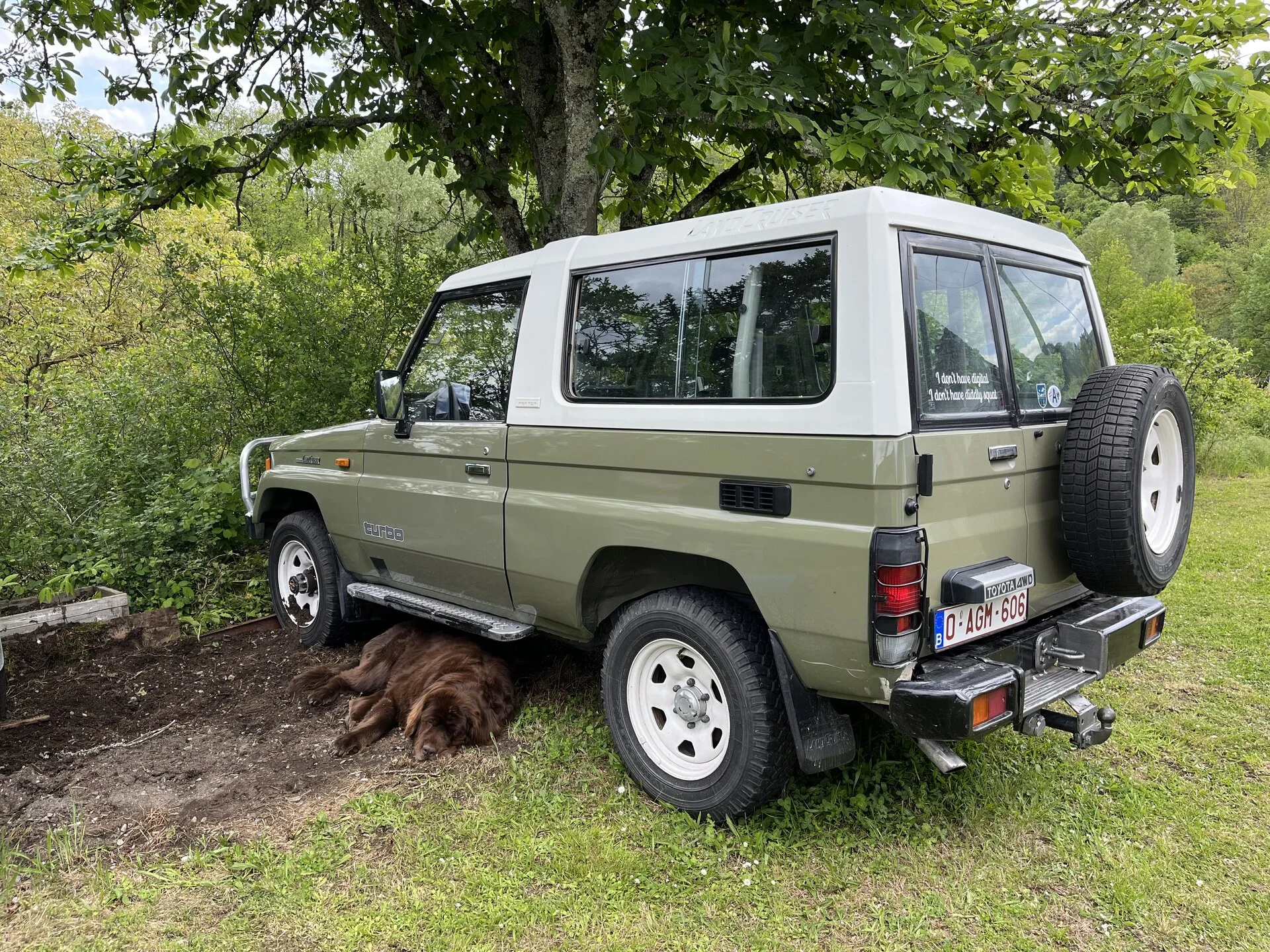

Thanks Tigris. Here’s my truck. To my knowledge it only has the one mechanical fan. Oh and my dog, she is a big fan. I don’t think I understood my mechanic’s explanation properly — Dutch can be hard to follow 😅
Beautiful Cruiser and scenery!
