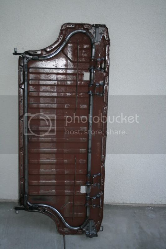

If it for rust prevention, I have never seen the back of a seat rust.
I can pretty much tell you everyplace an FJ60 will rust. "
DAnimal, I disagree; the backs of the 60 series are rusted from the get go:
