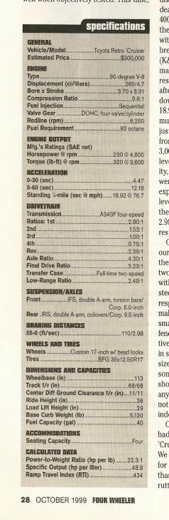

Is there a breakdown anywhere on line of what exactly went into this FJ45 project?
yep...been featured in a few mags
don't know if this will turn out legible.
What would you like to know?:)
