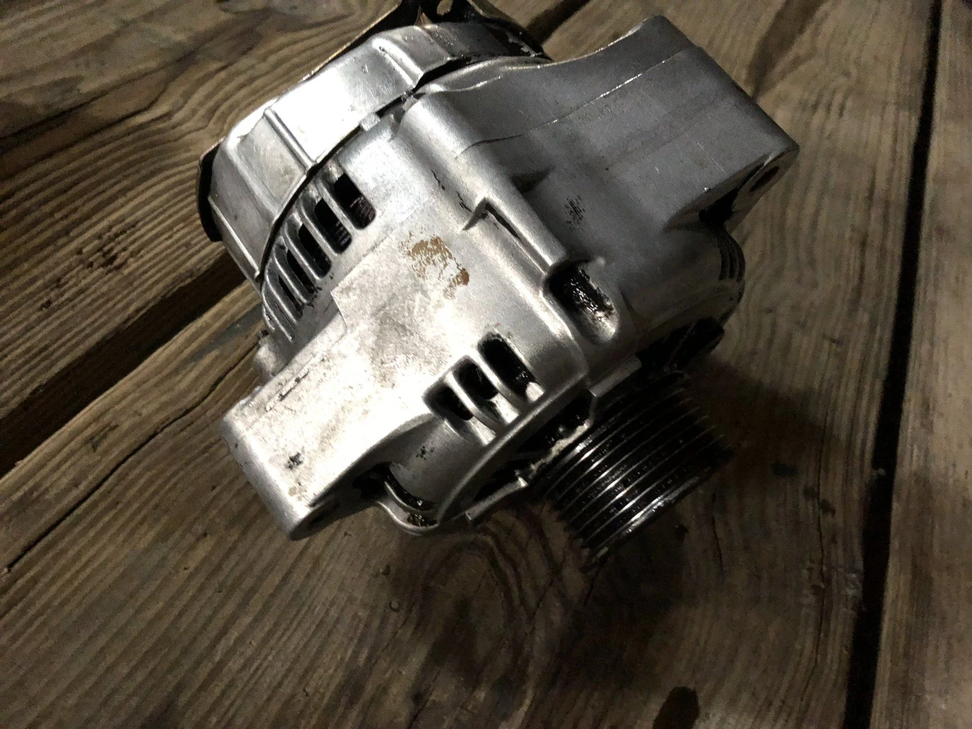

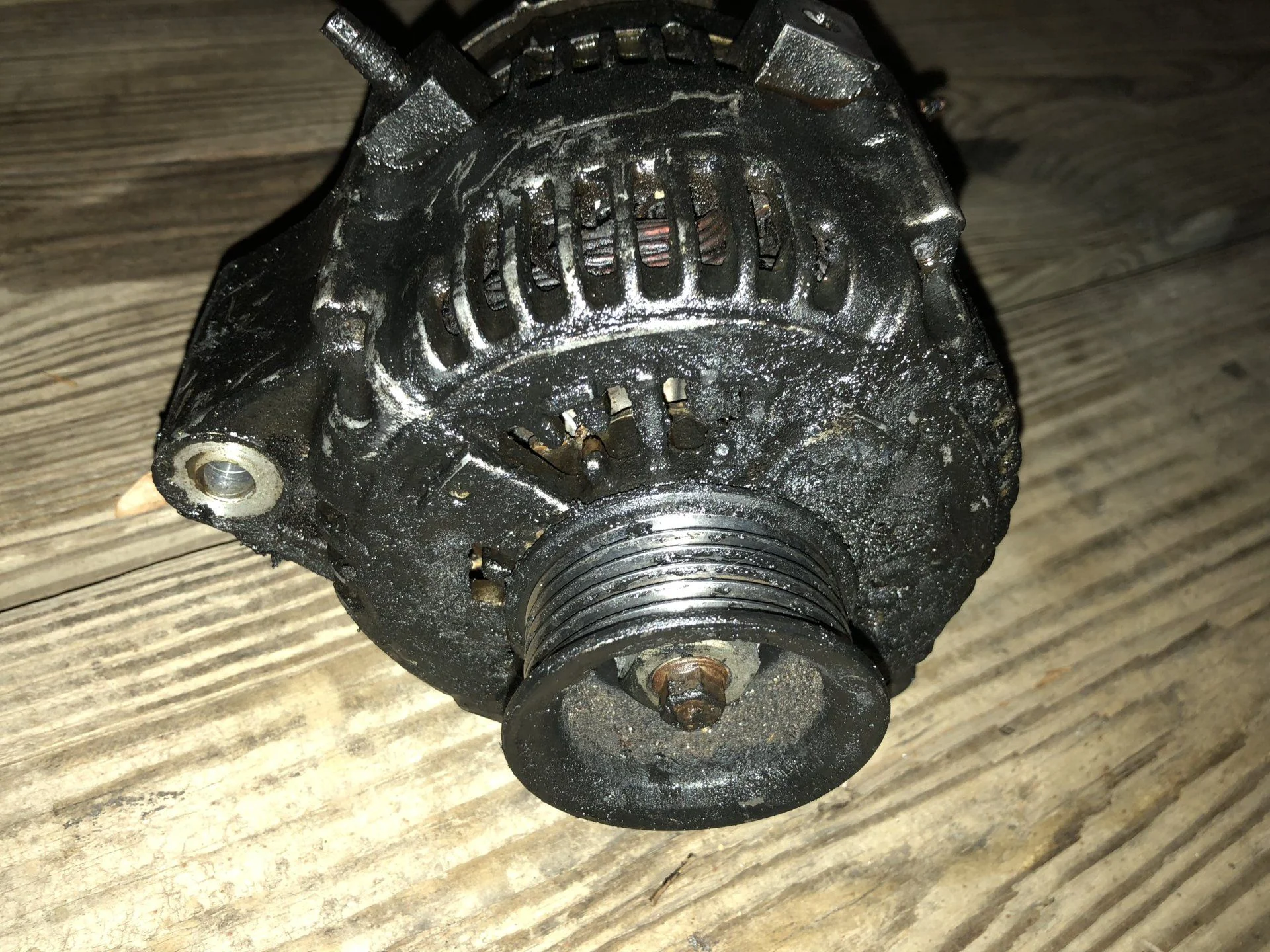

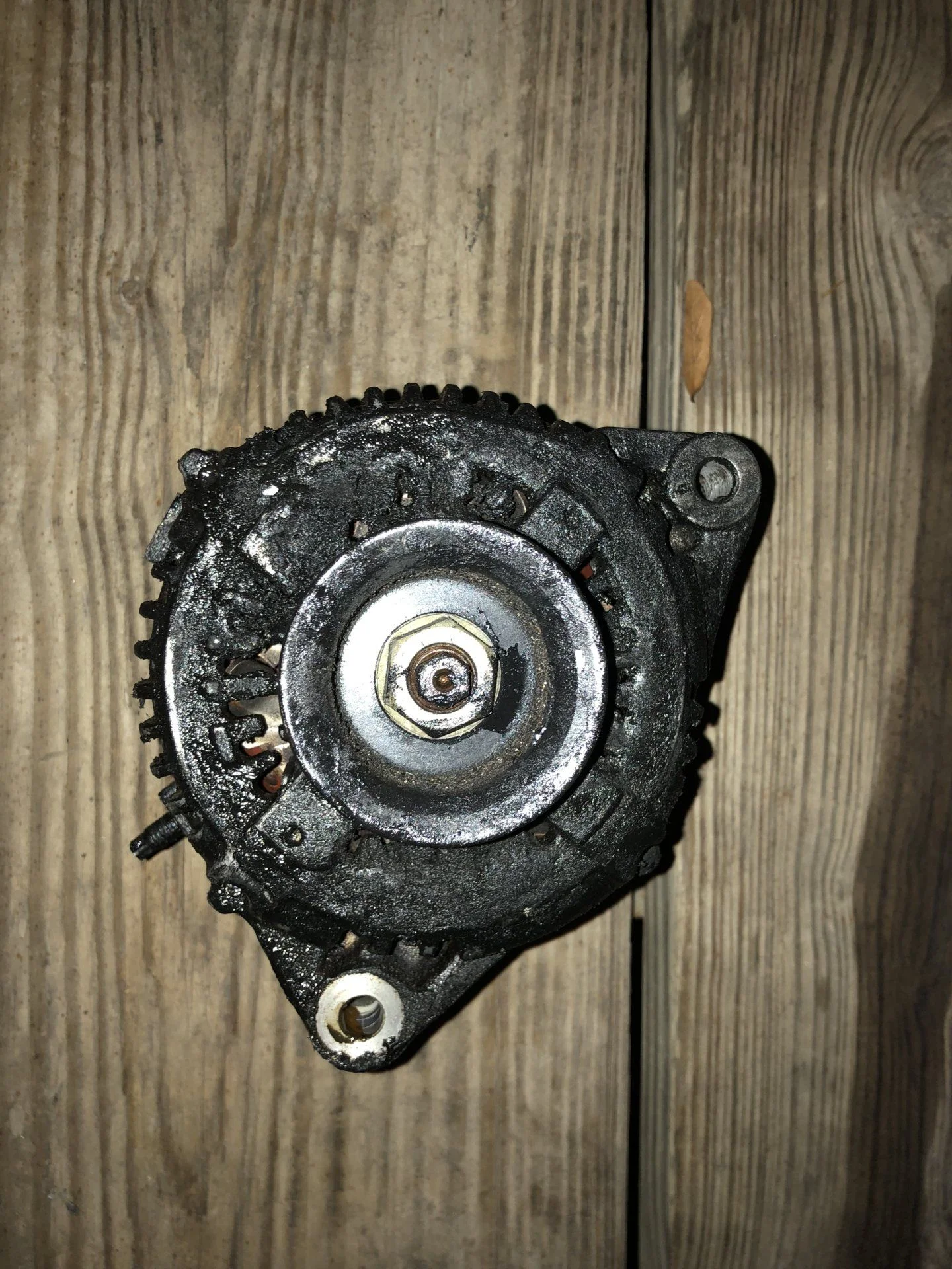

I went ahead and pulled the Alt tonight. It was filthy greasy from the power steering leak that happened before I owned it. A little simple green and some misc brushes and it got pretty clean. I went ahead and cleaned what I could reach in the engine compartment.

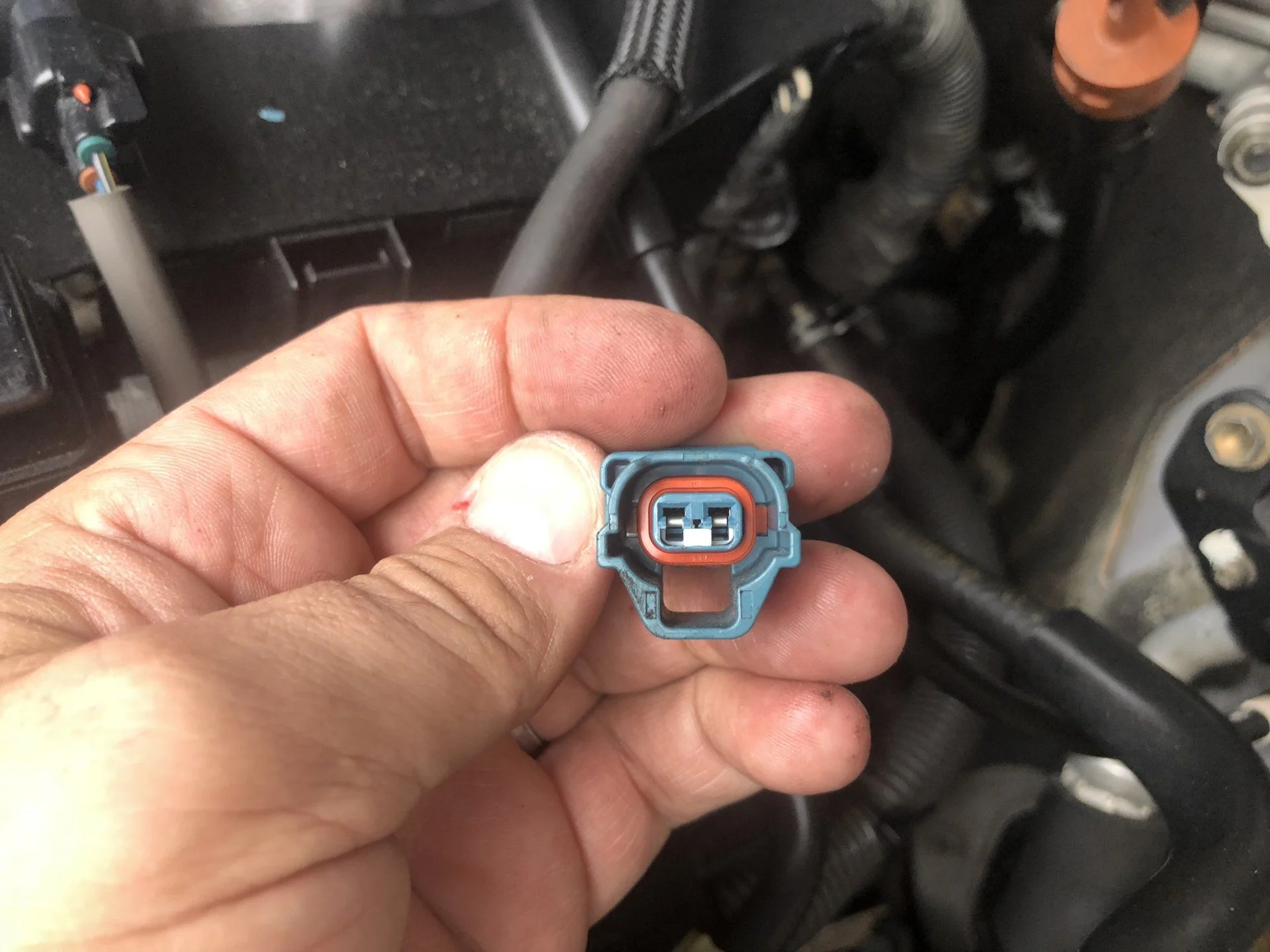

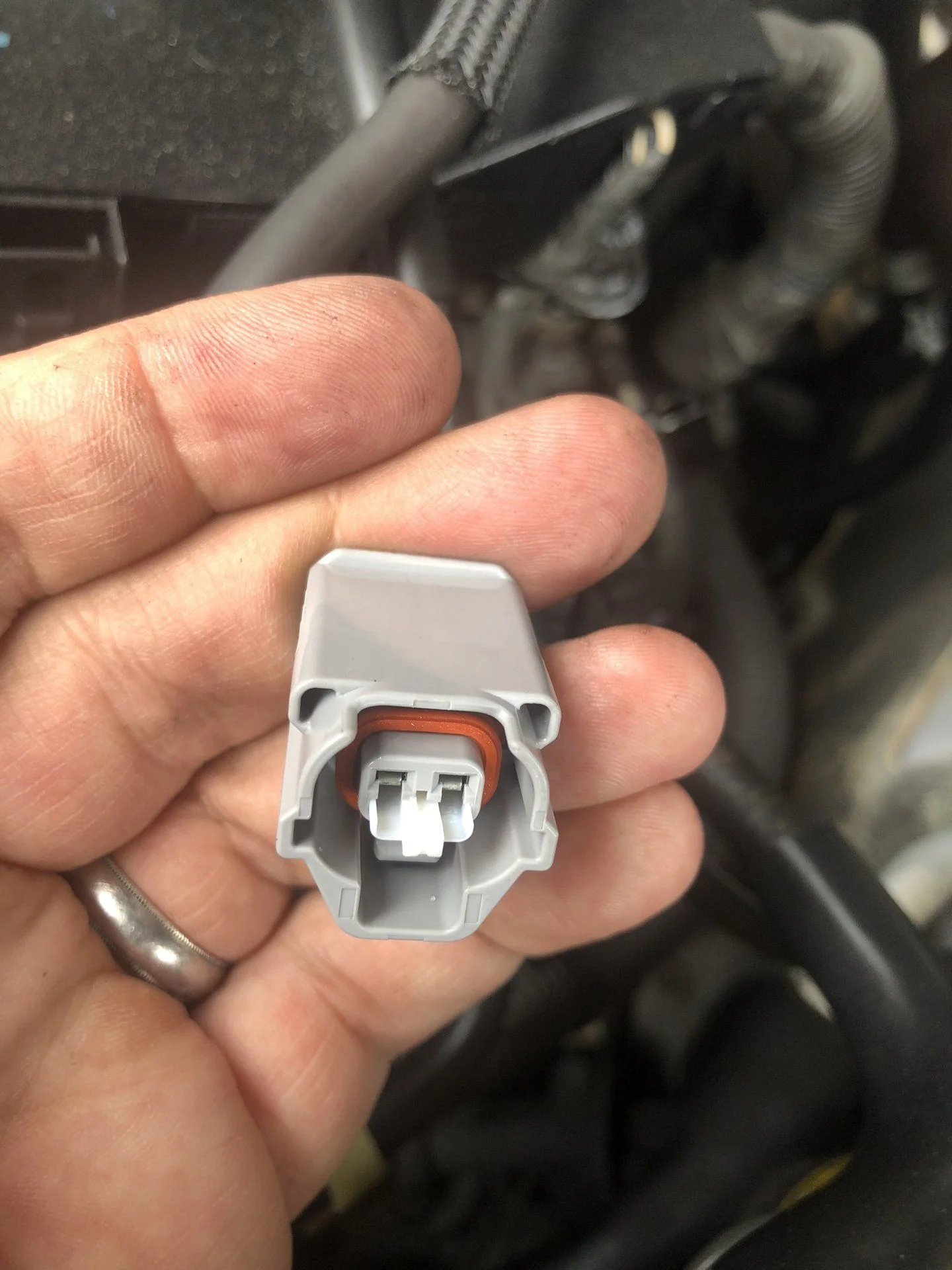

I will clean it more when I pull it apart. Of course, the plastic connector fell apart as I pressed the release clip. Anyone know that part #?
Look through this thread Alternator - Napa of Oreilly and it shows one member who used a wire pigtail he bought off eBay to replace his. Also, if you still have the connector it should have a pn printed on it.

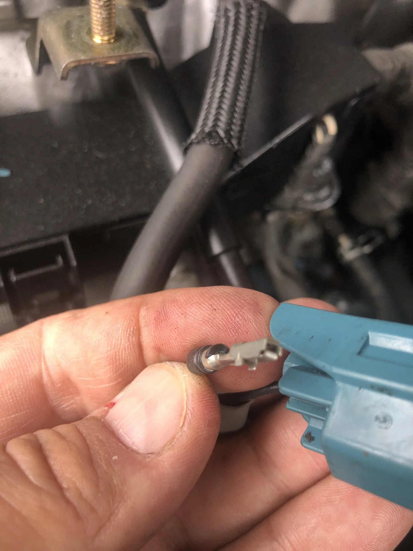

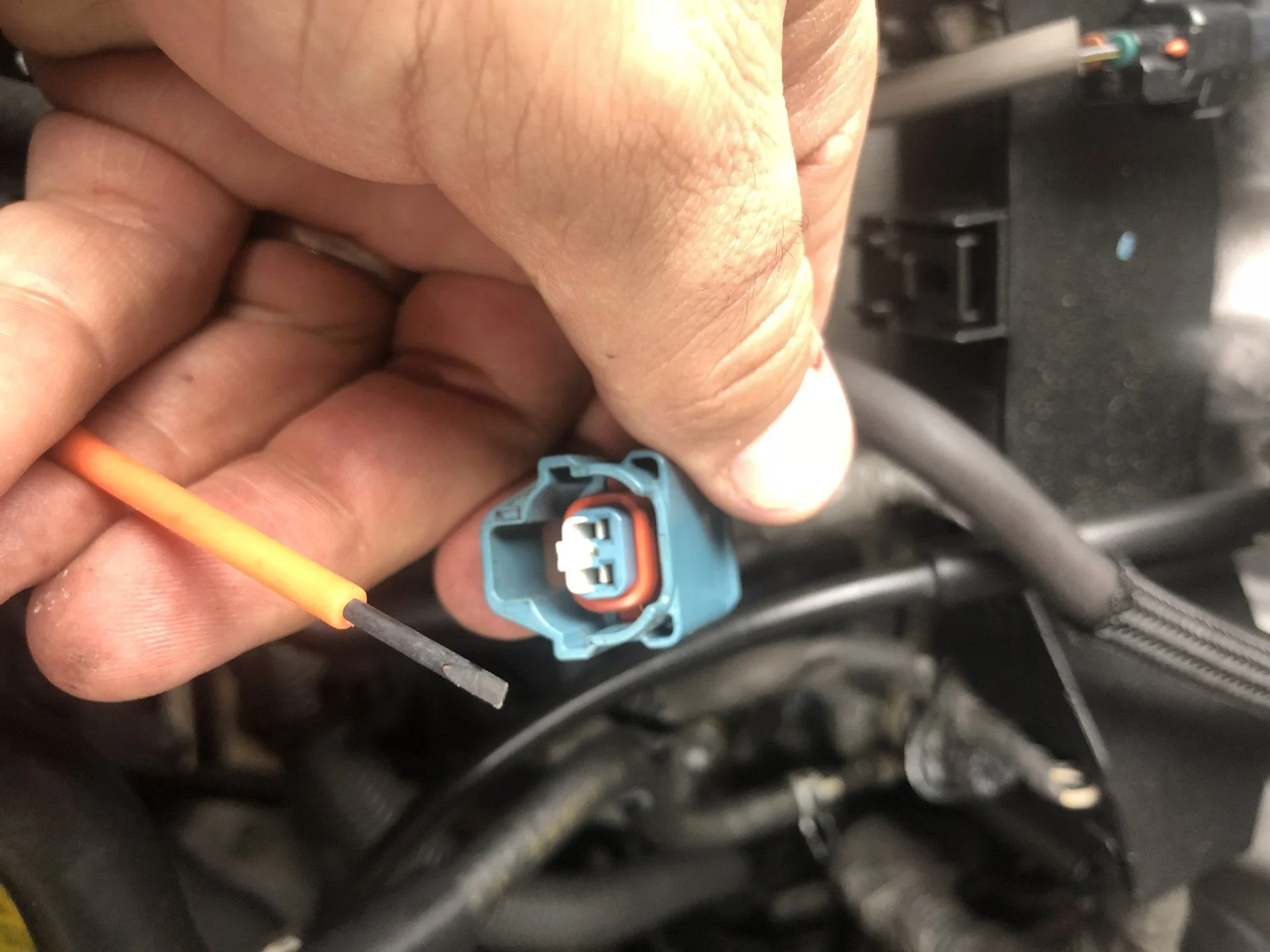

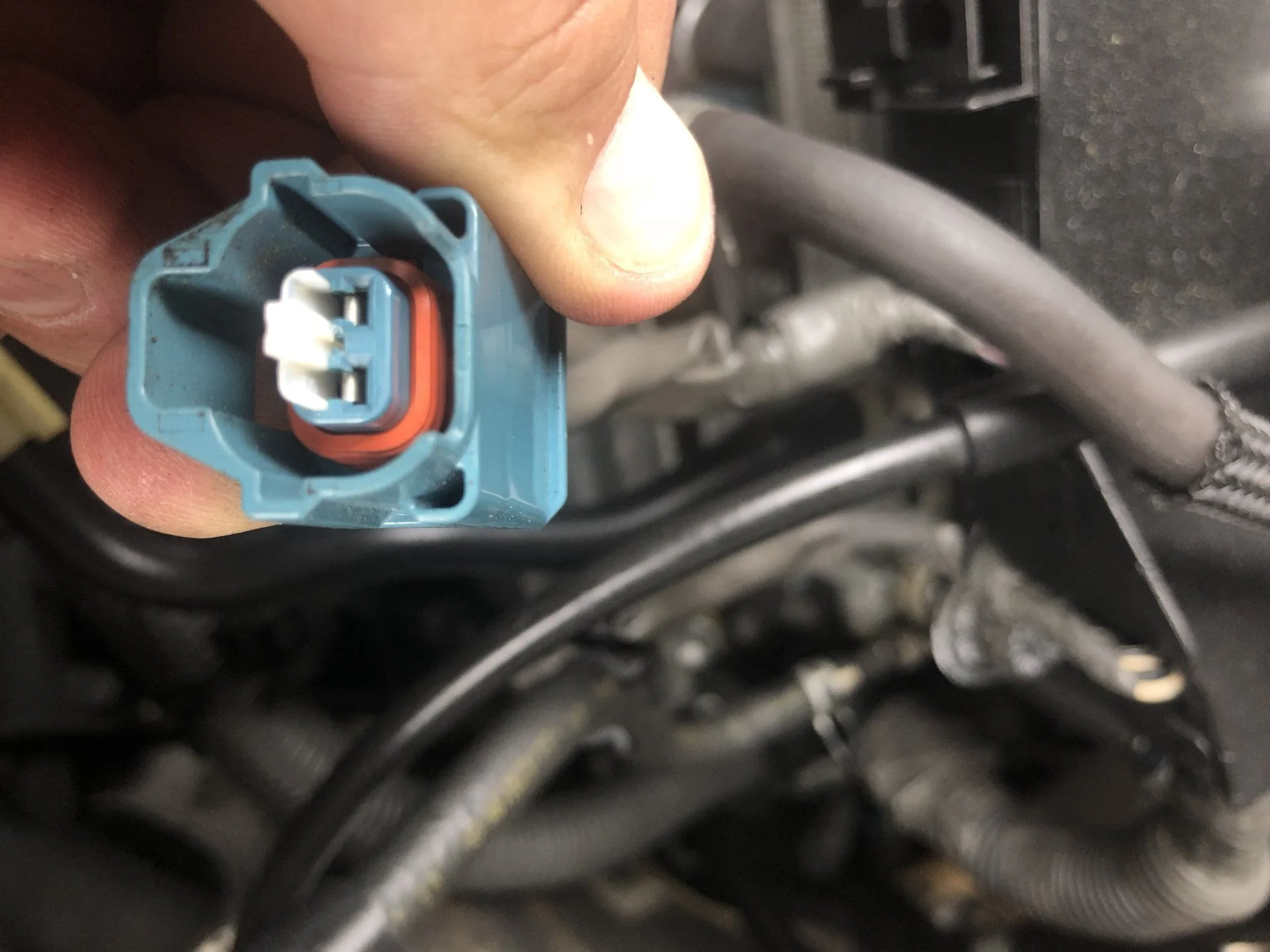

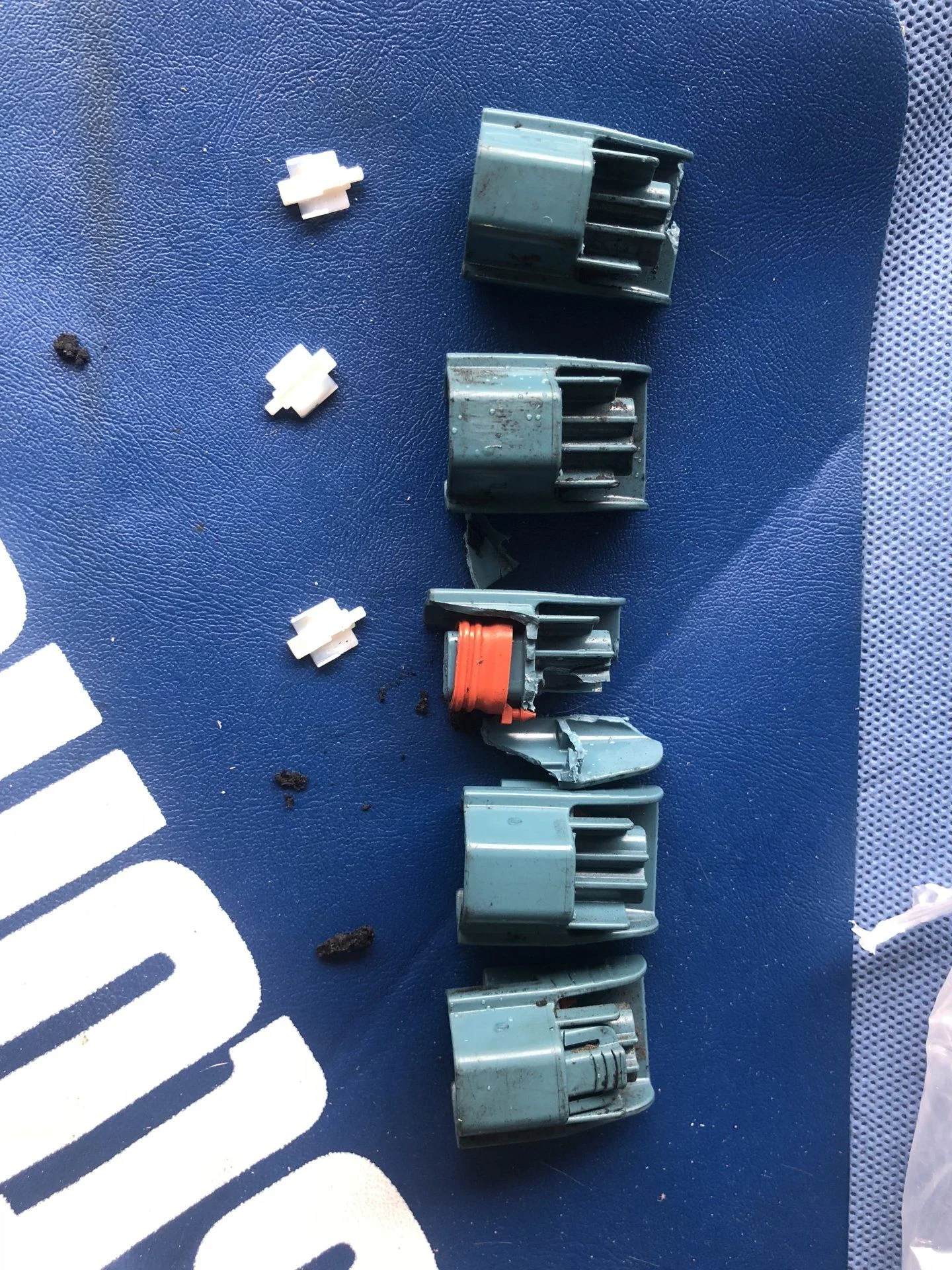

So I had some time to worondo on her today. I decided to fix up the electrical connectors that broke. Pretty easy deal. I actually think it is easier than splicing in new connections and is cleaner and will last longer. See the little white tab in the middle of the connector? Grab it with some needle nose pliers and pull it all the way out.
Halfway out
I used a small electrical screwdriver to go in and disconnect the clip inside
Here I have pulled the white clip all the way out. Put the screwdriver (or ice pick, dental pick, tool, etc...) where the white clip was below one of the connectors. Try to dig the tip into the plastic clip and pry down away from the metal connector.
Put a little tension pulling the connector away from the vehicle and it should slide right out. Before taking them both out make sure you know which wire goes on which side.
And out they come...

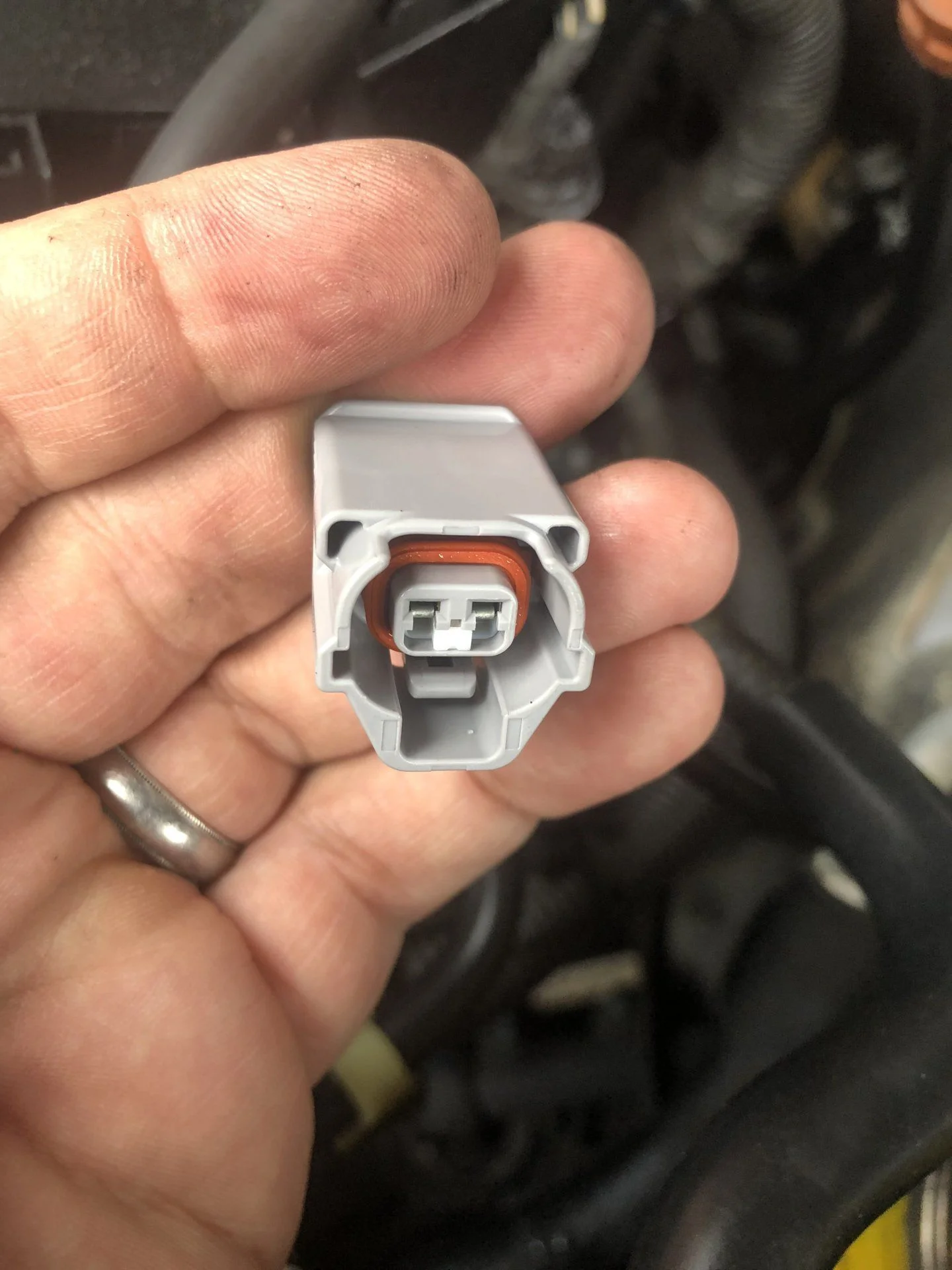

This is how you receive the new ones with the white clip half in
Insert the wires in the same position they came out and press in the white clip
Some of the carnage
After getting the hang of it it goes really fast. First one took 5-10 min of figuring it out, the rest was maybe 1-2 min each.

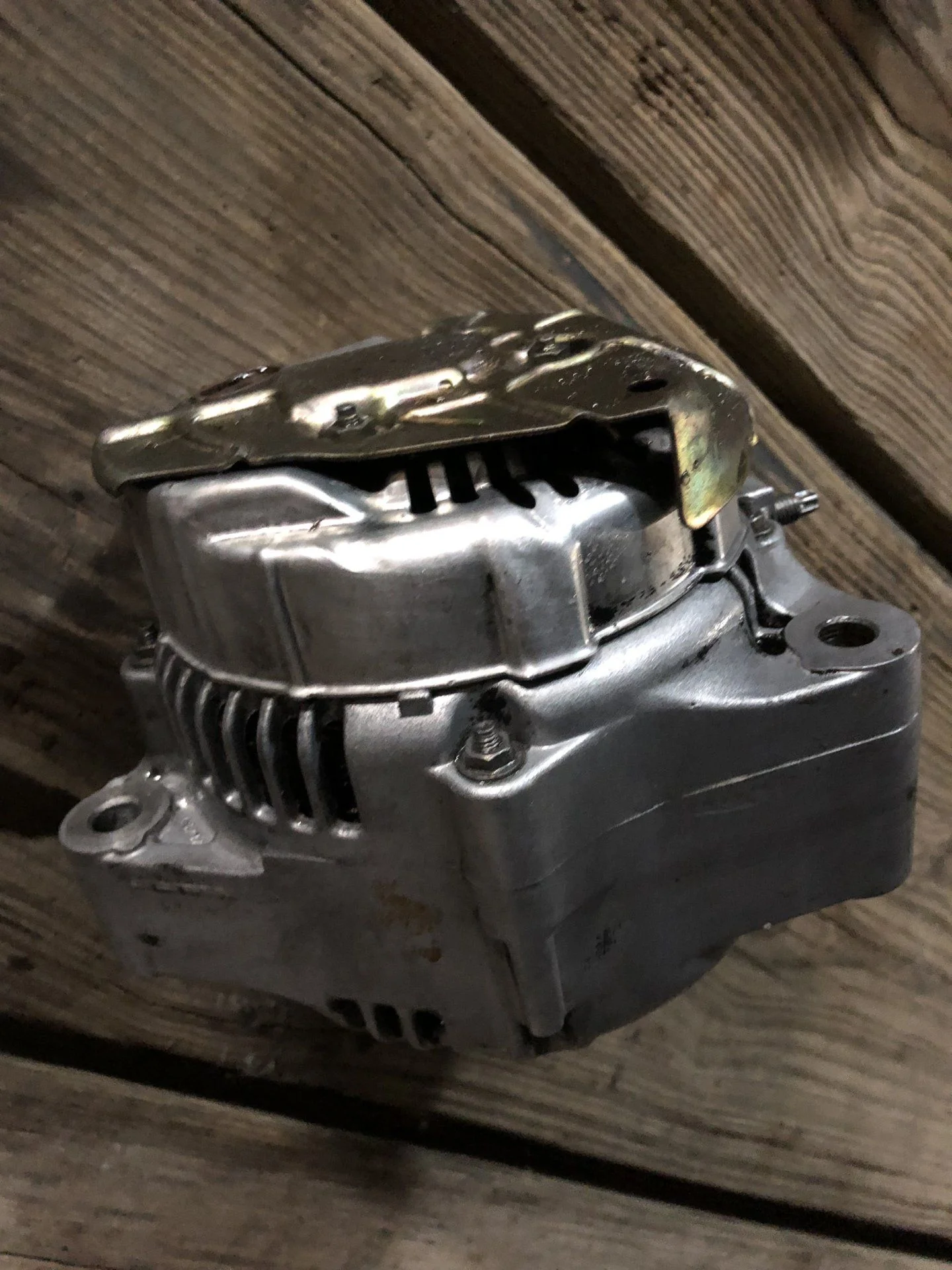

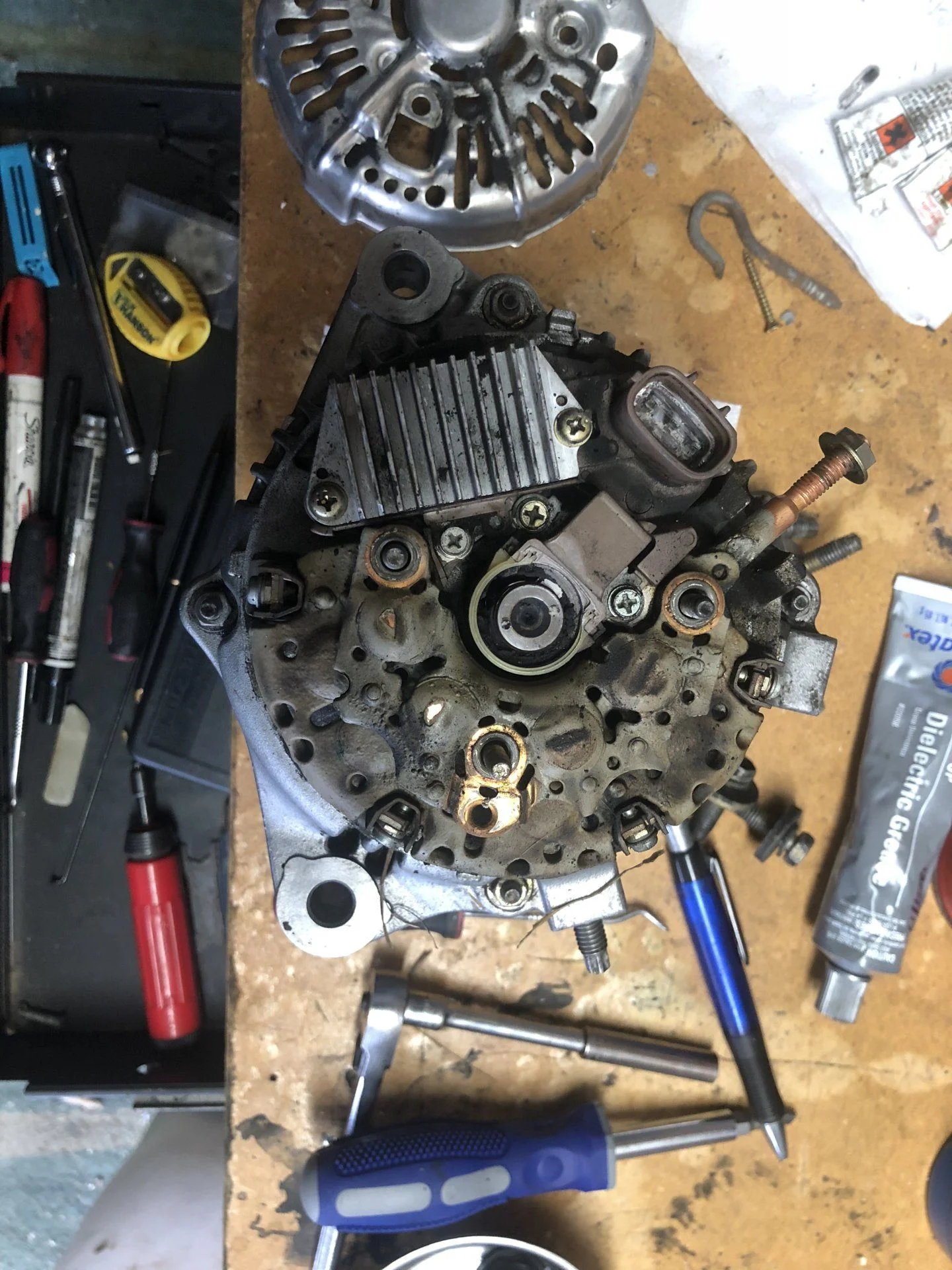

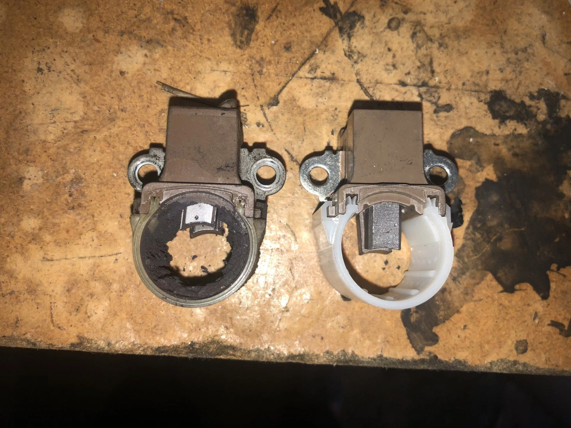

Started pulling apart the alternator. I have the brushes but the bearings and connector will be here Monday.
It’s dirty in there
Old vs New brushes
I went ahead and started cleaning the bodies and other parts so hopefully I can just throw it all together on Monday. Bearings feel great. Prob don’t have to replace but since I am there...
