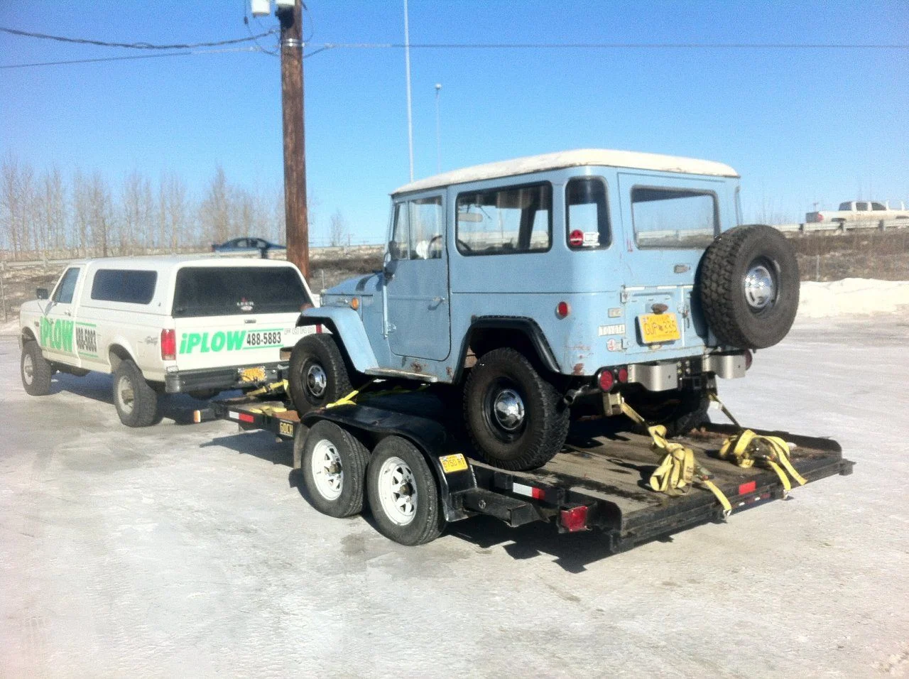

I couldn't pass it up- i.e. another project
Very nice find!! Look forward to any build info.

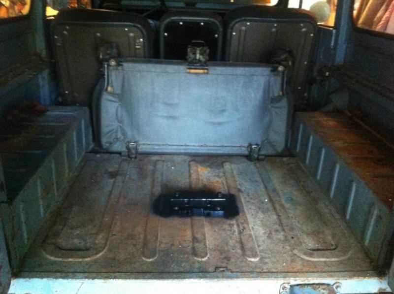

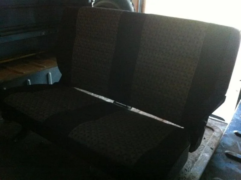

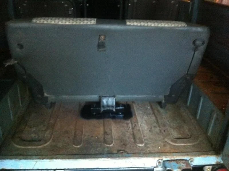

My wife HATES the stock 40 jump seats for our kids (10,4, and 2 in age) so I had to find a viable, cheap alternative. Off to craigslist I went and found a Suzuki Samari rear seat. The cool thing with this seat is that it: fits between the wheel wells keeping it out of my rear-view mirror, folds flat, and tumbles forward, semi out of the way.
All I had to do was drill a few holes, cut some 1/4" backing plates, and fab up a latch/ inner seatbelt anchor.
