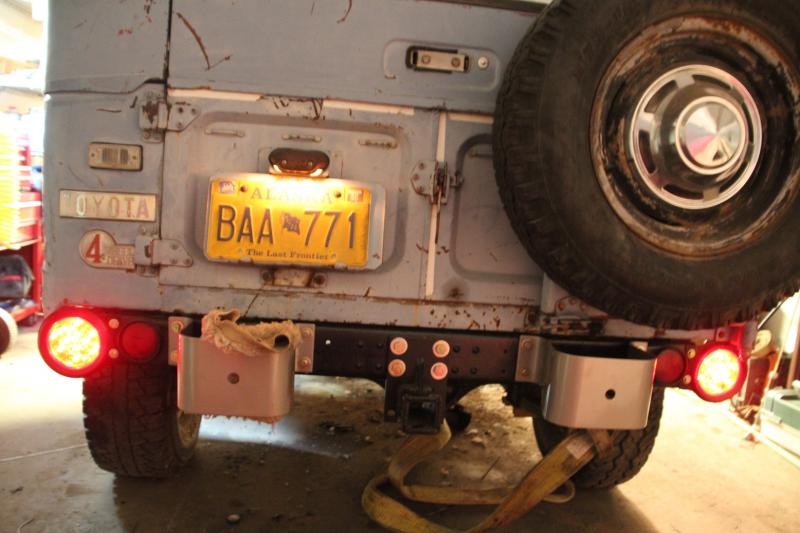

The motor is bolted in and running-ish, I still have some tuning to do. The oil pan had a hole in it, so I had to source a new one (Thanks Bill). None of the lights worked initially, so I've been working on those. I now have everything working electrically except the wipers. Even the dome light and reverse light work which is a first for any of my 40s. The led taillighs are VERY bright, which is going to be nice.
Now I have to block off the PTO and run the new linkage to everything. After that I've got to figure out what to do with the drivelines and exhaust system.(studs are sheared on the manifold).
Here's some pics of the lights working!
