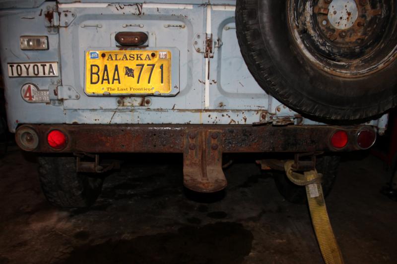

Got some stuff done! I focused on the easy stuff tonight and pulled the old taillights and fugly hitch off, then installed a new spare hubcap, led taillights, bumperetts, and 2" receiver.
I know some purists are going to hate the leds and 2" receiver, but this thing is going to be my daily driver and I've got to be seen in -50 ice fog and be able to easily hook up our trailers. Here's the pics!
