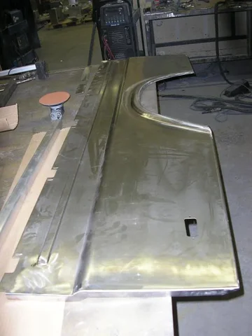

Some pictures of a side panel after grinding and sanding the welds down. Those of you who end up using some of these will just need to spread a thin layer of filler over the arch area and at the ends to fill my sanding marks and any misc little low spots etc. I'm not a body man but I would have no problem making this straight to the eye when finished and sitting in the sun.
I used silicone bronze TIG welding rod. The rod is called Everdure locally here. It melts at a lower temp and allows you to put less heat into the parent material. Less heat means less warp. It is also a bit softer than steel and easier to sand and grind away leaving it smooth. The steel just barely melts and mixes with the Everdure so there is some penetration to the welds to hold sturdy after sanding off the bead. This application is purely cosmetic and should hold up good to vibration and road shock, espeacially when you take the rest of the bed structure into account.
