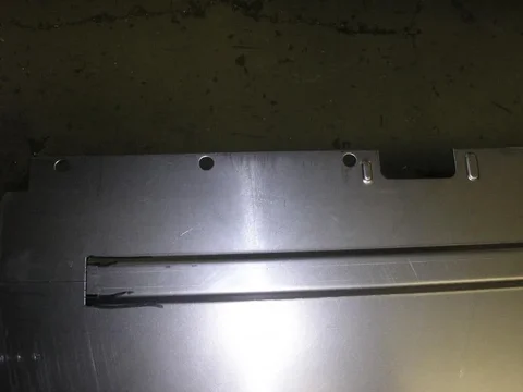

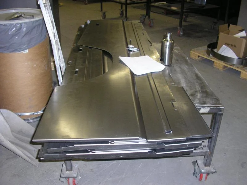

I can make LPB box sides
Yes, 3 sets of 16ga sides and one set of special request 14ga.:)

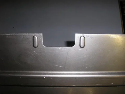

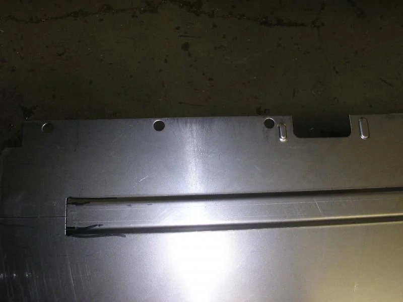

Added the dimples this morning. These are on each side of each hook on the sides of the bed. The rear most hook only has one forward of the hook and the front hook has a smaller one ahead of the hook to clear the headache rack mounting bolts better.

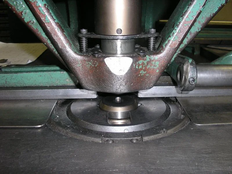

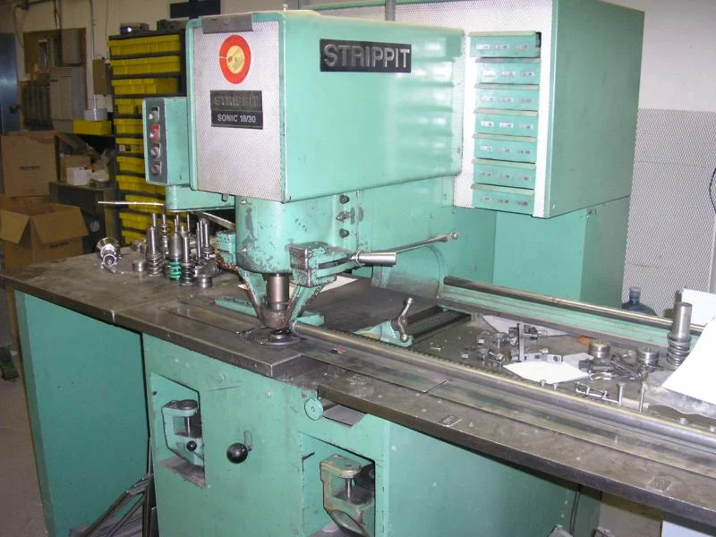

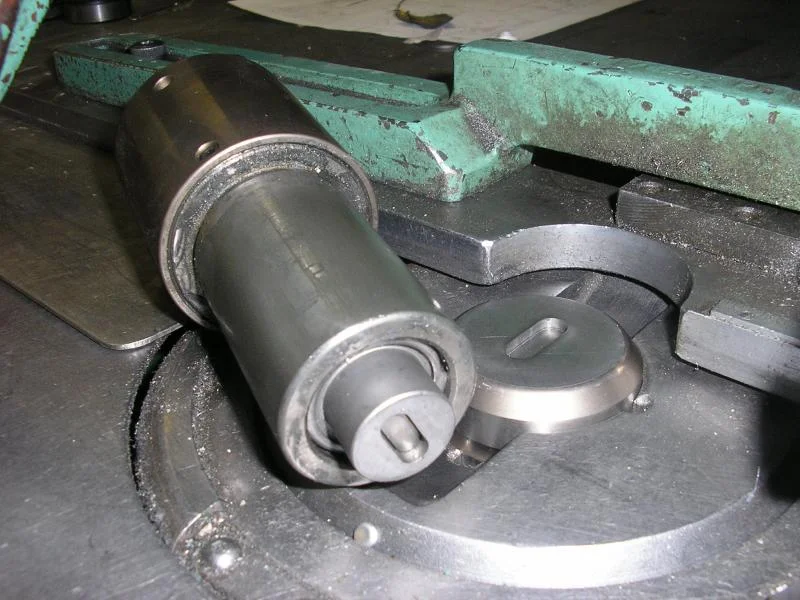

This is how I made the dimples, a single station 30 ton manual punch.
A closer look at the tool. This machine uses the same type of tools as the turret punch, just one at a time rather than 26. Normally it would punch right through the material but I didn't want a hole. I shortened the punch and used an oversized die to get the desired dimples (the machine has a fixed stroke). I can buy a tool for the turret that will do this but thats $500 I can spend on my 45, so I did it manually using tools I have on hand.

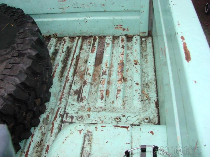

Kevin, you may have already discussed this but those dimples are not on my early (1964) 3-hinge long bed. It is just smooth metal besides the hooks.
Excellent info mike. I've been gathering details on the production whims of Toyota over the years in my other thread, I'll add this as well.
Don't know - never seen one. Probly not much different though. I'm gonna have to go to a gathering with a tape measure, calipers and a notepad :grinpimp:.

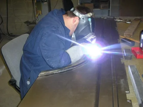

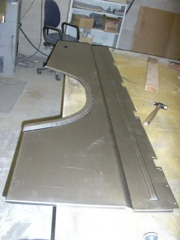

Updates from this weekend
Family obligations kept me away from the shop Friday and Saturday but today I was able to put in a full day.
Here the end and bottom flanges are formed
Ready to weld
Welding
