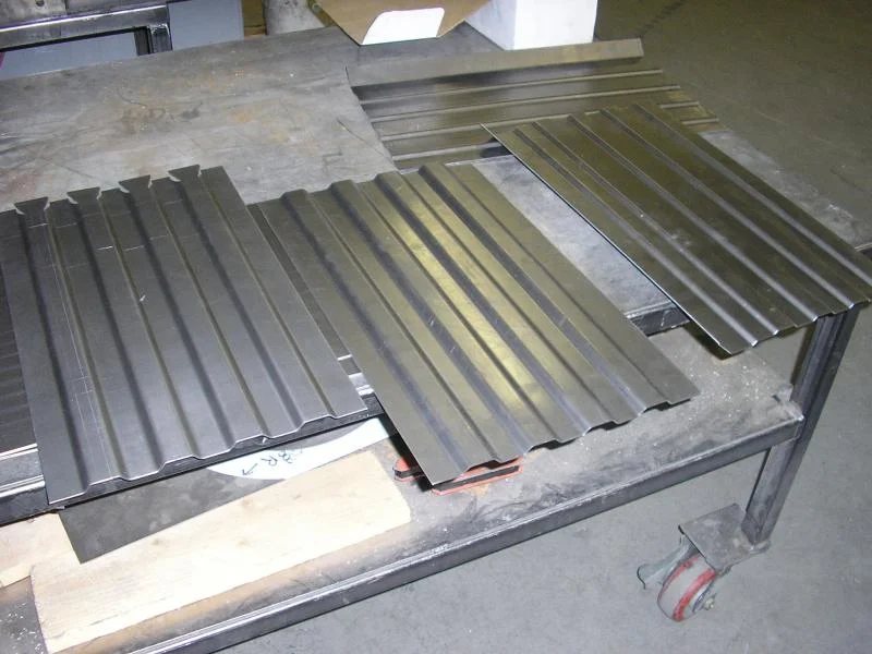

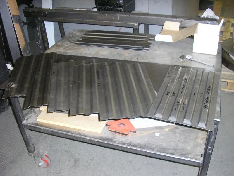

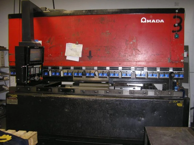

I have been drawing parts and pieces of the long bed all week in my software at work. Some parts of the bed are quite simple - hat channels, z channels, c channels. Others are much more involved. The first tough one I'll nail down will be the center section of the bed floor. It's about 83" long by 39 3/4" wide and has 15 ribs. The first item to tackle is the rib. Because I don't have the tooling or tonnage to press it all at once I have to make four bends for each rib.
I played around with a few different die combinations until I settled on a 0.188" rad top tool and a 0.551 bottom V opening. This gives me a rib that has some radius to the corners rather than a sharp corner that standard tooling will give. The original floor has a very rounded rib - at least mine does.
I'm working with 20" long samples here to fine tune the layout of the bends.
I'll have no trouble making the complete floor. This is a 10' machine but I will have to buy another length of the top tool to get to 83". One minor issue is the controller on this machine can only hold programs with 20 or less bends. I need 60 bends to make the floor so I'll have to make a couple of programs.

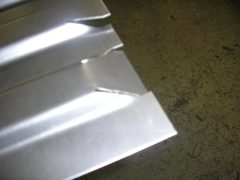

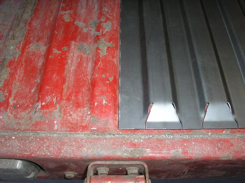

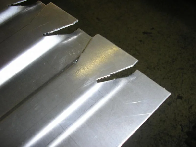

I punched these samples out on the turret and they include the slits to close the end of the ribs at the tailgate end
Getting pretty close. Mine is a little sharper rib and the spacing is a bit off. I might be able to go to a .236 top tool and make the rib taller. I'll have to do a few more samples and play around a little more. Also I see now that I can punch the slits a little tighter and have a smaller gap for easier welding. The gap at the top of the rib is 0.087". I can go down to 0.062" and not taper it out as much.

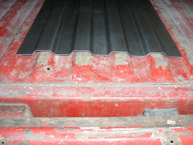

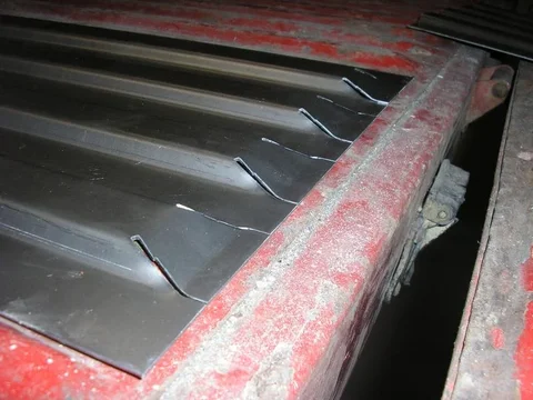

I made the trek to work today to do some more work to nail down the floor ribs. There are actually quite a few variables involved when doing it the way I am. The width on top, the angle and length of the transition to the valley and the width of the valley blah, blah, blah

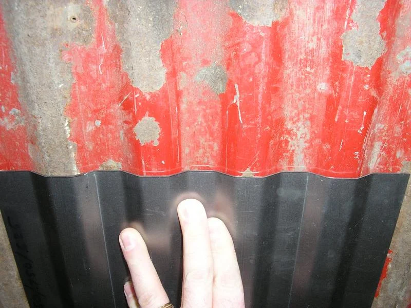

Anyway, I made several attempts to get it right, made more difficult with the bed 30 minutes away... These all look the same to you I'm sure but they are very different up close. I made my best guess and took a sample home to check my progress.
I think this will do nicely. Now to make a full size version with the slits for the tailgate end detail.

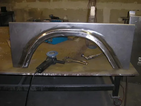

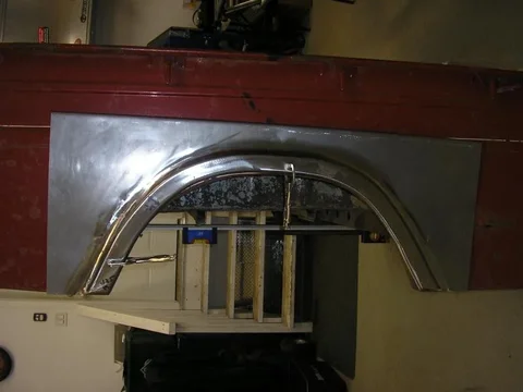

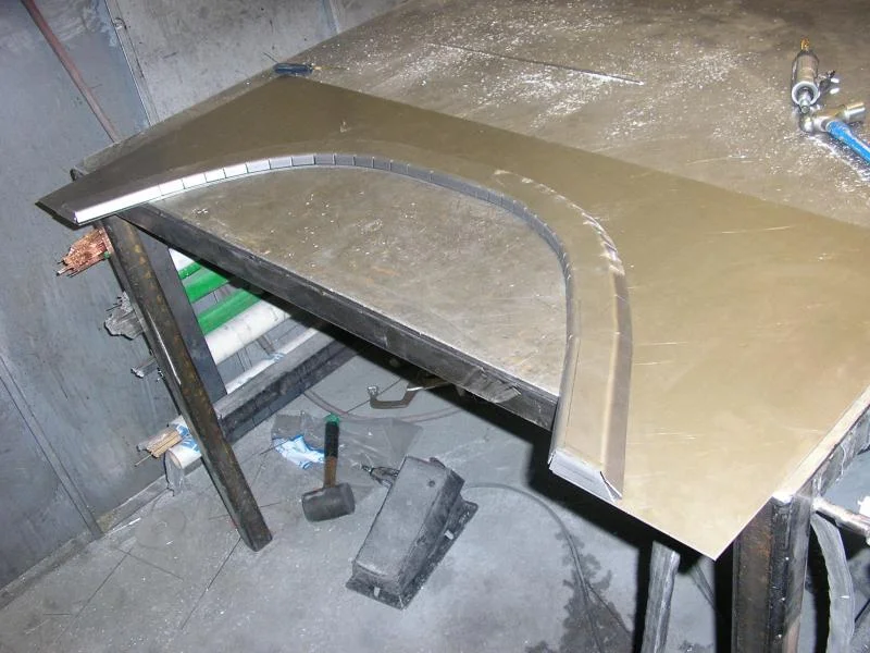

Also made a 16 ga wheel arch rib to see how well it would weld on. Keep in mind this is a proof of concept and the real thing will have smaller gaps and fit up better for easier welding. I punched out a copy of the wheel opening from the bed sides I make. It's just a flat sheet. Then I punched out a rib and formed the edges down. Nothing fancy, just slits cut to relieve the metal as it forms the arch.

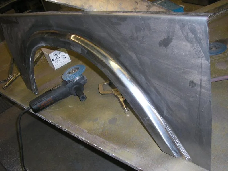

I'l spare you seeing my so-called welding skills. I started TIG welding it on using standard steel filler (70S2) and was putting way too much heat into it and getting warping. So I switched to Everdure (silicon bronze) which takes less heat and is way easier to fill gaps with. I buffed off the lumps with a flapper wheel, et voila
I think it looks pretty good. This one has a bit of wave here and there due to my crappy welding but my guy Shawn has mad skills and will make them much better. The lesson learned is that I don't need the solid 1/2" laser cut arch if I can do it this way.
my ugly spot - couldn't sand it away :o
Stayed pretty flat. Should be even better with a real welder making sparks.

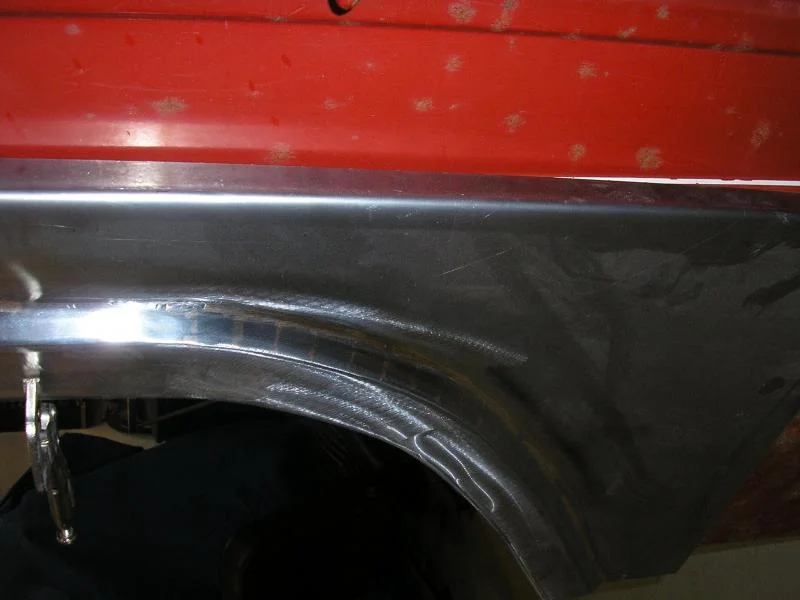

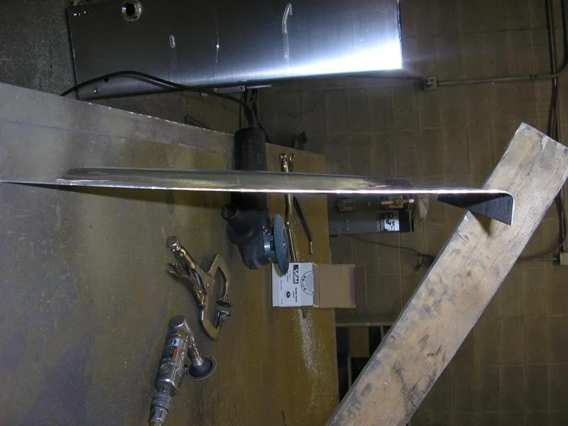

A couple more
Funny thing - I didn't realized until after that it's on the wrong side.
Thanks ehsan. That's high praise indeed coming from you, someone with experience in this sort of thing.
No no.. :).. Everyone has his own way of doing stuff. Ours is different (if not primitive) than yours.. I wish I knew how to use a TIG welder to do the sort of welds you have done on that fender.. Very little wrap.. When we do something like this, it was twice the time hammering it back into place..
