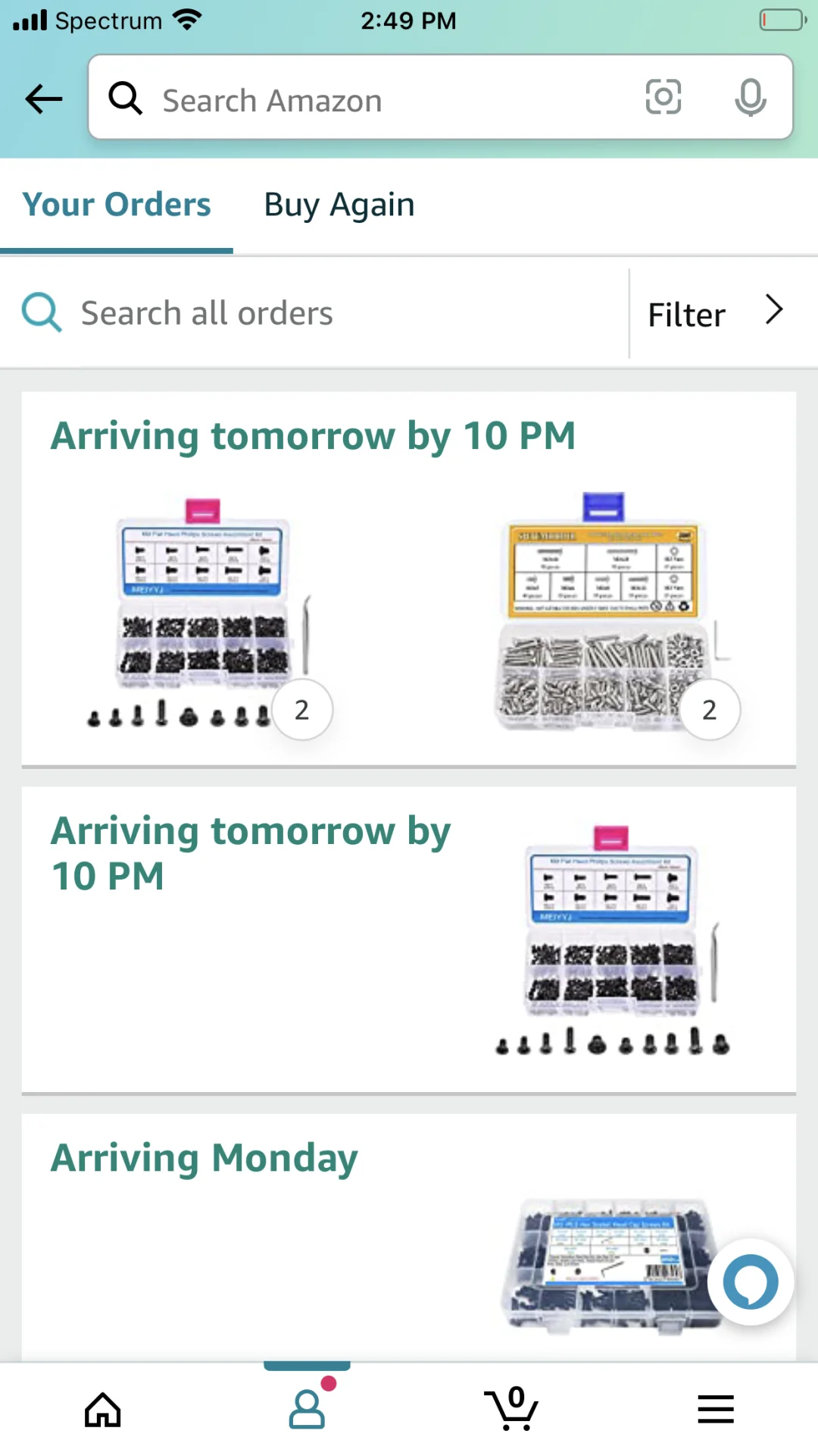

Also @mrboatman dont worry I’m ordering screws now for this shipment, and after this one the full sets of fasteners will be here and we will be all good on that front.

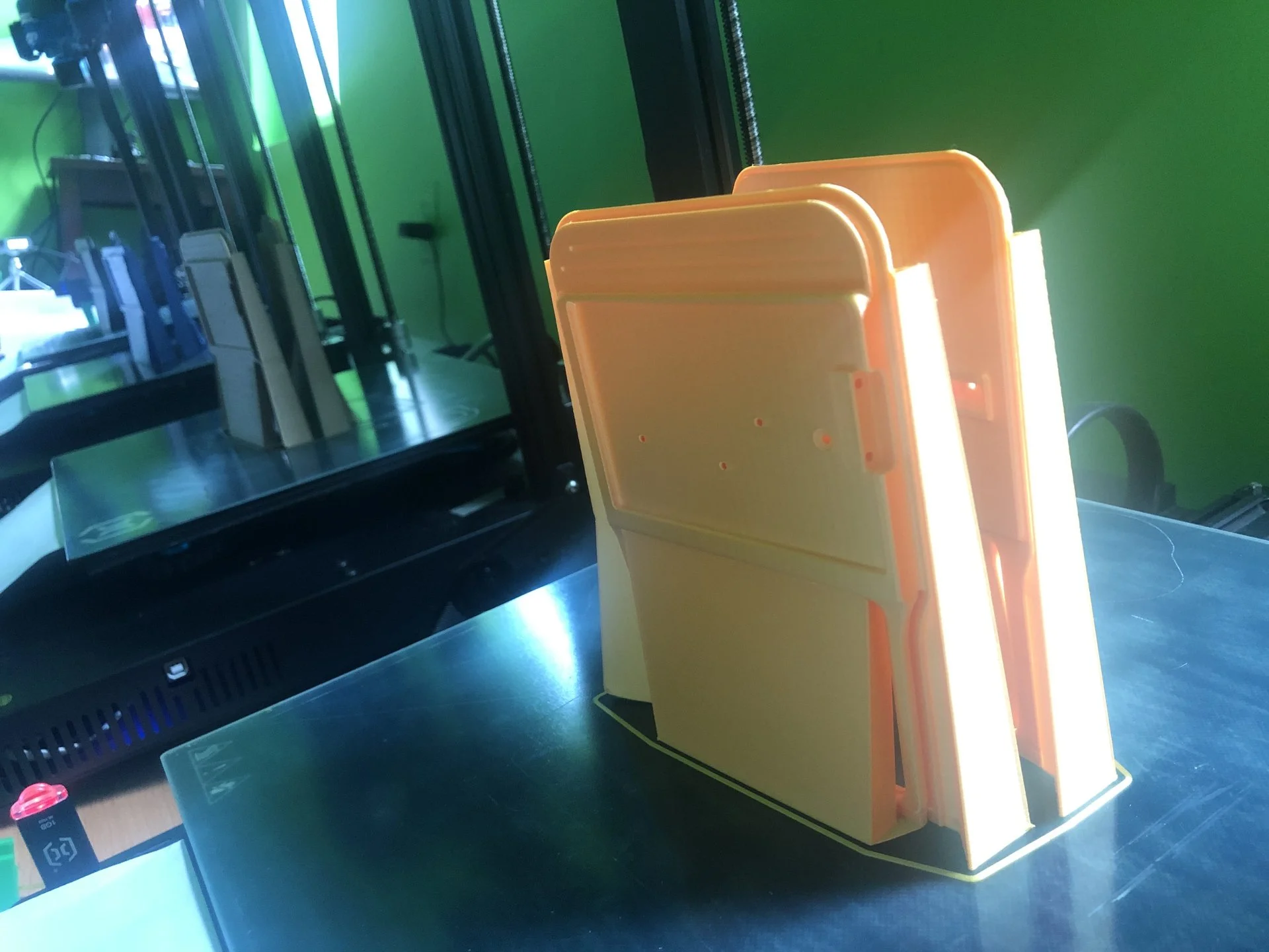

And WHAT IS THIS? just came out of the oven.
Printing more body parts (like fender flares) and other body parts to complete the 40 over weekend/still trying to add to first shipments.

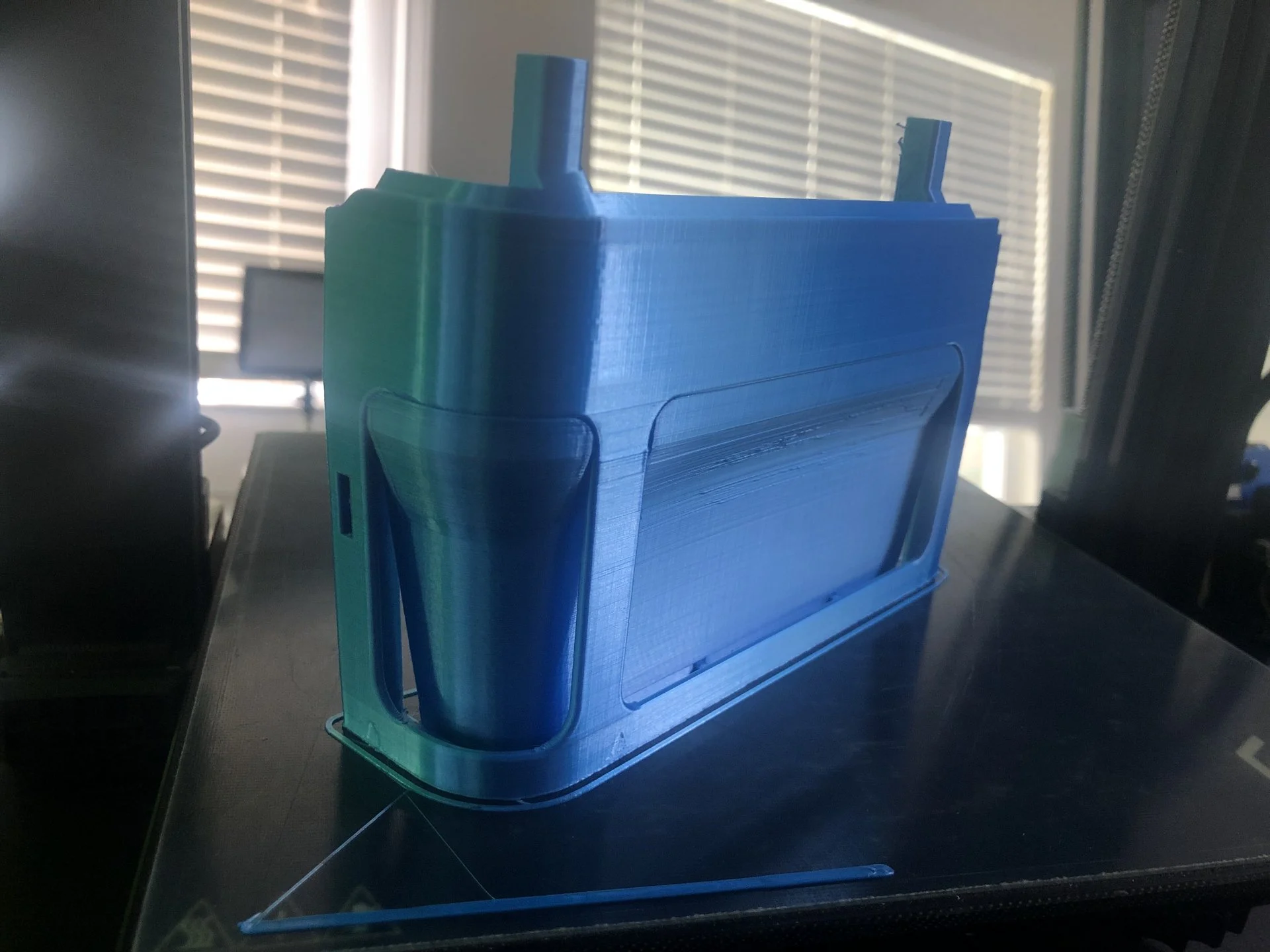

@mrboatman first piece of your blue hard top; it has many pieces.
What it looks like fresh out of the build plate and after 30 seconds of support removal.
If someone has a spare debrimming tool for cleaning up the edges; dm me for my address. Not so much for this one but in general.
