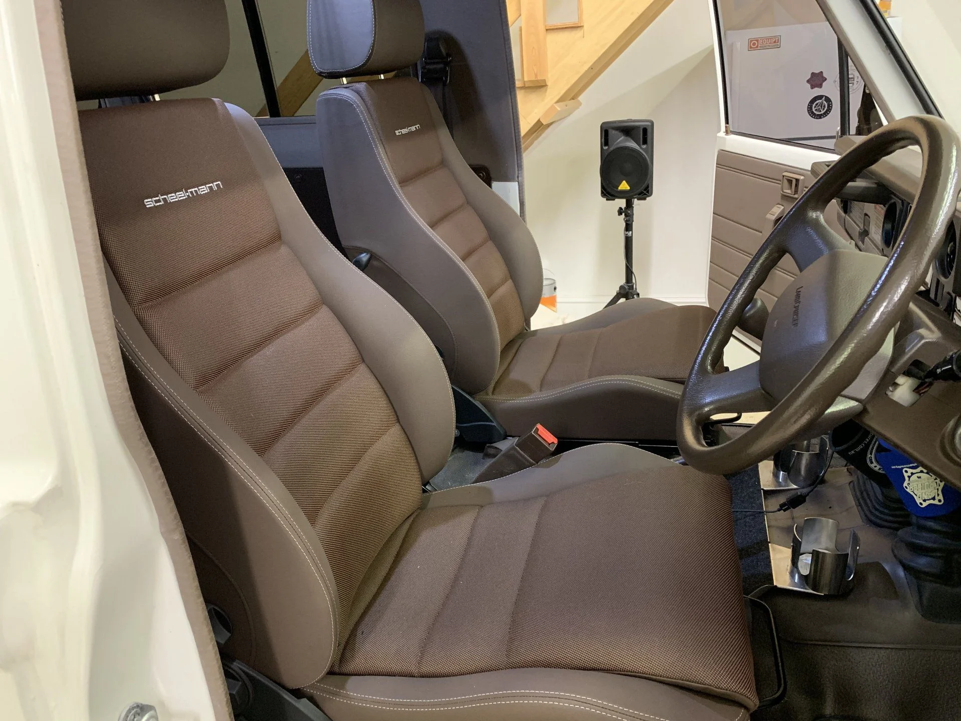

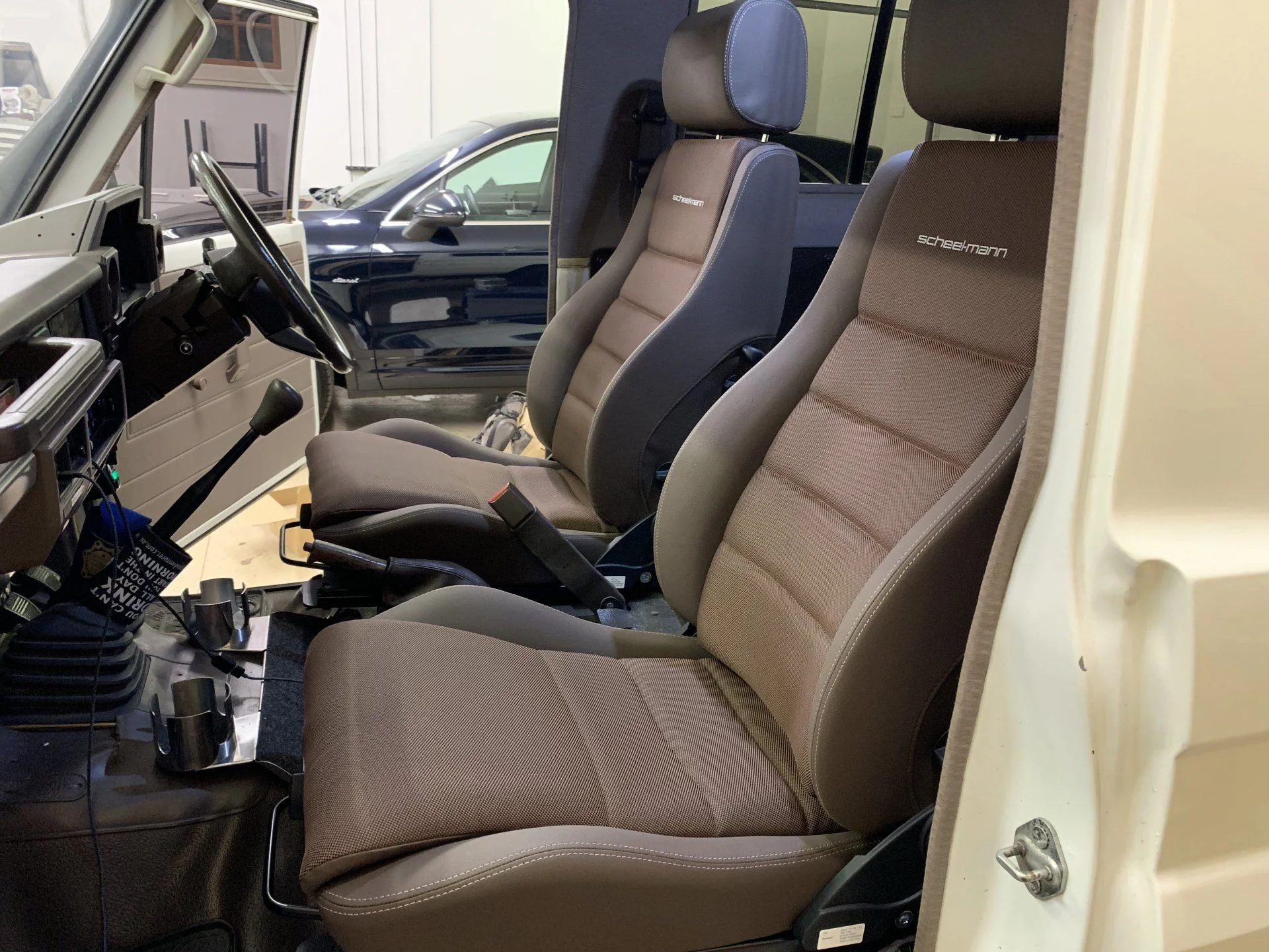

Here is my troopy with 79 series seats bolted to the 75 original rails.

Good luck with the seat swap....it's not easy as I recall. Lots of cutting and welding. Pay particular attention to where you mount the seats so you get full rearward movement on them to accommodate your comfort. I wish I would have added about an inch more travel to mine so I could be a little more comfortable.
