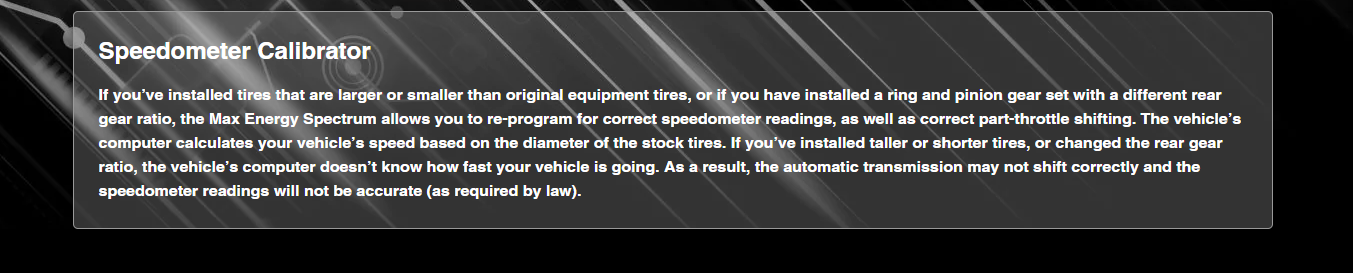

Now the question is, does it only fix the speed in the instrument cluster or does it actually correct it for the ECM/BCM/TCM.
On the website they cleverly stated the obvious that non-stock tires will through off the Transmission shifting but they technically only state it corrects the speedometer. "Part-throttle shifting" can mean that is changes the throttle response and not necessarily correct the speed signal in the computer.
To me if that's the case its not worth it, now if it also fixes the transmission shifting then I would be interested
I suspect not. It consists of a little module and a wiring harness that inserts the module into wiring behind the instrument cluster. I doubt the ECM collects any data through that particular wiring.

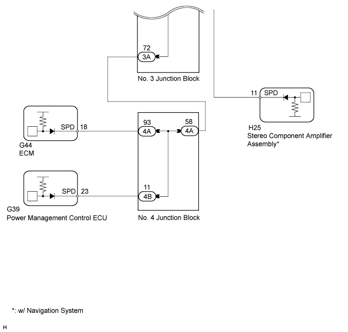

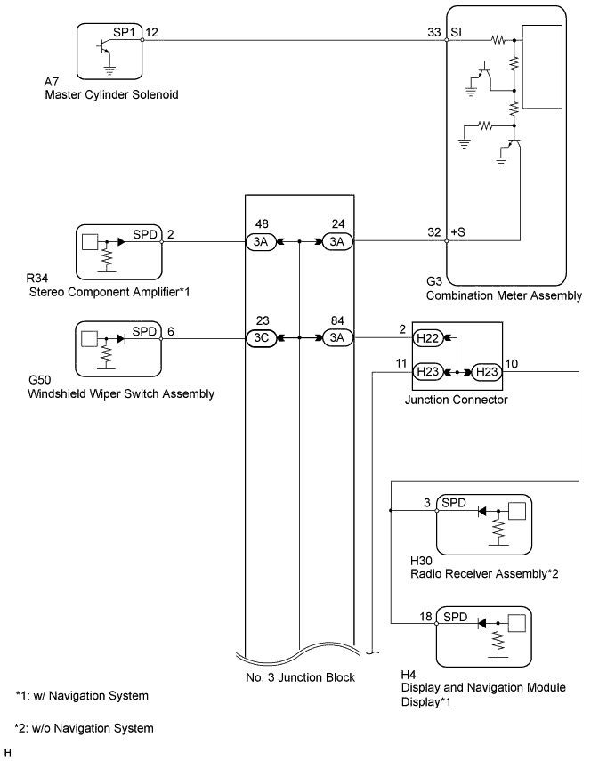

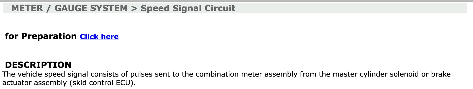

Does anybody know where the GX derives its speedo data from?
I got to thinking about this during the long drive to Utah, and it occurs to me that the speedo should actually be reading high with 4.88s and 35s, rather than low... that is IF the GX used an old school speedo drive from the transmission. Instead, the speedo is reading 10% low, which means the GX is getting speedo data from something like a wheel speed sensor.
Unsure where the GX gets its signal? That being said when I regeared I had to adjust my Scan Gauge a few %. The speedo still reads low. IDK why? 285/75/17 or 34"tires and 4:88 gears, it should be reading a bit fast?
It definitely *should* be reading fast. The fact that it isn't suggests a data source somewhere other than the drivetrain.
Thanks Acrad... and I assume the skid control ECU gets its information from the wheel speed sensors, as I thought. Interesting... not sure what I can do with that information with regard to speedometer correction, but good to know.
