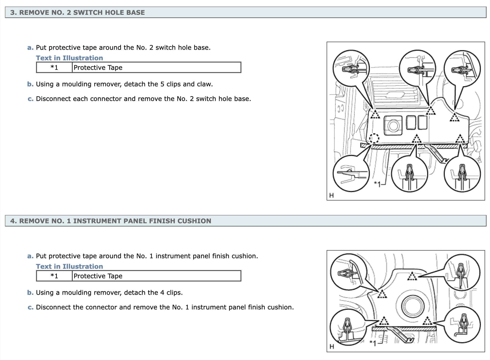

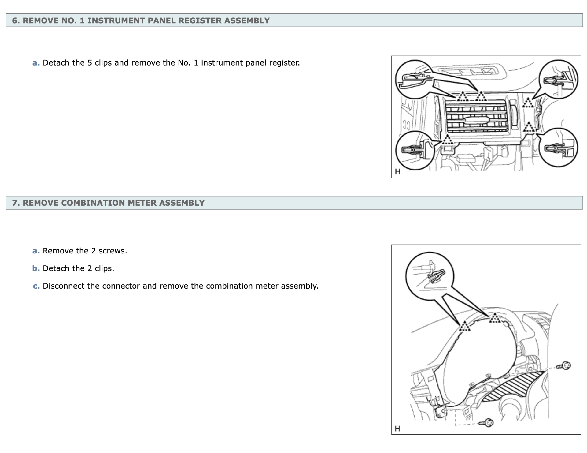

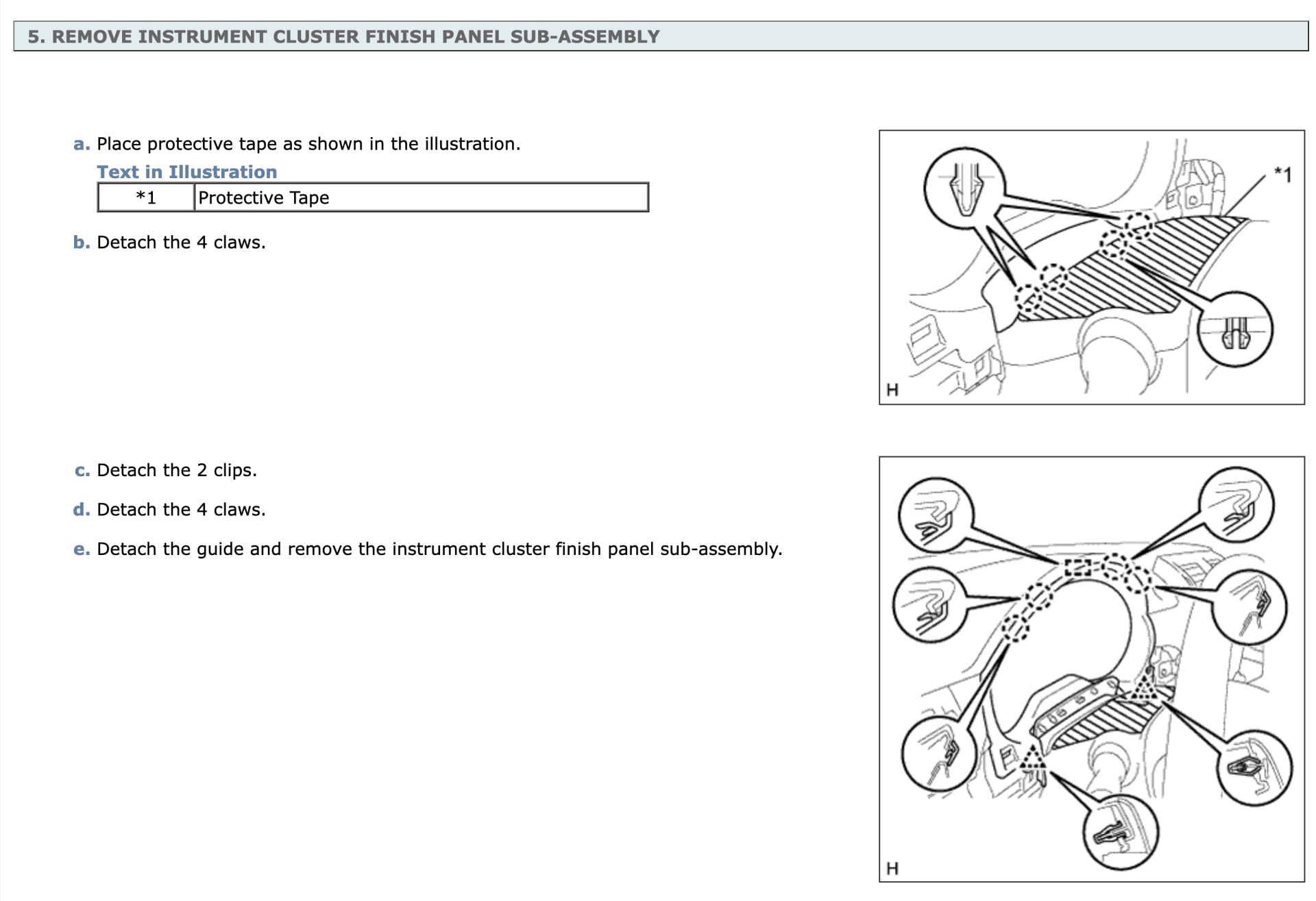

My understanding is you hook it up to your computer to update the software and configure the settings for speedo correction before install.
Looks like it installs inline with gauge cluster
Gauge cluster removal
Yeah it looks a little more involved than I was expecting... but I've had the dash apart before for MTS install, I guess I can do it again.
