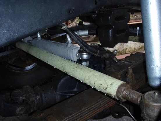

I copied woodys mounting setup for mine and it turned out mint 4x4labs arms
I had to de stroke the 8" ram one inch by adding a spacer right on the shaft but works awesome and will never get hit

How did you make/install that space on the ram? Maybe I will see it when my ram comes in on Friday.
I wouldnt trust any "clamp on" mount. Cmon whats the difference between loosening 4 ubolt nuts or ONE ram bolt and spin the rod without removing an end.:doh: I dont see any added conveinence, only potential for a broken off ram mount pokin the oil pan.:doh:

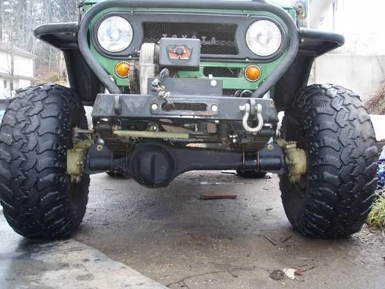

heres a TG assist ram installed under for oil pan clearance. It was used with an orbital for full hydro, but it still fits you needs too.
I put a skidder under it for super bashin.
The nice thing about a clamp mount is that you get a finer adjustment than only 1 turn increments and with bigger tires I saw smaller adjustments make a difference, at least that's been my experience. On a wheeler it's probably not a big deal but it helps on a DD when trying to get it to track just right. I would think the potential exists for a welded on mount to come off as well, just depends on how good the welds are or how good of hardware used on a clamp mount. I've never had any problem or even a movement with my revised clamp (the ubolt clamp mount was crap which is why I revised it and don't suggest using it) and I like how it spreads out the load. I do like your ram placement and the accessibility looks great. How does the TG ram (I've got the same one) do for full hydro?
I wouldn't build it any other way than with a clamp.
My clamp hasn't budged, and adjustment is easy.
